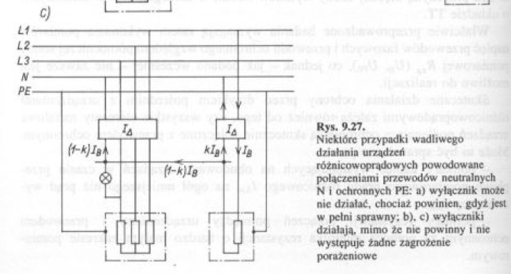

    I searched a lot of information on the Internet, including forum, I also asked a lot of people but I did not get a clear answer. If we have a single socket on one circuit, protected by a 30mA residual current circuit breaker and I short the N and PE wire together, will the switch switch off the contacts? There is no device connected to the outlet and we make a short circuit through a wire or a light bulb. We did such an experiment at work and the switch did not turn off, but apparently in many situations such a short circuit turned off the differential. After the N and PE conductors have the ground potential, where would the current flow in them after a short-circuit. And if there were two sockets (protected by a differential), one loaded and the other not, and in unloaded we would short PE with N, will the switch switch off? Perhaps the sensitivity of the switch is important here and one will turn off and the other will not?

    The circuit does not have to be loaded after the RCD, it is enough that there is a different load in a given "area", relatively close to the RCD, and then a short circuit N to PE will trip. After all, the N conductor is a work conductor and if there is a current, there is a voltage drop, if the voltage is sufficient to flow the RCD tripping current, it will release, if not, it will not.

    And I will join my colleague Pavulon, the loaded N may have a voltage in relation to PE that is so high that their short circuit after the differential will cause it to work through the equalizing current in the N path of the differential. It has happened to me several times.
    Of course, such a case is possible when the differential is powered by other circuits than the one on which we are experimenting.

    Now I will add something from myself. The differential does not need to be biased to work. In the case of an N-PE short-circuit, a current flow through the N line may also occur behind an unloaded differential. Why ? because N may be at a potential other than PE because there are voltage drops across it. Of course, it also depends on where the point of division into PE and N is

    Colleague greg 16 is right as long as we are talking about a TNC-S network. There is no dividing point in TNS networks (and these are mainly built now) ...
    The socket in question is powered from the 1st phase, and this circuit is supplied from the 3-phase circuit, i.e. both have a common N conductor. is equal to 0 V, but has a certain potential (i.e. the N conductor is connected to a certain potential). If we close N and PE (with a potential equal to 0), we close the circuit and the flow of current (and only 30mA is enough to operate). If we had a symmetrically loaded (and this is almost never the case) 3-phase network, the differential would not work.

    Of course I know :) I'm not saying that this will always happen, but it can. Many factors will influence it. One of them is the fact that the loaded N conductor may have a higher potential than the PE conductor because there is a voltage drop on it, but it is and it is enough for 30mA to flow. If someone does not believe it does not have to. And who has any knowledge of electrical engineering should know.
