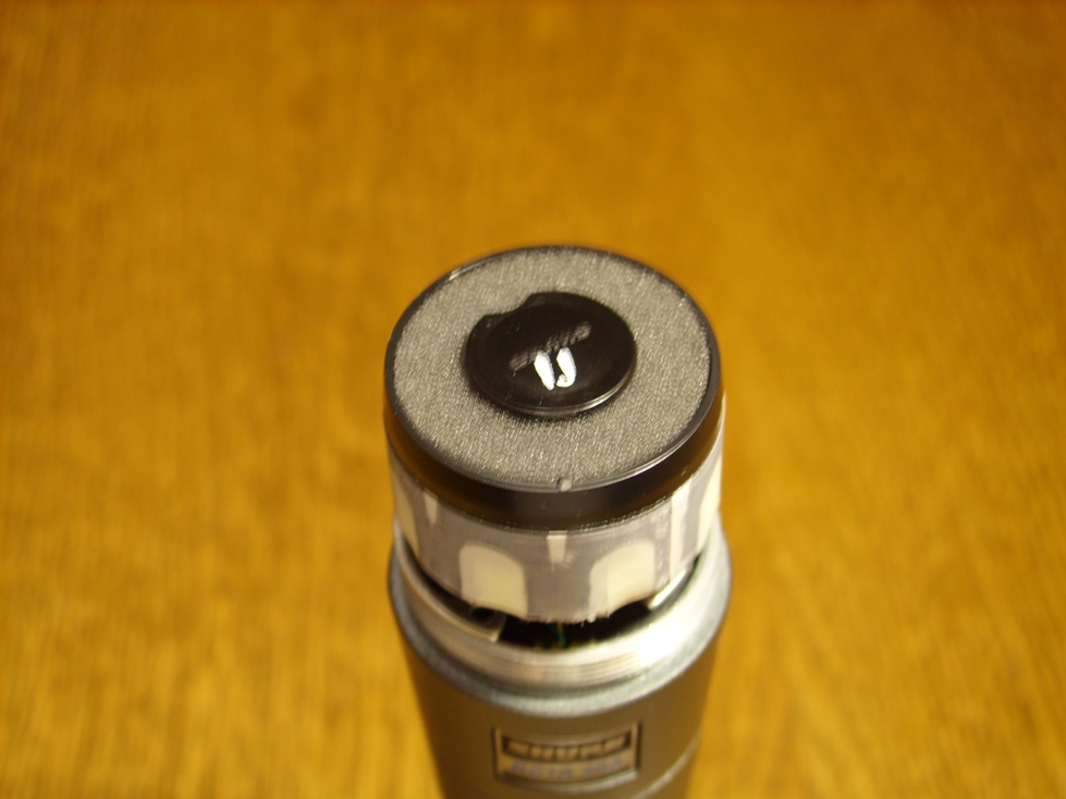

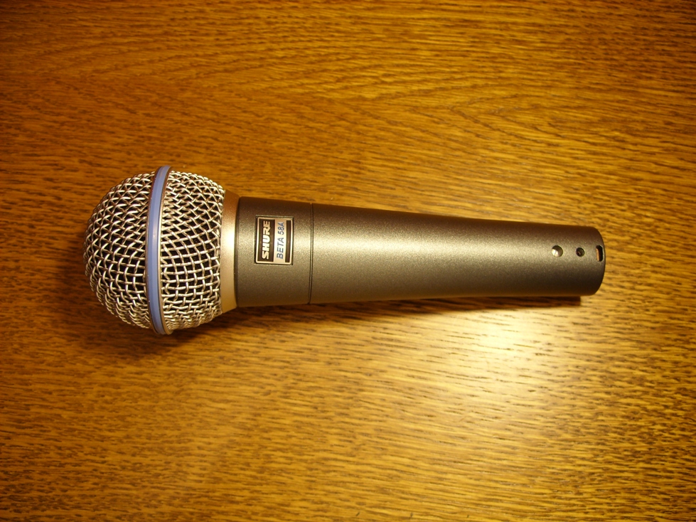

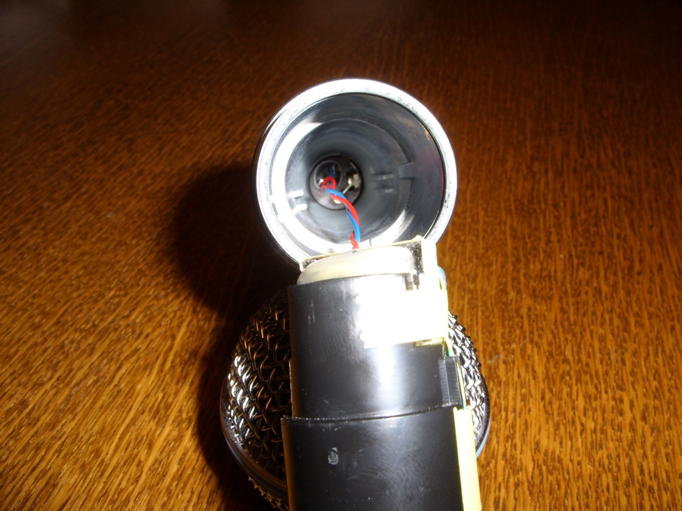

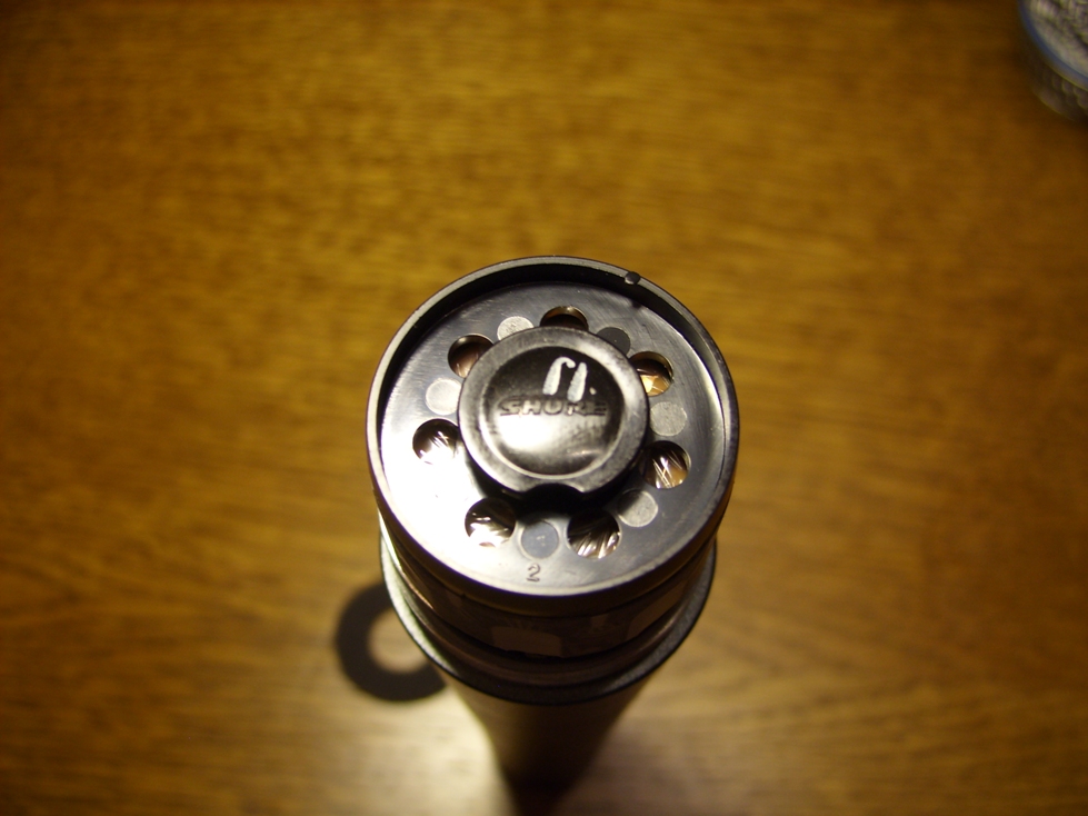

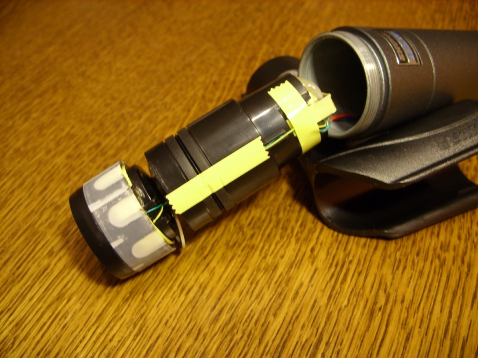

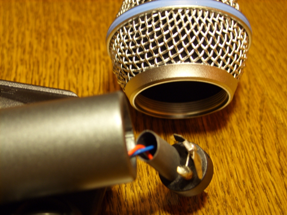

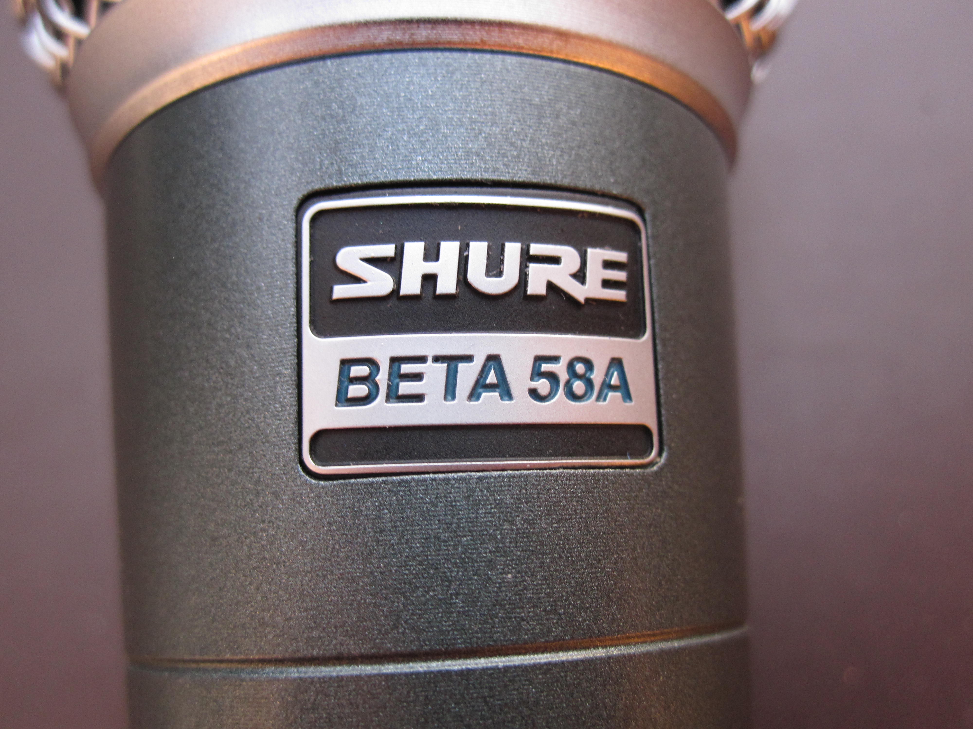

    Hello!
    Due to the fact that the bet is on the forum a little I allow myself to add a few photos of the original.It certainly will be useful for comparisons.From what I noticed externally on my microphone on the embossed plate with the Shure logo, black rectangular strips have sharp edges and on others you can see it rounded. Please do not try to imply that if it is a badge and not a sticker is the original. As for the letters, it also slightly differ. As for the box and papers, please do not be discouraged that there is a lot of written in the language Far East because the manual is in many languages, and we have bad associations at the sight of dashes and houses. I have assembled by Shure in Mexico. The most important thing is what is inside. Please take care when removing the insert, I advise you not to no pliers for internal security. I made the purchase in the oldest music store in Poland, those who are interested will surely associate it. I have pictures for Polsound and photos that it's 99% original, because they did not have it in their hands and they do not confirm it 100%. In tests, it's great, it does not clash so easily, it's ok.

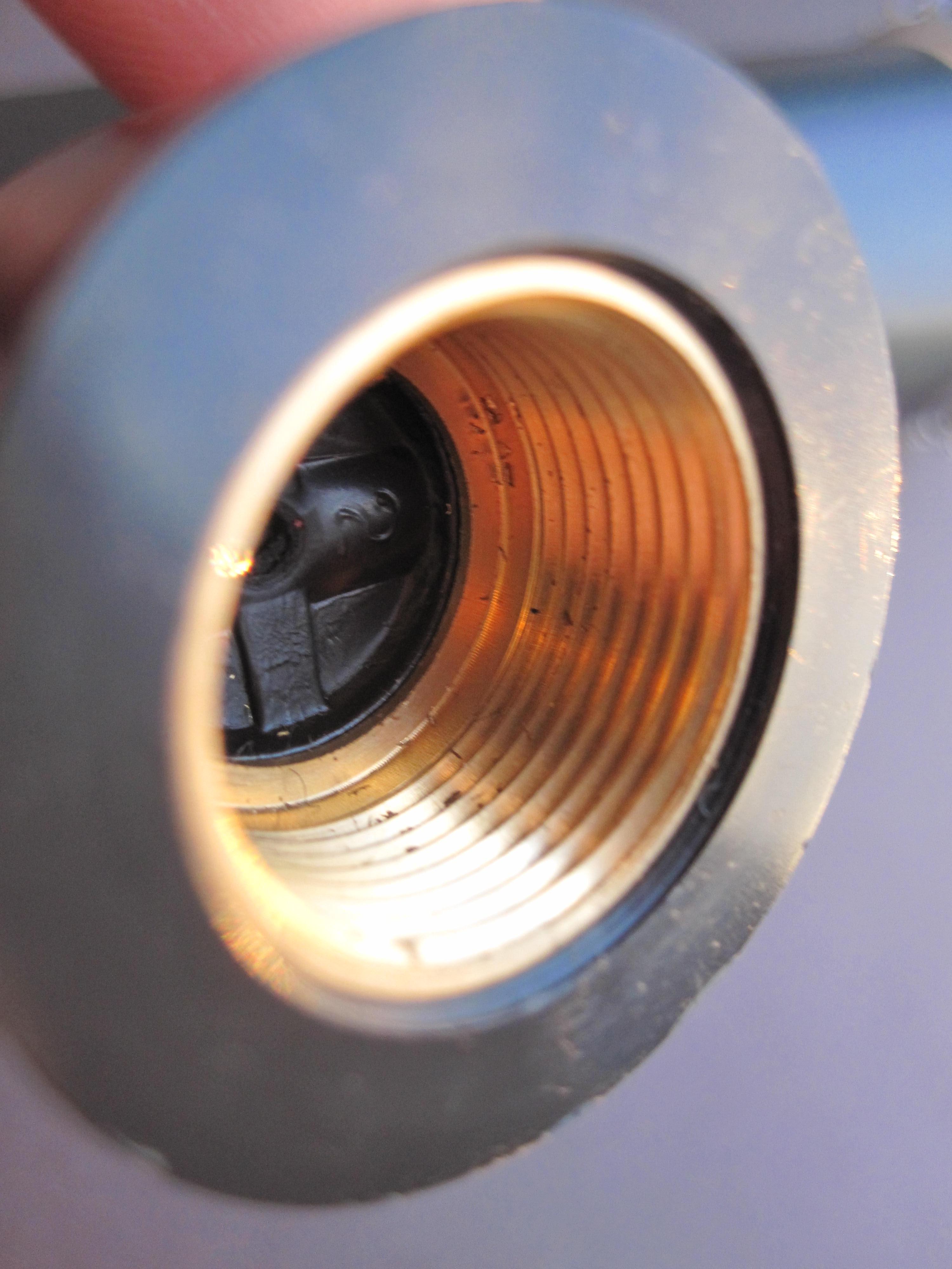

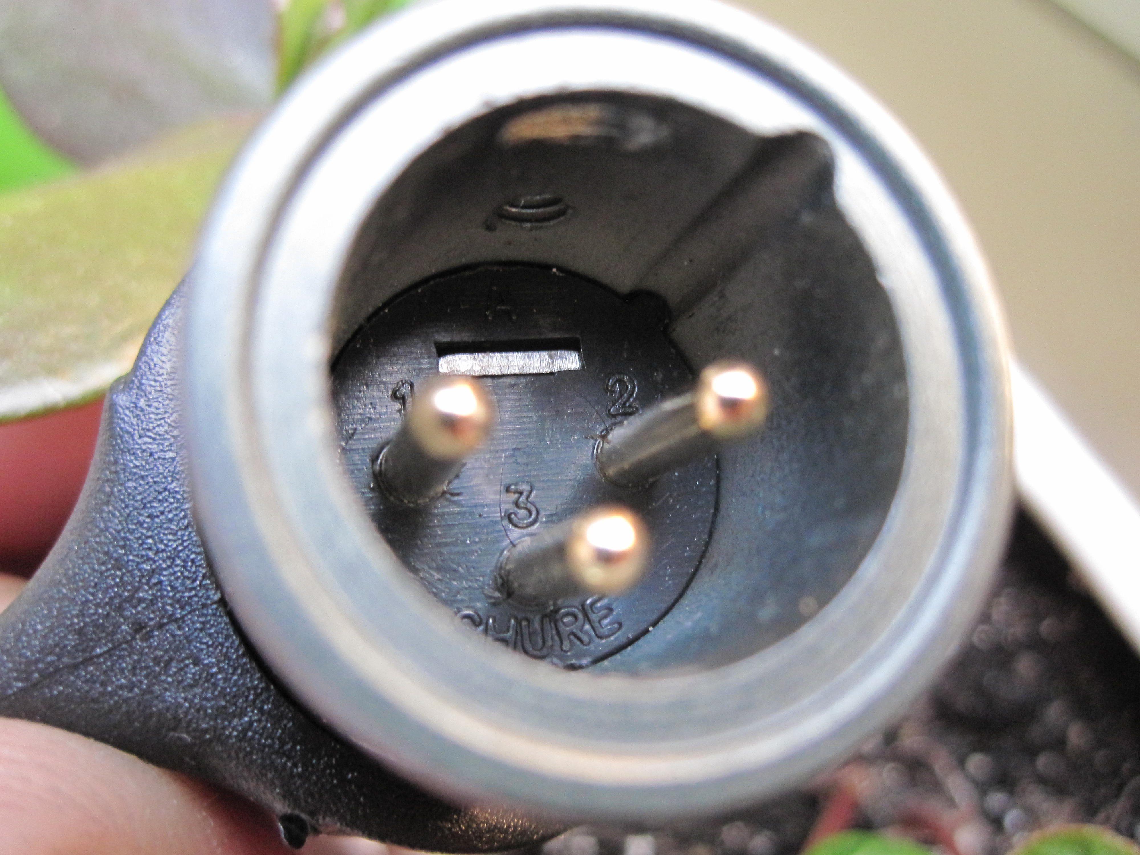

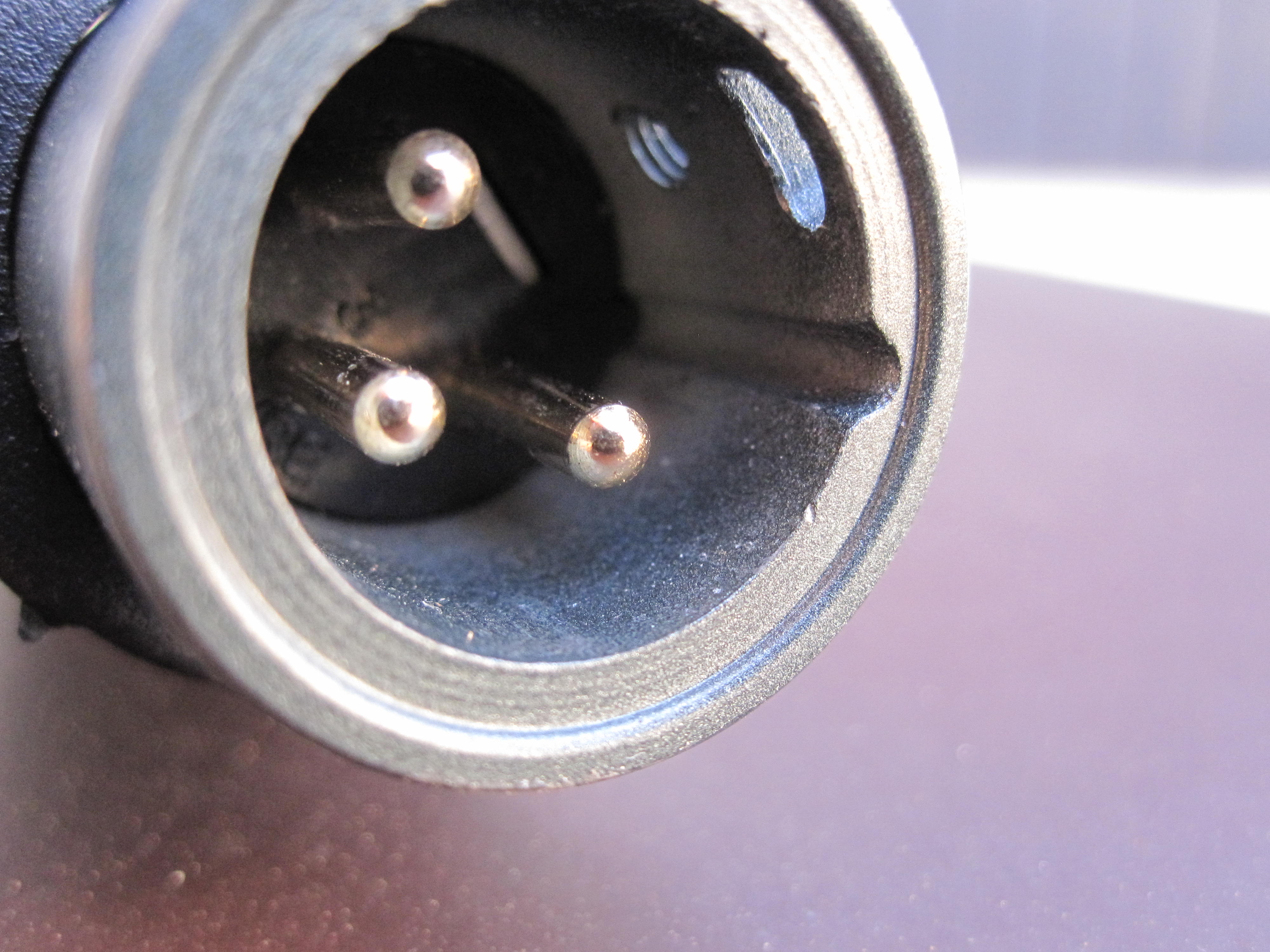

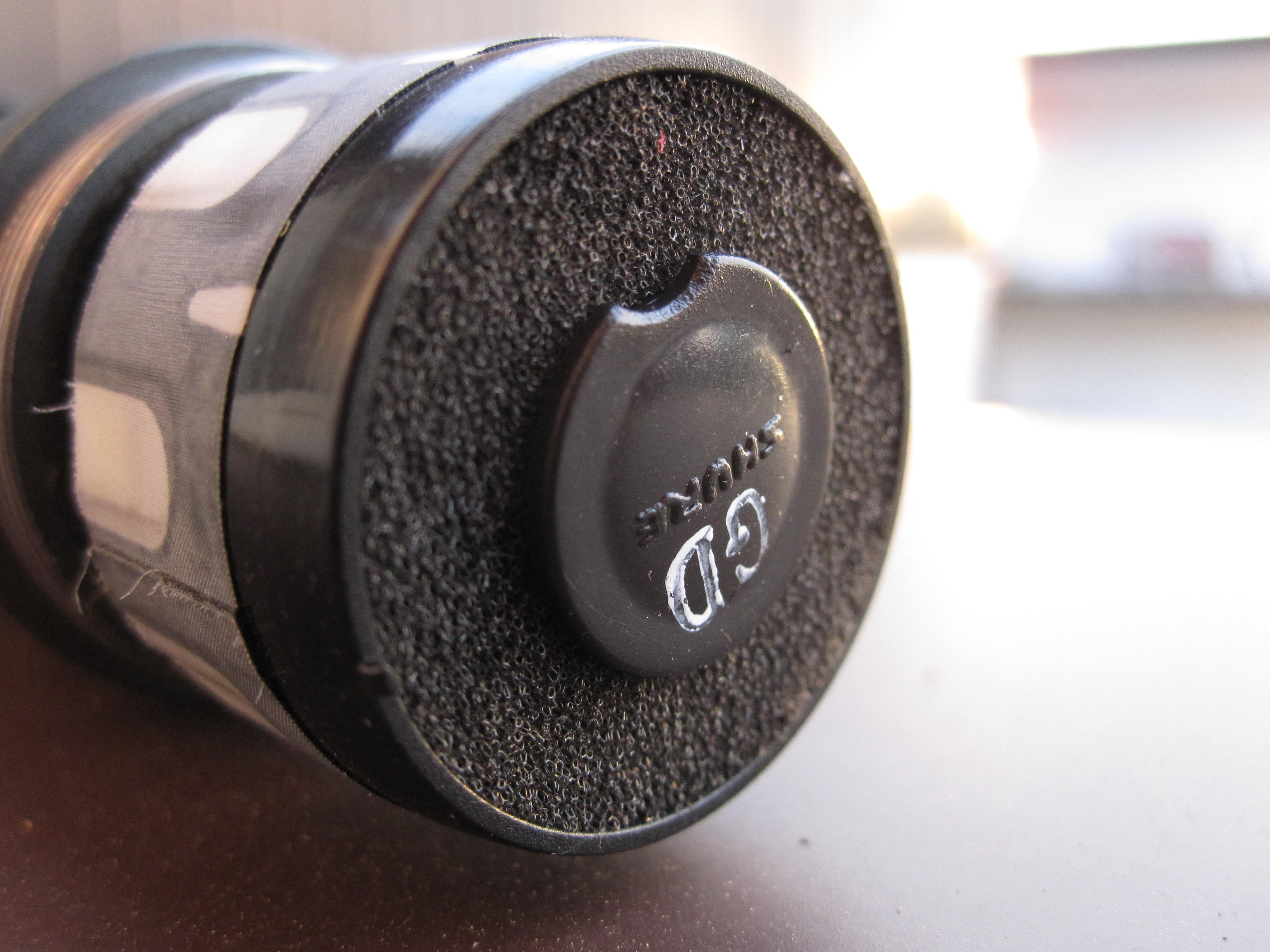

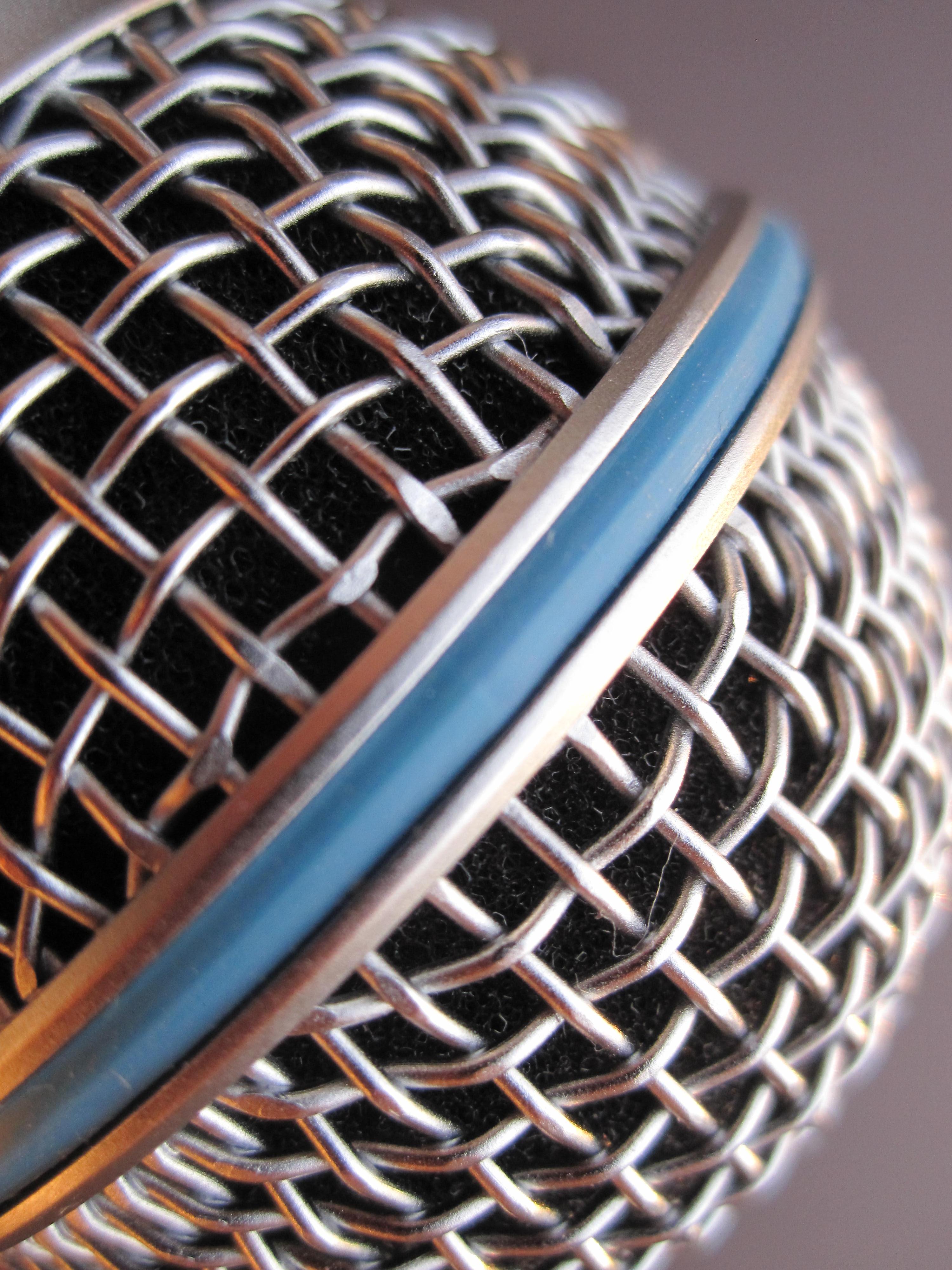

    What do you think about this microphone? The original or the new evolution of counterfeits?
    With him in his hand, nothing can be accused of anything, solid work - but I do not know what to think about him?
    In the box, everything you need, slip, case ..... but it can be printed today.
    Has anyone like it ???

    halbatros, reminiscent of the original, with the fact that the original is not turned, and this is seen as if the body and pan on the sieve were turned. Like a socket, it looks a little sino.

    Macro pictures, you can not see these lines with the naked eye, it is simply smooth.
    Normally you can see it as on thumbnails ..

    I can attach to cables, they are thinner in mine and go straight down, do not twist. Try, remove the ring and remove the insert, whether it is good, or from the side of the plug. Although this plug does not look like the original, how old is the microphone? Because now there is a sign on the plug not to throw in the trash.

    The author of the topic - of course the original.
    The last super large photos - fake, albeit good. What distinguishes it from the original:
    a ring on the grill ring (right under the grid) - the original has a straight line
    different handle color and blue rubber
    thicker cables (the original is thin)
    less accurate lettering and rounded edges
    and of course the price ... allegro novelties go for about PLN 369 .....

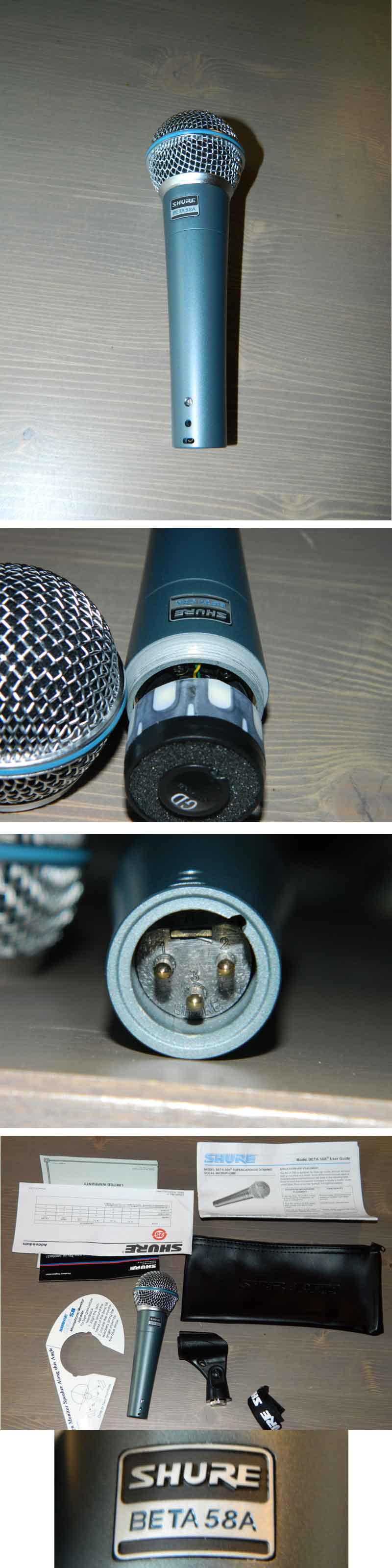

    And what do you think about this copy? The top looks ok, but I do not like pressing on the bottom ...

    Fake ...
