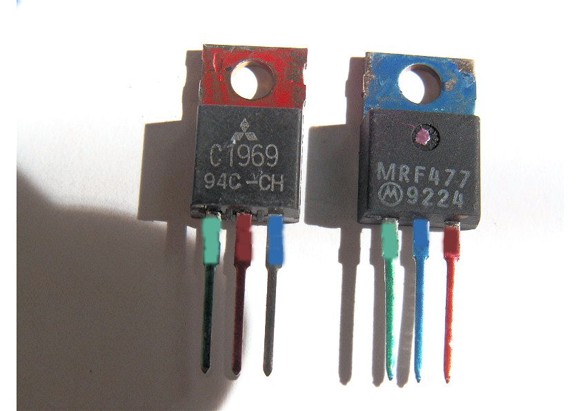

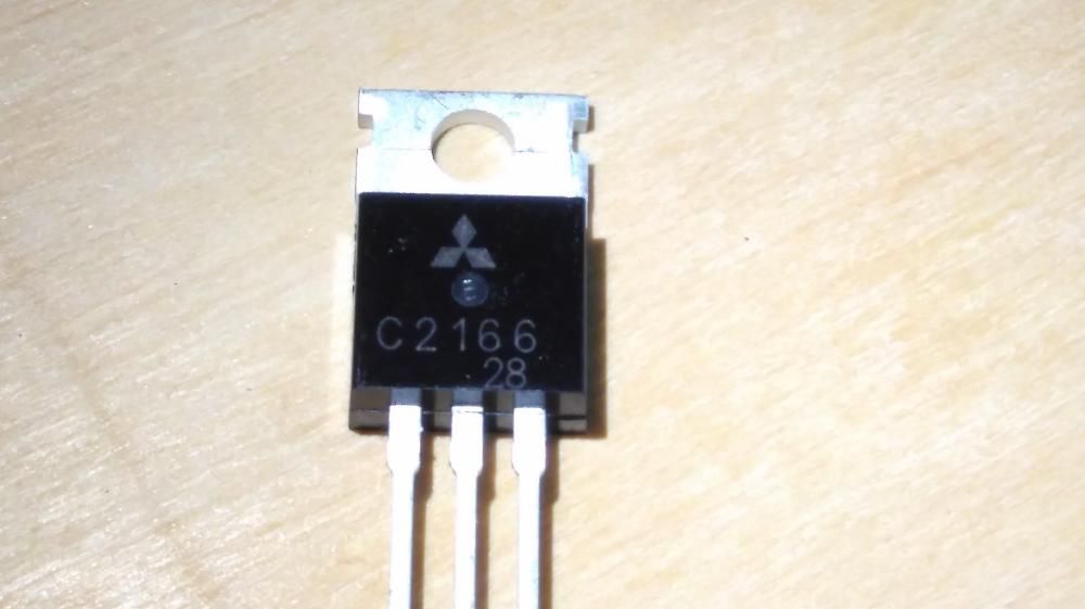

How can I tell whether CB radio RF transistors sold as 2SC1969, 2SC2166, MRF477, RD15HVF1, and similar parts are genuine or counterfeit?
The thread’s conclusion is that the transistors in question are not original, i.e. they are fakes or “coloring books,” so the seller’s 2SC1969/2SC2166/MRF477-style parts should not be treated as genuine originals [#16552946] “Original” was argued to mean the exact part from the named manufacturer; a substitute with similar parameters is still not original [#16548234] One reply noted that Eleflow produces 2SC1969 and 2SC2312 and that they work as needed, but you still need to verify what they look like [#16463863] The discussion also warned that simple multitester gain readings are not a reliable way to judge authenticity, and that power claims can be overstated [#16549246][#16548630] In short: compare package markings and construction against known originals, and be skeptical of “new old stock” claims when the parts are no longer commonly available [#16552946]

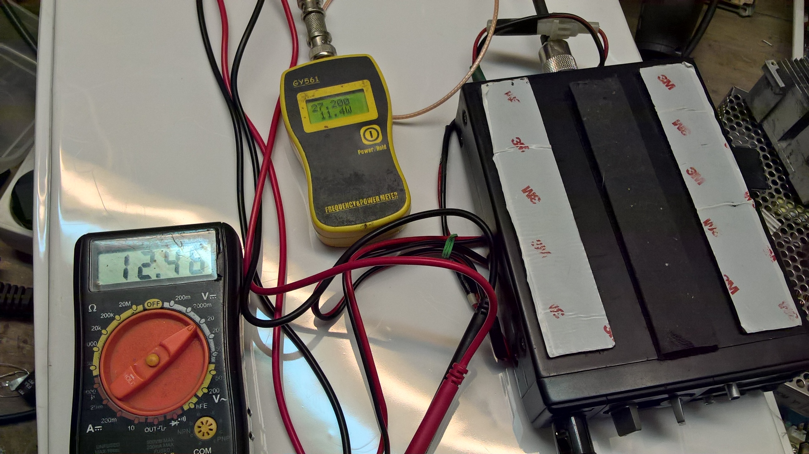

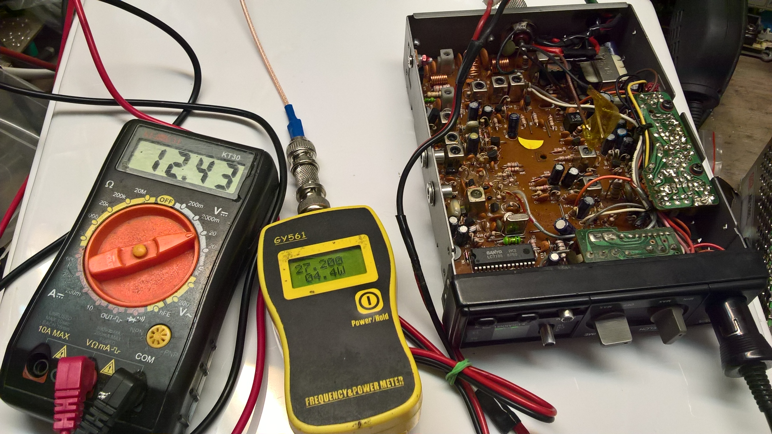

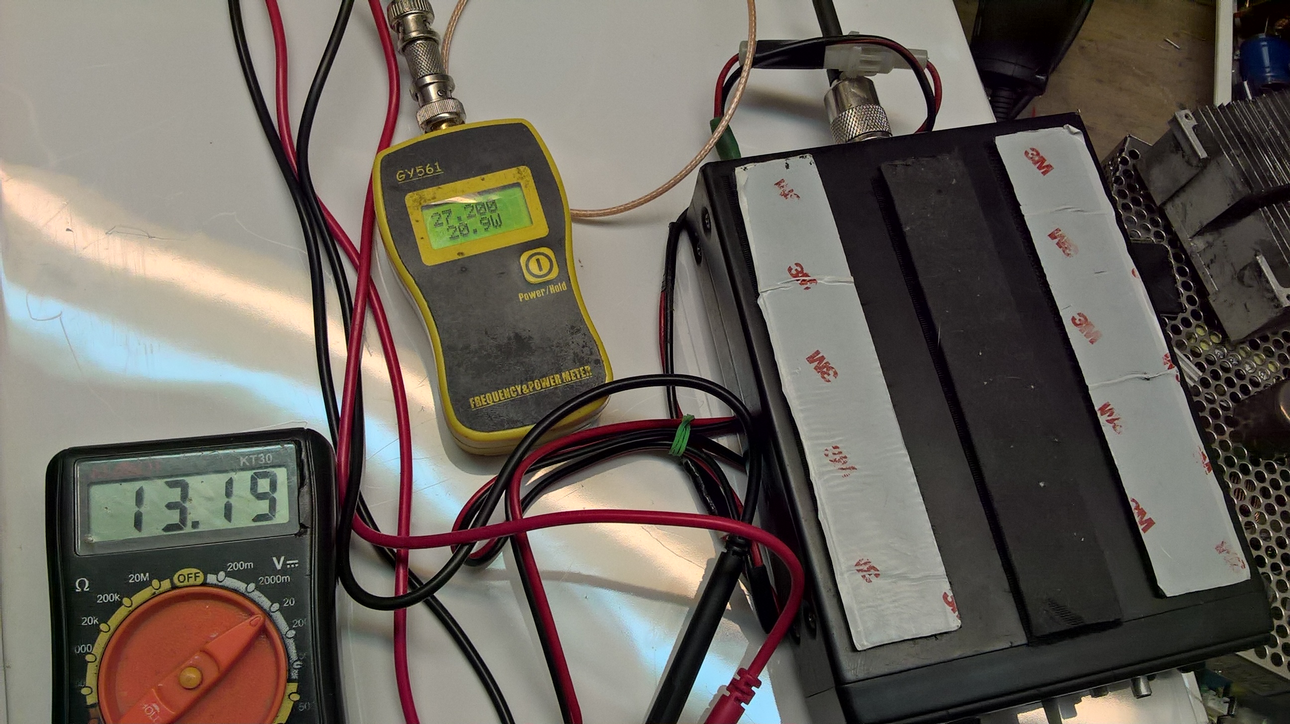

    Mr. Novile, I think I will do a demonstration lesson what 2075 can do because 5W strives for it, maybe the transistors inserted by him seem so much, or maybe it was about a specific uniden radio because it probably has so much in the standard. I did not do the exact tests easy and the modification of the radio consisted in changing to other values 1 or 2 resistors and capacitors, and probably 1 diode. Gentlemen, I also have 1/4 painted basket 2078 and mrf477. If I have the will and free time, I will take a photo or make a video of the action, e.g. 2075
    Here are some photos taken by a certain gentleman on request after modification and before the Onwa mk3 radio. Well, but here you can not see any specific power level, etc., etc., but only as an illustration. Regards and not nervous, gentlemen.
    before modification:
     Identifying Counterfeit RF Transistors in CB Radios: 2SC1969, 2SC2166, MRF477, & More
    after :
    after modulation:
    Sorry for the spelling and for offending someone

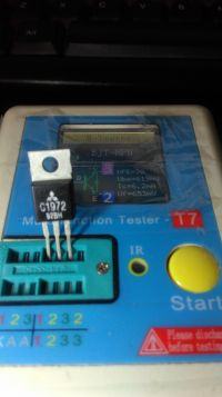

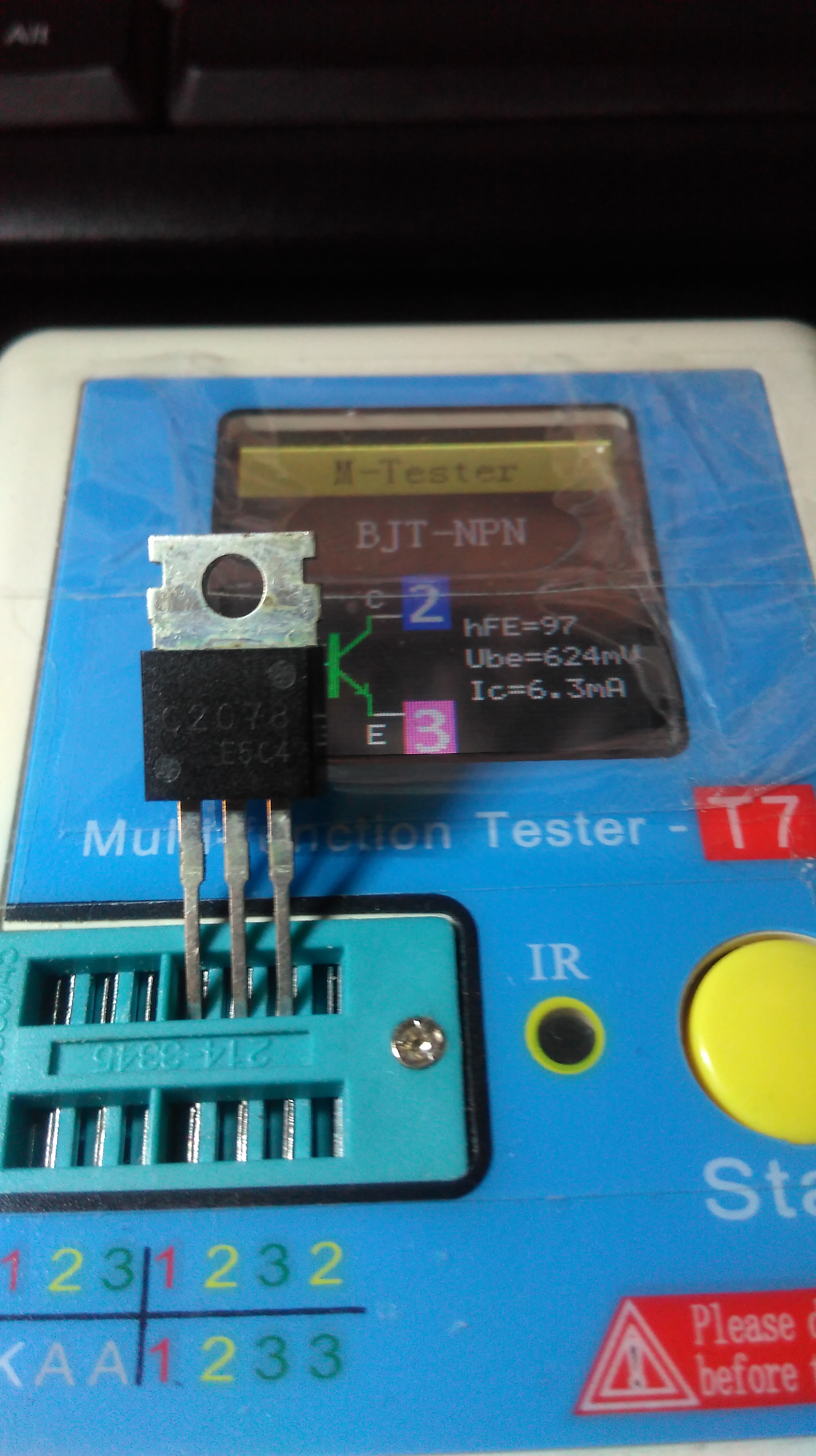

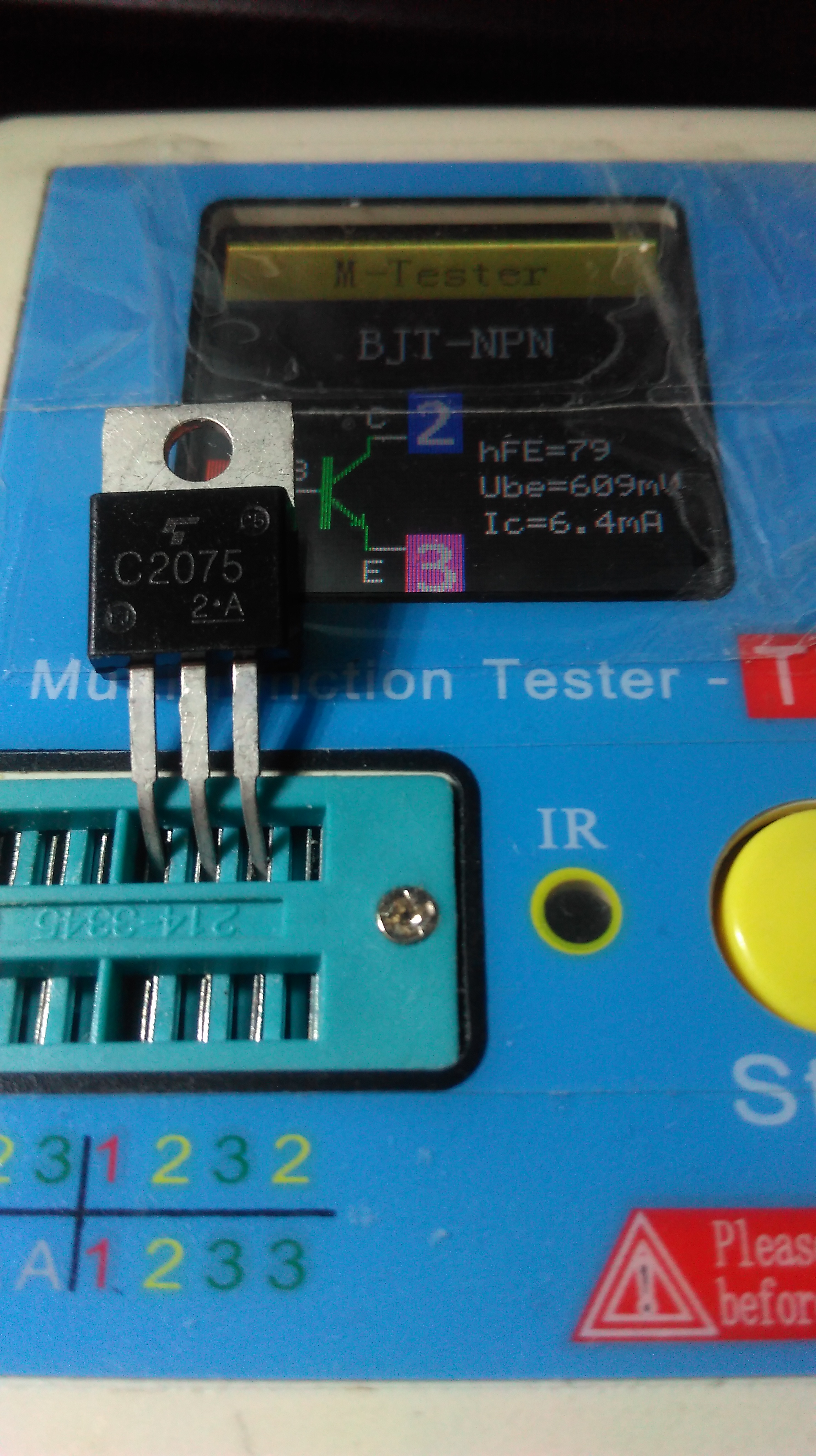

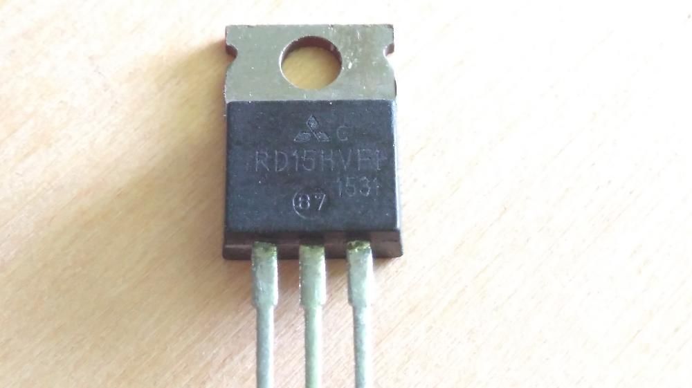

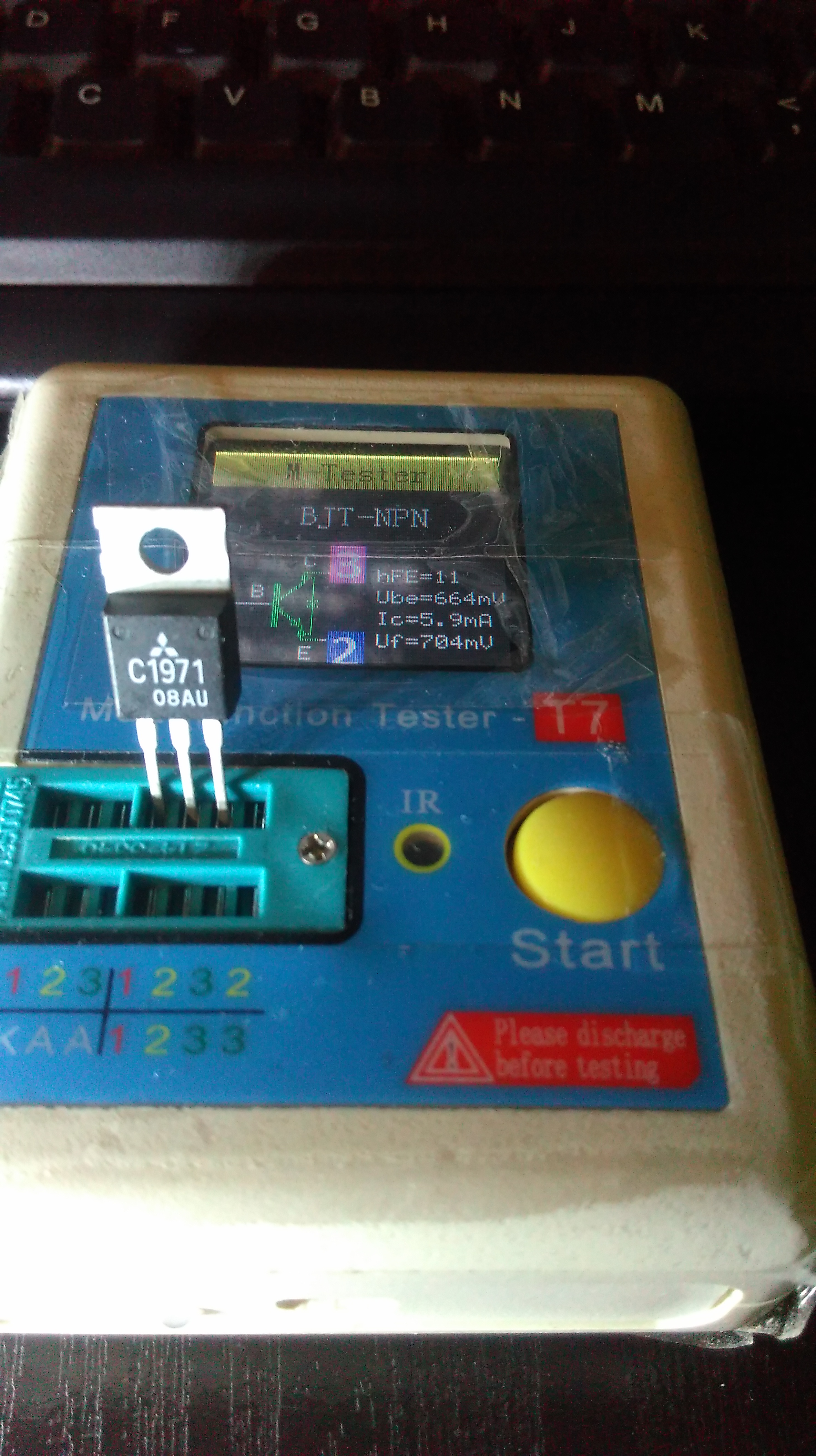

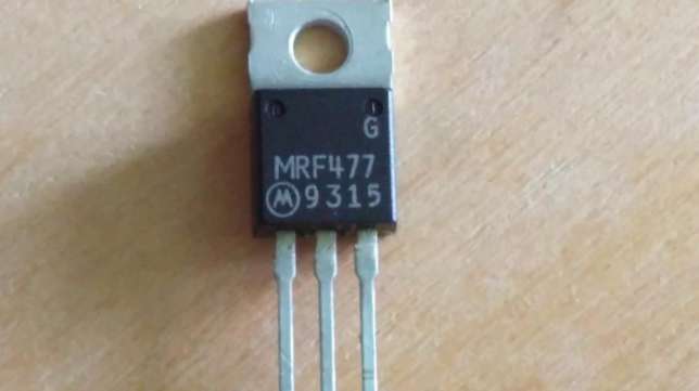

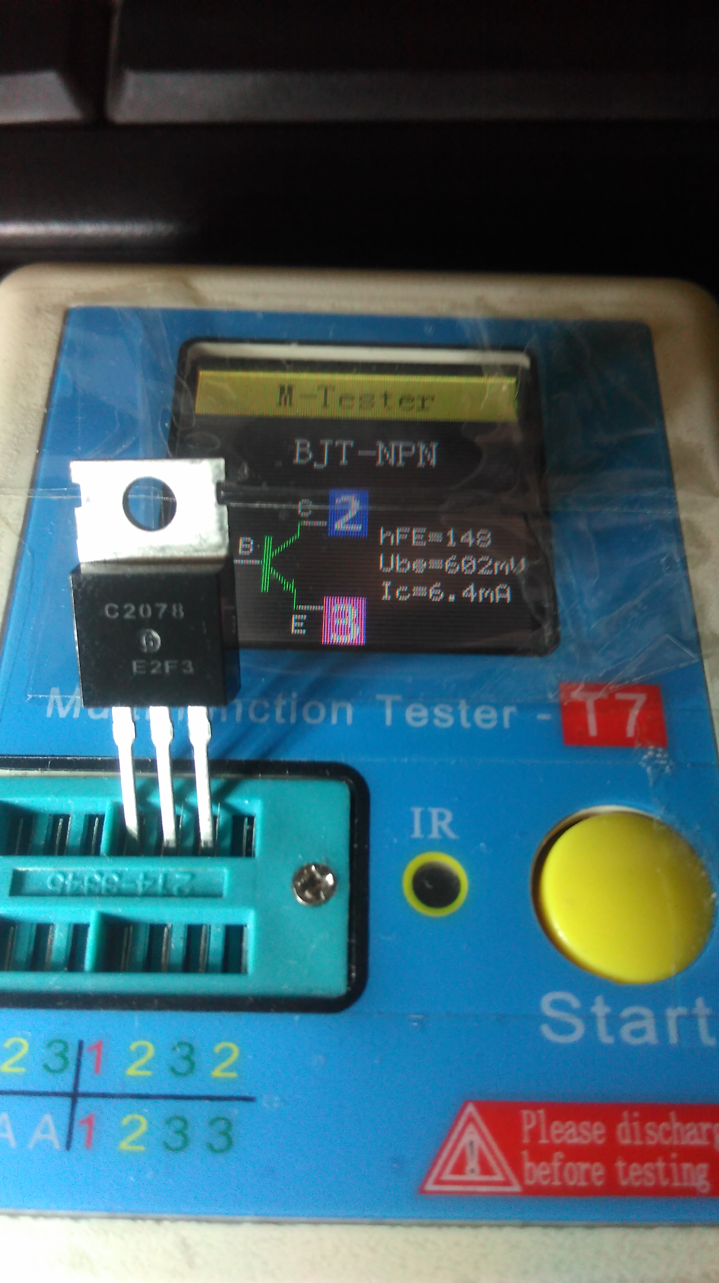

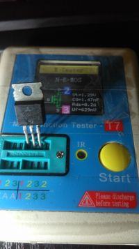

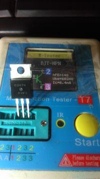

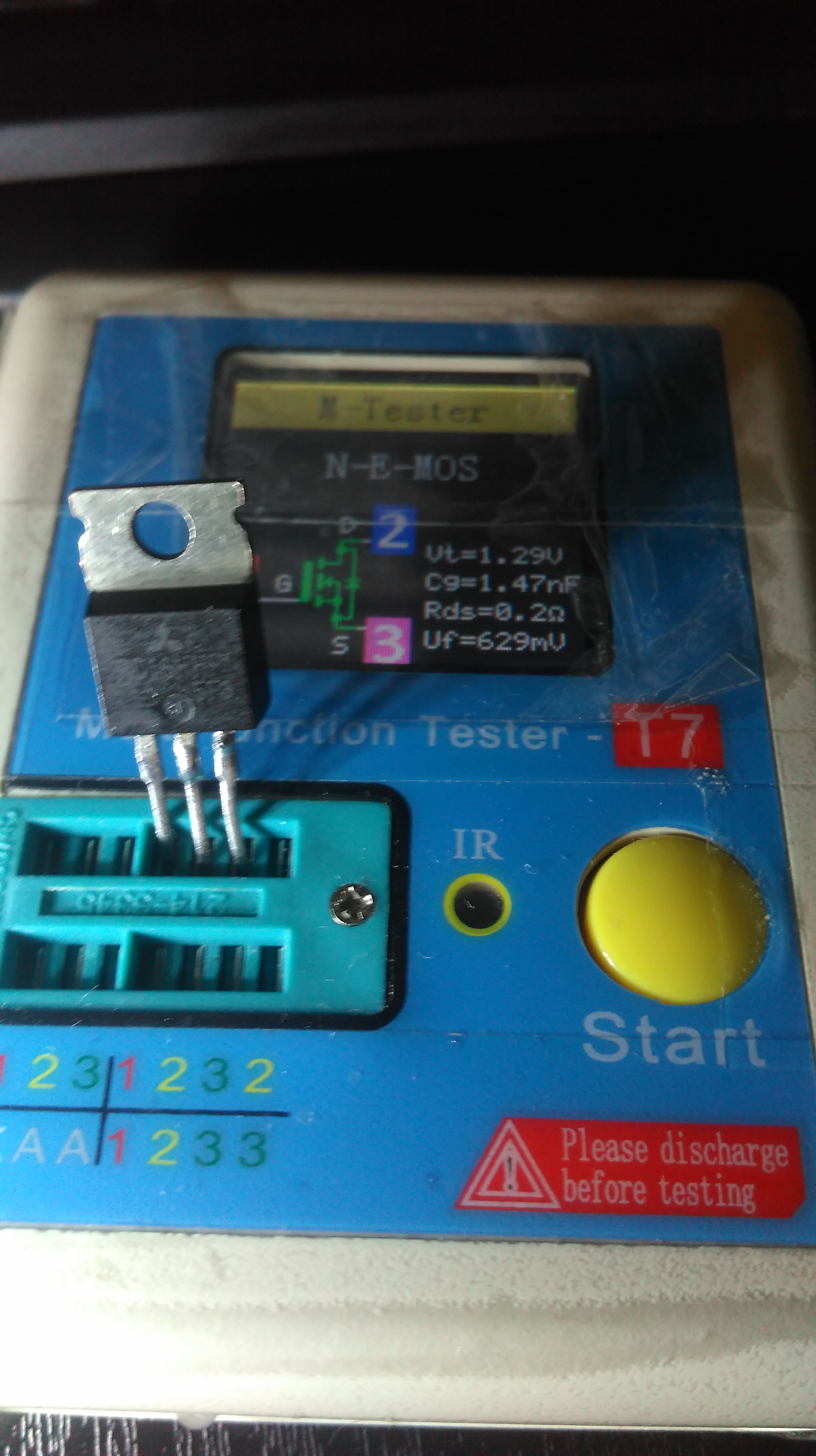

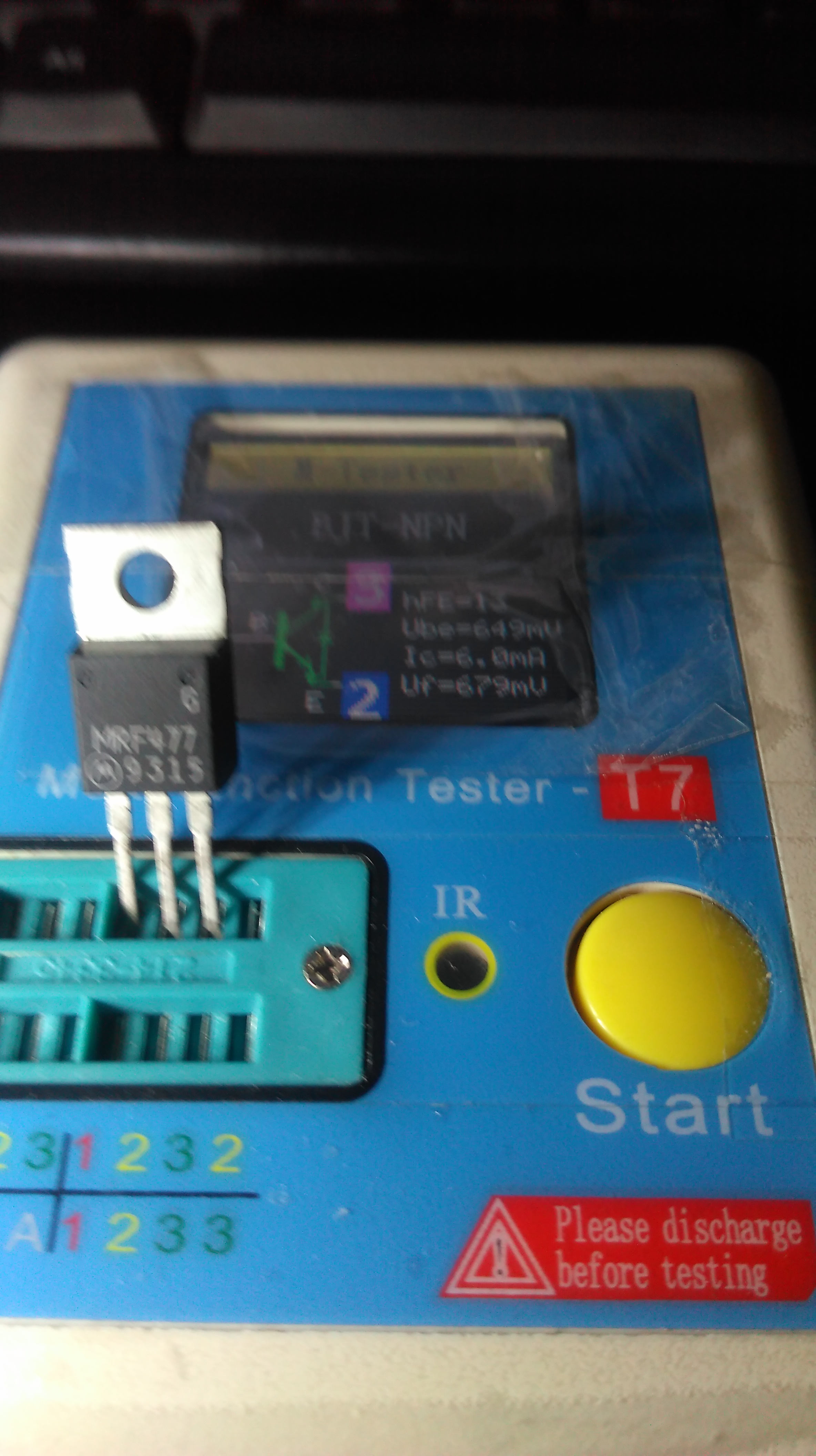

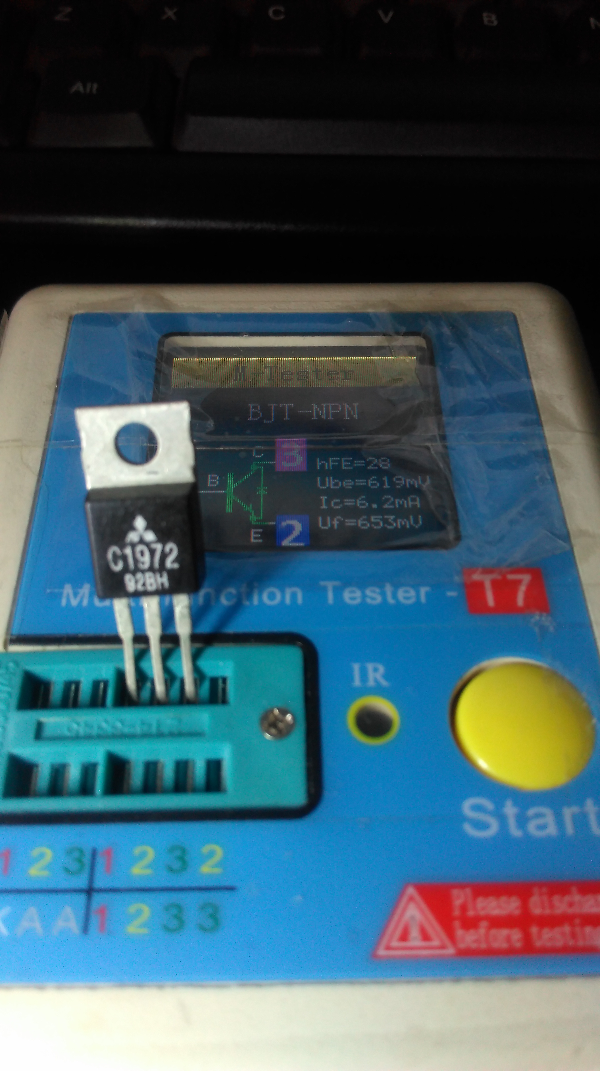

    Well, this is all bad for you, the 50% meter cheats and the calculations are done now you need to shoot a movie to prove something, the first photo I had at hand is not enough, I know that he would like it, a simple solution 2 resistors and capacitors (not a jumper) diode change on a quick schottky it is such a quick modification, the analog meter (pointer) also showed this, because the digital meter at W.cz goes crazy sometimes.
    and a few more photos of transistors and parameters, I hope you can see what you need to prove in a simple way:
    Hfe 79 on others from the same package similarly 78-81
    SANYO
    May this measure also not show only 50%. Regards Rafał

    I must add from myself that measuring the gain of these transistors with such a multitester does not make sense. In addition, 9W carrier - about 16W with modulation, so it turns out that the modulation depth after such a treatment is not even 50%. So very shallow. Sometimes about 6W of the carrier can be squeezed out of a classic cymbalrad, but it also makes no sense. Then 20W in PEP is obtainable. But the most important thing is to give these 4W at 27MHz.

    Dear colleagues. Enough of these scuffles. I can see that no one will convince anyone.
    Time to sum up the discussion:
    The transistors mentioned by the author of the topic are not original, so they are fakes or, if you prefer, coloring books.
