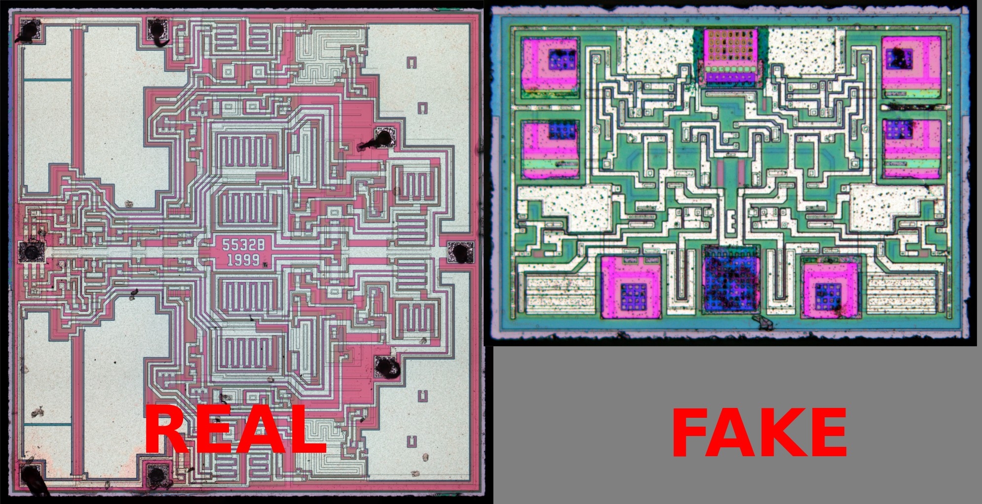

NE5532 this is what the original looks like and the counterfeit inside. We warn
gulson 26415 27
  • Comparing an original Texas Instruments NE5532 op-amp with a counterfeit bought on eBay, plus a Philips NE5532A die as a reference.
  • The chips were decapped with acid and their internal matrices and bond connections were inspected side by side.
  • The fake came from an eBay lot of 100 pieces for PLN 20 and showed a rise rate of about 1.25V/µS instead of 9V/µS.
  • The counterfeit has a smaller die and missing connections, suggesting only the minimum circuitry needed for basic op-amp operation.
  • NE5532 this is what the original looks like and the counterfeit inside. We warn
    The NE5532 is a popular operational amplifier used, among others, in audio systems, as a preamplifier, mixer or generator. This popular chip is often counterfeited, which can make a big difference in signal processing in your audio equipment. In particular, if someone is an audiophile and uses special gold plugs or a power cable for several thousand zlotys. As you can see, the only thing that can be recommended is that the preamplifier uses a counterfeit of the popular operational amplifier ;)
    Jokes aside, the problem of counterfeit electronic components is huge. In our forum, we run a topic called fakes , which has now grown to 41 pages.
    The blog team zeptobars.com dealing as a hobby with opening and, more precisely, dissolving the casings of integrated circuits with acid, opened the original NE5532 chip by Texas Instruments and bought a counterfeit from the famous eBay offer of 100 pieces for PLN 20. The effect is terrifying, the counterfeit not only has a smaller matrix, but also lacks many connections, you can say that only the basic things have been kept so that the system can work as an operational amplifier. On the forums, they noticed that the system is definitely much slower, the rate of rise is ~1.25V/µS, instead of 9V/µS.
    Interestingly, they also opened the Philips NE5532A production system and the matrix was very similar to the original, it can be said that the parameters in this case will be preserved.
    More information and full resolution photos can be viewed at:
    https://zeptobars.com/en/read/Ti-NE5532-real-vs-fake-opamp
    We warn against counterfeits.
    The blog team zeptobars.com dealing as a hobby with opening and, more precisely, dissolving the casings of integrated circuits with acid, opened the original NE5532 chip by Texas Instruments and bought a counterfeit from the famous eBay offer of 100 pieces for PLN 20. The effect is terrifying, the counterfeit not only has a smaller matrix, but also lacks many connections, you can say that only the basic things have been kept so that the system can work as an operational amplifier. On the forums, they noticed that the system is definitely much slower, the rate of rise is ~1.25V/µS, instead of 9V/µS. .
    Why a fake now?
    After all, so many famous companies boast that they are making newer and newer systems in the technology of smaller and smaller nanometers, and that they are supposedly much better and you should throw away the old ones and buy new ones - the supposedly better ones. And in fact, companies strive for lower and lower costs to make as many circuits from one monolith, and the thinner the paths, and in technology, more and more layers, the greater the losses and heating of the circuits, the greater the failure rate over time and the greater sales.
    But customers are being pushed into a different kit...
    This technological advancement is also visible in these photos.
    Like the original - but made in old-fashioned and single-layer technology. [old version datasheet]
    And this fake is already a hit made in a newer technology - according to famous concerns it would be advertised as better - it is clearly visible that it is a technology of at least three layers of connections and there are modern transistors.
    I suspect that the parameters of the newer one would be much better on the test bench, but it's like with tubes, that audiophiles say they sound better, and for electronics it's a misunderstanding, because even modern dachshunds don't have such distortion and uniqueness of parameters.
    And finally, see how many manufacturers of this historic system there are
    http://www.alldatasheet.com/view.jsp?Searchword=Ne5532 - at the bottom of the page.
    How they have slightly different parameters, as well as the scheme, and notice the red writing
    (it's a pity that you can't use colors on the electrode)
    Texas Instruments, when developing the system, had a problem with thermal parameters floating, so they used zeners5V made from the emitter/base junction of the transistor to polarize the operating points of the system, which resulted in soft clipping of the peaks with a stronger input signal, with modern transistors it is unnecessary, because the temperature hardly affects the operation of the system, so that the signal that enters comes out after amplification no shape change.
    How different are the input control currents and the input resistance - and if there is an RC filter at the input, a thoughtless (idiotic) substitution of the system also changes the characteristics of this filter. And instead of telling audiophile nonsense, just look at the documentation of the circuit and replace the resistor in the input polarity.
    Can we talk about fakes then?
    Or rather, some users are fakes who can't read the documentation.
    :?: :D
    And what the hell to open, digest in acid, etc ... It is enough to be able to read the documentation, and not to sow unnecessary ferment.

  • TI NE5532 die size supports short-circuit current
    #13 16760342
    Jaro
    Posts: 981
    Help: 50
    Rate: 52
    Or rather, some users are fakes who can't read the documentation.[/b] :?: :D
    And what the hell to open, digest in acid, etc ... It is enough to be able to read the documentation, and not to sow unnecessary ferment. [/quote]
    As they say, "paper will accept anything". Measurements of actual parameters may differ significantly from those declared in the documentation. BTW, in even the cheapest devices from China, you will hardly find NE5532 from manufacturers other than TI, the Chinese also do not read the documentation and overpay instead of supporting native producers? From another purely technological side, you can clearly recognize the output stage transistors in the pictures that must withstand 70mA of short-circuit current, somehow I trust the ones in the photo on the left more and I trust TI engineers because they have experience and certainly appropriate technologies in their hands. The structure that has to withstand such a current simply needs to have a sufficiently large surface area. The one on the right, I doubt it could handle at least half of that, transistors have a much simpler structure and a smaller surface area.
    Well, you're not bad at it... The cream of society sits in Dallas and they produce high-end elements, and not all of them either, because they have more modern factories in China and Taiwan. image from TI website http://www.ti.com/corp/docs/investor_relations/fact_sheet.html
    http://newscenter.ti.com/2014-11-05-TI-to-ope...china%20bumping&tisearch=Search-EN-Everything
    And if you read more, you'll see how many factories they cooperate with, even in India Ernst&Young makes elements with the TI stamp
    technological progress is moving forward and transistors in chamber pots are a thing of the past - read a bit about semiconductor technologies and don't write like a typical audiophile without knowing the basics of electronics.
    In addition, the larger the chip, the greater the capacity and noise level.

    The problem is that fakes do not meet the parameters specified in the documentation, someone even measured it: https://www.eevblog.com/forum/reviews/chinese-fake-op-amps/
    Unless they have their documentation, but then why do they have the same symbol as the original ;)
    I've already written once :!:
    Texas Instruments, when developing the system, had a problem with thermal floating of parameters, so it used 5V zeners made from the emitter/base junction of the transistor to polarize the operating points of the system, which resulted in soft clipping of the tops with a stronger input signal, with modern transistors it is unnecessary, because the temperature is almost does not affect the operation of the system, so that the signal that enters, after amplification, comes out without changing its shape.
    And Texas Instruments itself has several datasheets - because it produces them in different factories
    It's a pity that you can't see the nonsense you provide in the link

The discussion centers on counterfeit NE5532 operational amplifiers, comparing an original Texas Instruments chip with a fake bought from an eBay lot and examined by zeptobars.com. Participants debate how to identify counterfeit ICs, noting that fake parts may have incorrect electrical parameters, different internal structures, or even empty packages with only markings. Practical advice includes buying from reliable distributors such as DigiKey, Mouser, RS, or TME, checking datasheets carefully, and using test equipment like an oscilloscope when troubleshooting suspicious behavior such as overheating or malfunction. The thread also touches on legitimate manufacturer revisions, differing datasheets, and the need to distinguish real specification changes from counterfeit parts.
TL;DR: Counterfeit NE5532 op-amps show a 7× slower slew rate (1.25 V/µs vs 9 V/µs) and often cost PLN 0.20 each [Elektroda, gulson, post #16754695] "Buy from reliable sources" [Elektroda, krzysssztof, post #16755457] Cheap parts risk audible distortion, thermal failure and warranty claims.
Why it matters: One bad 60-cent chip can ruin an entire audio path.
• Genuine TI NE5532 slew-rate: Typical 9 V/µs [TI Datasheet]. • Counterfeit sample slew-rate: 1.25 V/µs [Elektroda, gulson, post #16754695] • Short-circuit output current spec: 70 mA [TI Datasheet]. • DigiKey price (100 pcs): USD 0.55 each [DigiKey, 2023]. • Est. 15 % of online ICs are counterfeit [ECN, 2013].

  1. Check price: anything < USD 0.30 in small lots is a red flag [Elektroda, gulson, post #16754695]
  2. Inspect laser marking: genuine TI codes show crisp sans-serif font and date/lot traceability [TI Marking Guide].
  3. Measure slew rate with a square-wave test; values below 5 V/µs suggest a fake [Zeptobars, 2017].

Yes. A 1.25 V/µs op-amp cannot cleanly reproduce a 20 kHz, 10 Vpp signal; it needs ≥ 1.26 V/µs just for the fundamental. Headroom for harmonics is gone, leading to slew-induced distortion [Self, 2012]. Genuine parts at 9 V/µs give over 7× margin.

Tests on a vintage Philips NE5532A showed a die almost identical to TI’s and met datasheet specs [Zeptobars, 2017]. ON-Semi devices carry the same minimum slew-rate and noise guarantees in their own datasheet; they are legitimate second-source parts [ON Datasheet].

Does a smaller die always mean newer, better technology?
No. Smaller dies can lower cost but may sacrifice output transistor area; genuine TI parts reserve silicon for 70 mA short-circuit current [TI Datasheet]. Zeptobars images show fake dies with undersized output devices that likely current-limit at ≈30 mA [Zeptobars, 2017].
