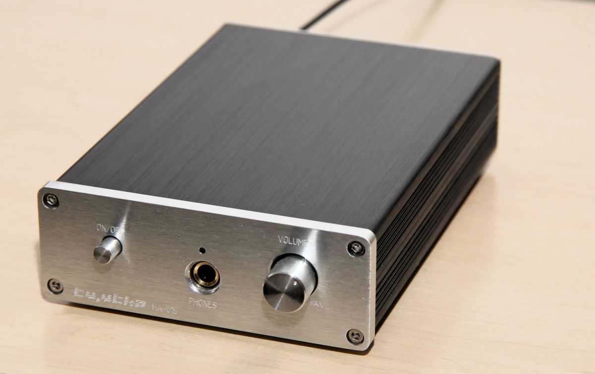

  • Close-up of the front panel of a headphone amplifier with on/off switch, headphone jack, and volume knob. .

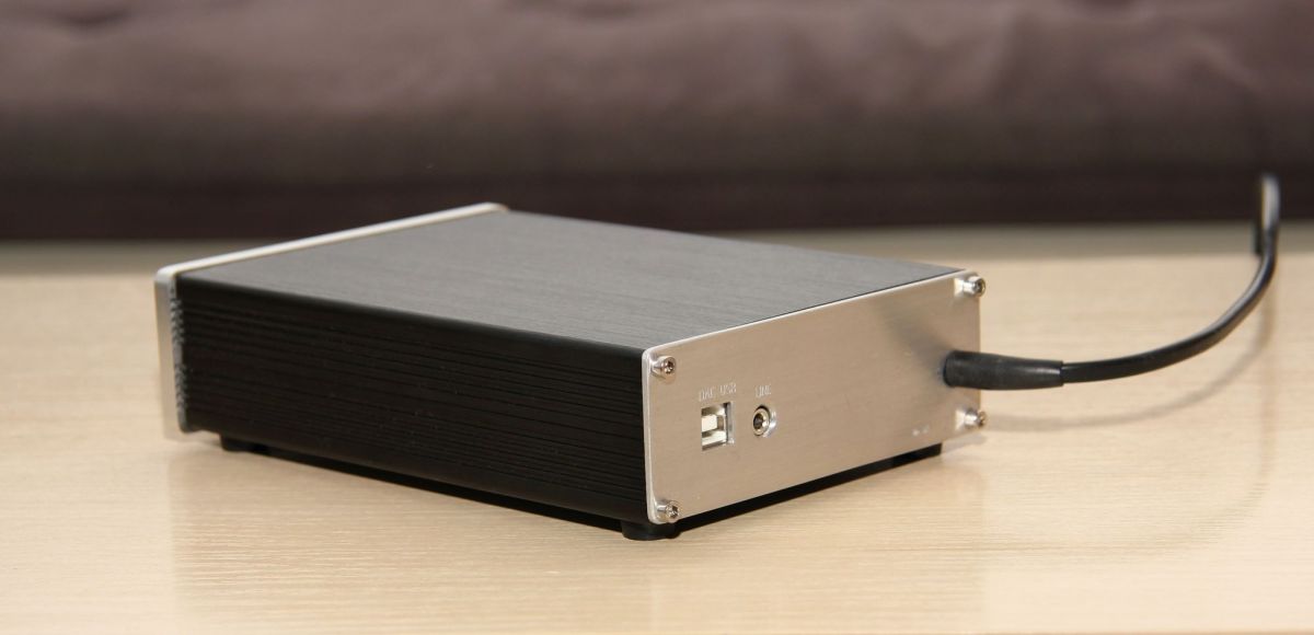

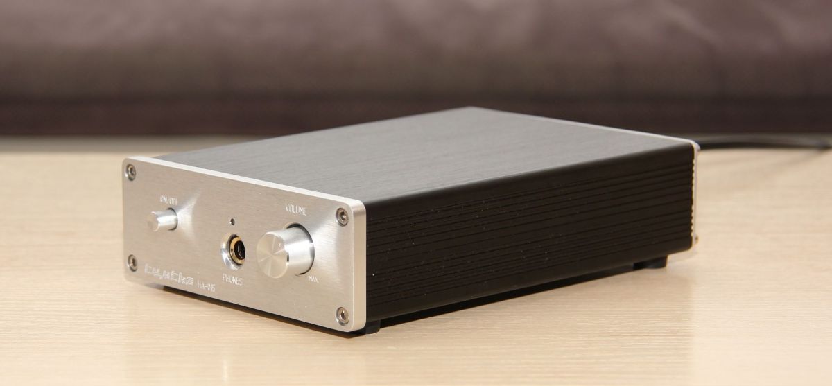

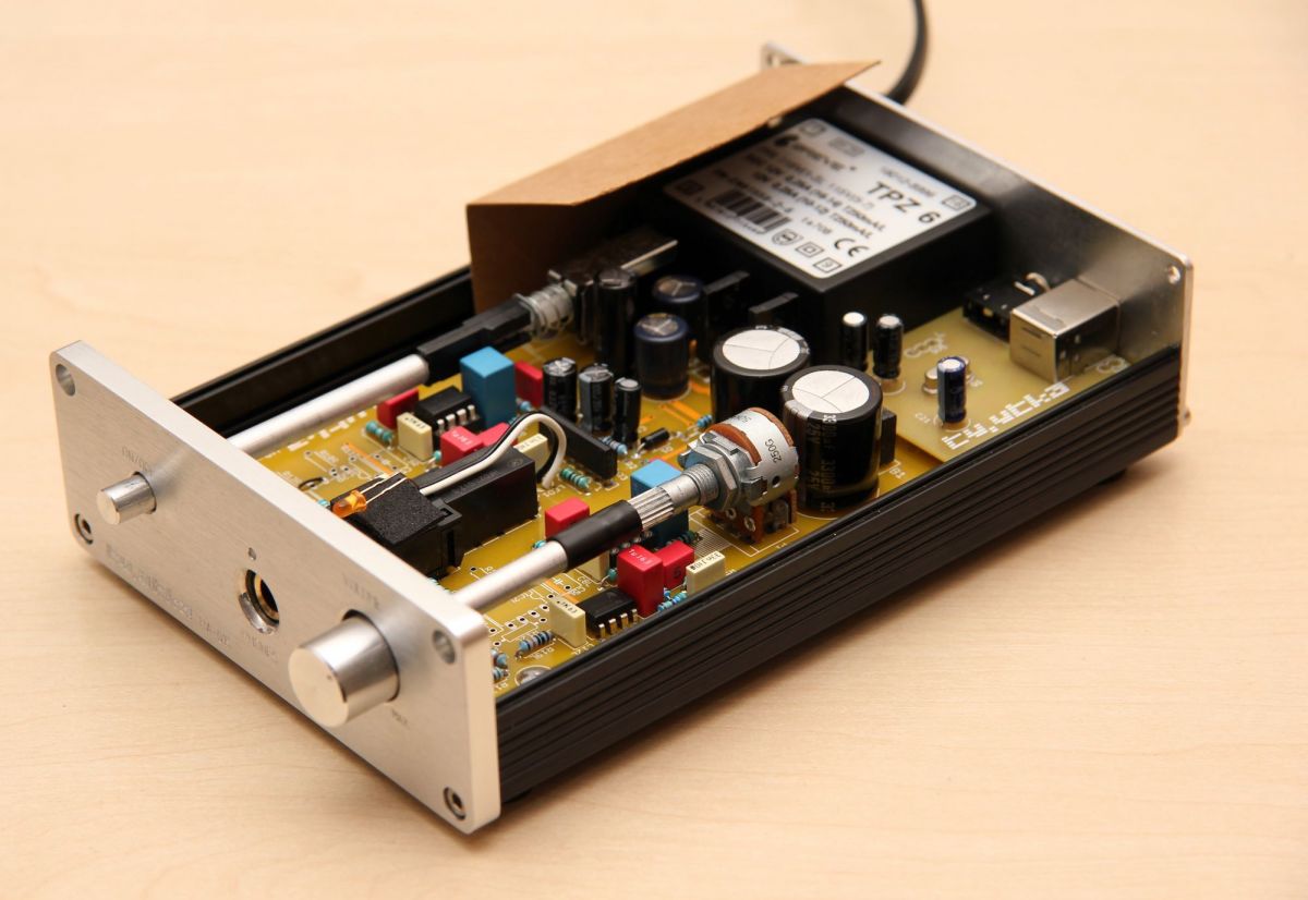

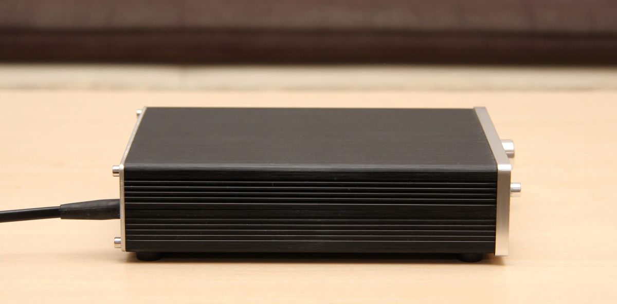

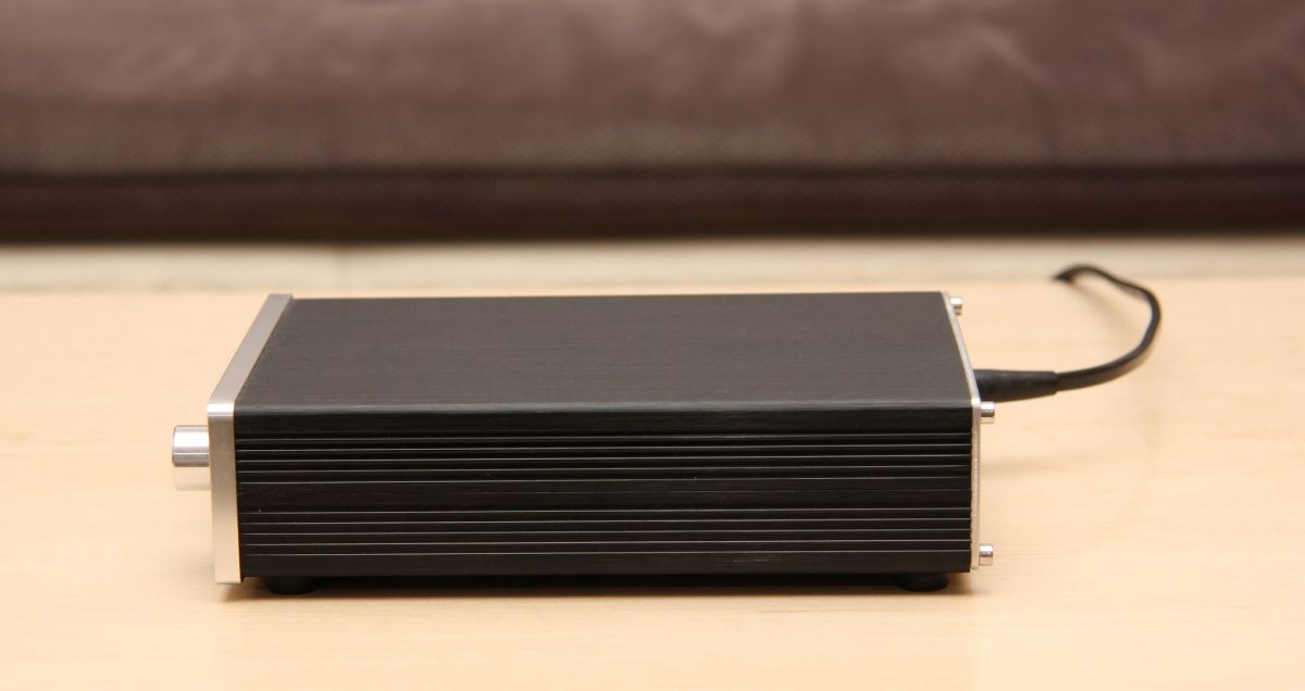

    The design of this headphone amplifier, is actually an update of my earlier design presented here ( Link ).

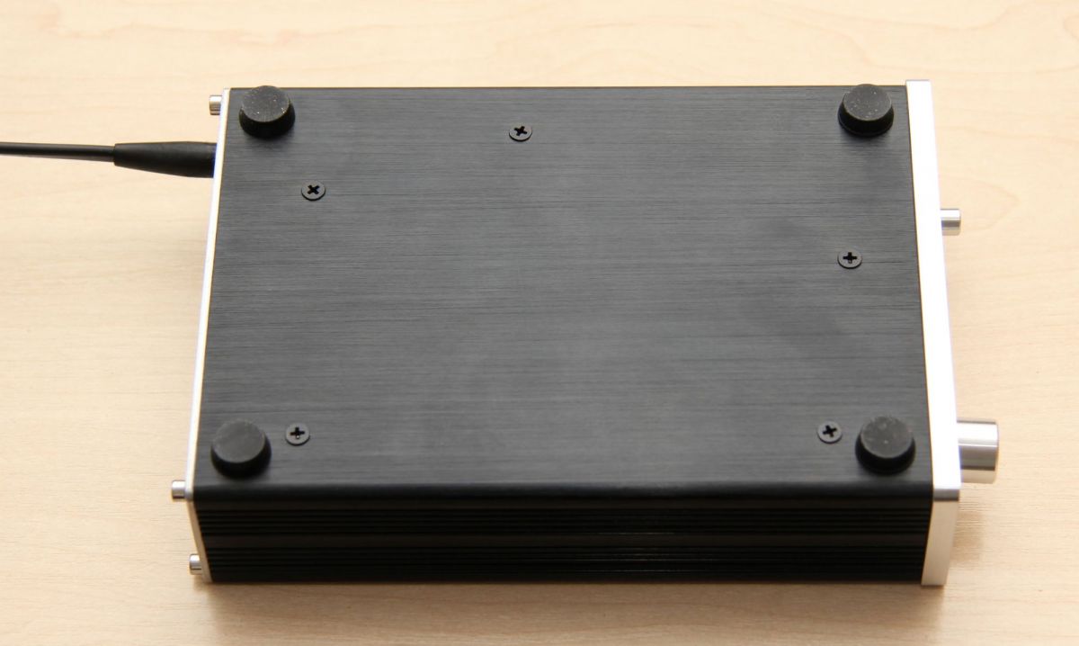

    Compared to the original version, a few things have been changed. The one that is immediately apparent is the casing.
    The new housing is slightly larger. Its internal dimensions are: 105 x 160 x 35mm (with external: 115 x 168 x 40mm). The dimensions of the amplifier board are: 97 x 159.5mm. So, there is now slightly more space. The board itself is now not pushed into the profile, but fixed to the underside of the case, via spacers 5mm high. From the side edge of the plate to the side wall, there is 4mm of space on each side. The area of the housing that is adjacent to the mains voltage area of the PCB has been shielded with 0.5mm thick pre-shrink. The mains cable exit from the enclosure, is sheathed in a dedicated rubber bend.

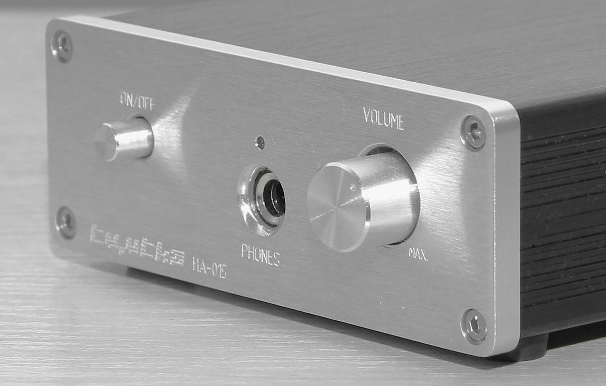

    All the work involved in machining the raw case to adapt it for this project was done by myself.
    The lettering was engraved, using a small, simple CNC machine.
    Just to pre-empt any questions, I would like to inform you that this time the engraving was not filled with paint on purpose. The idea was for the description to be there, but relatively subtle.

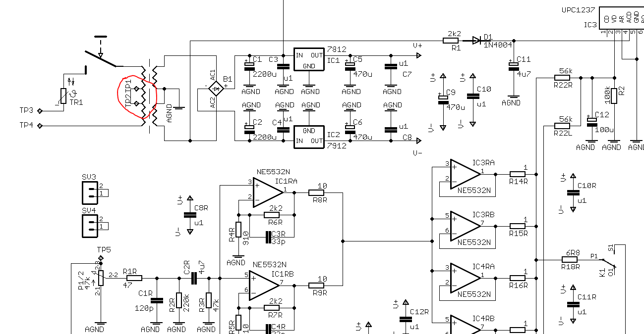

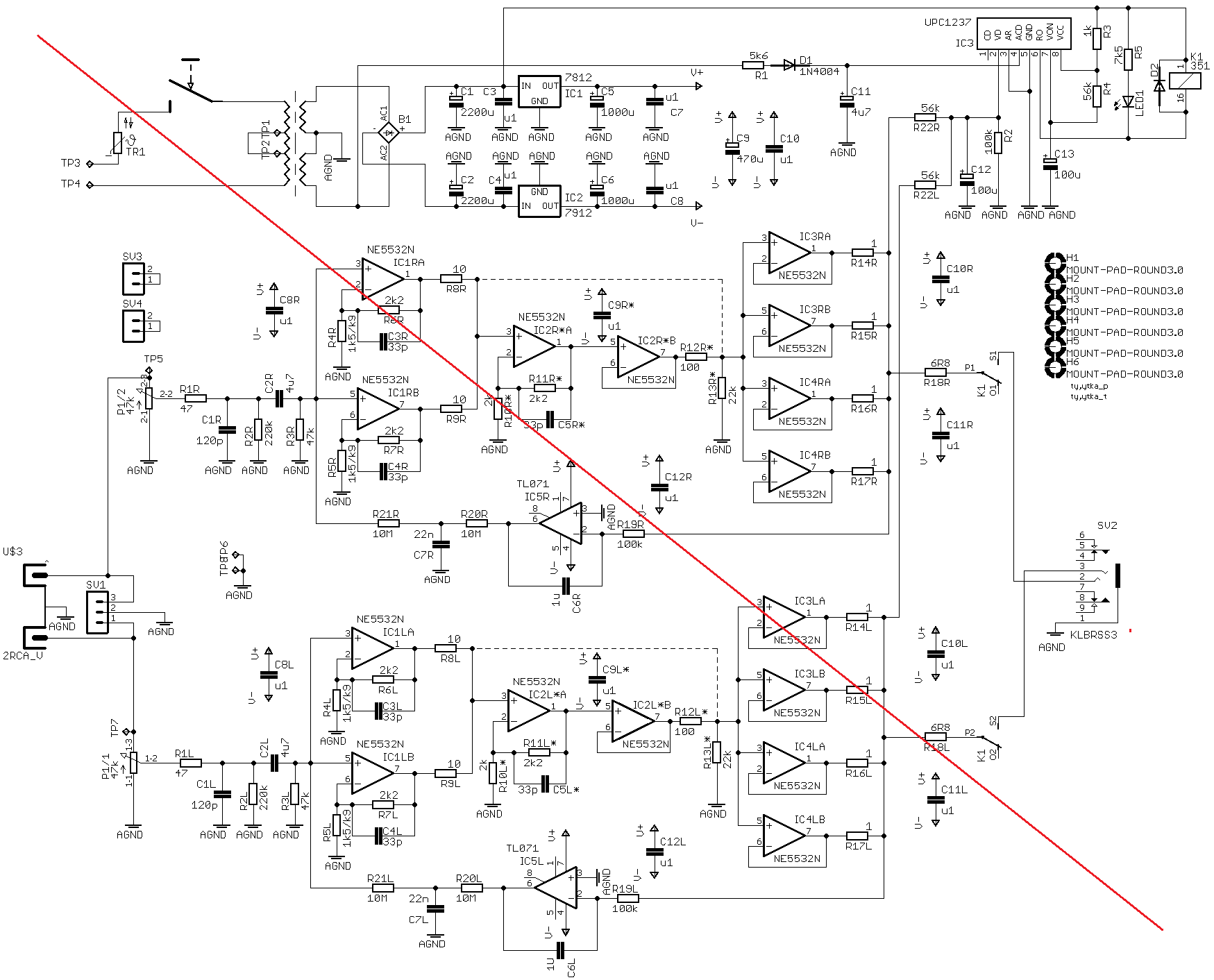

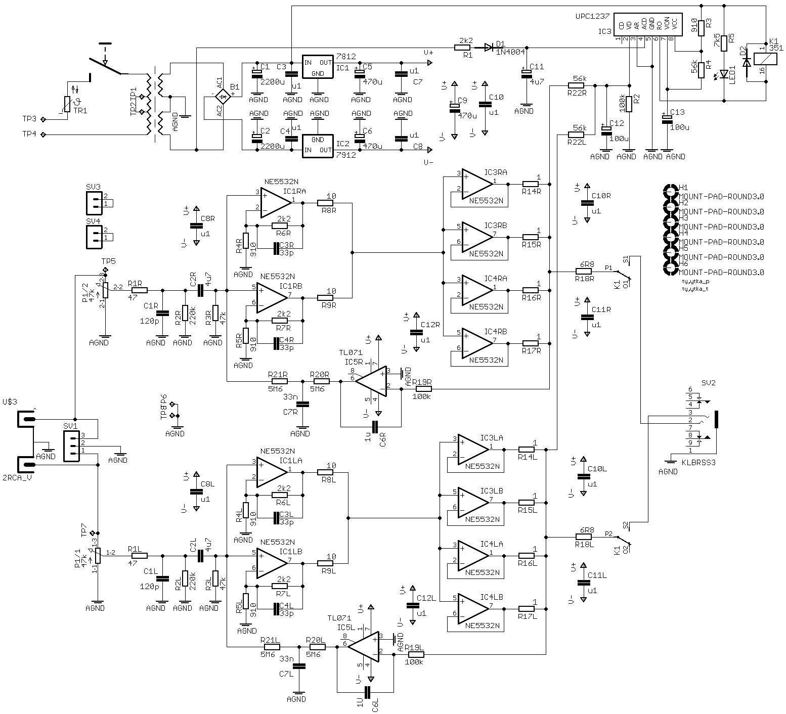

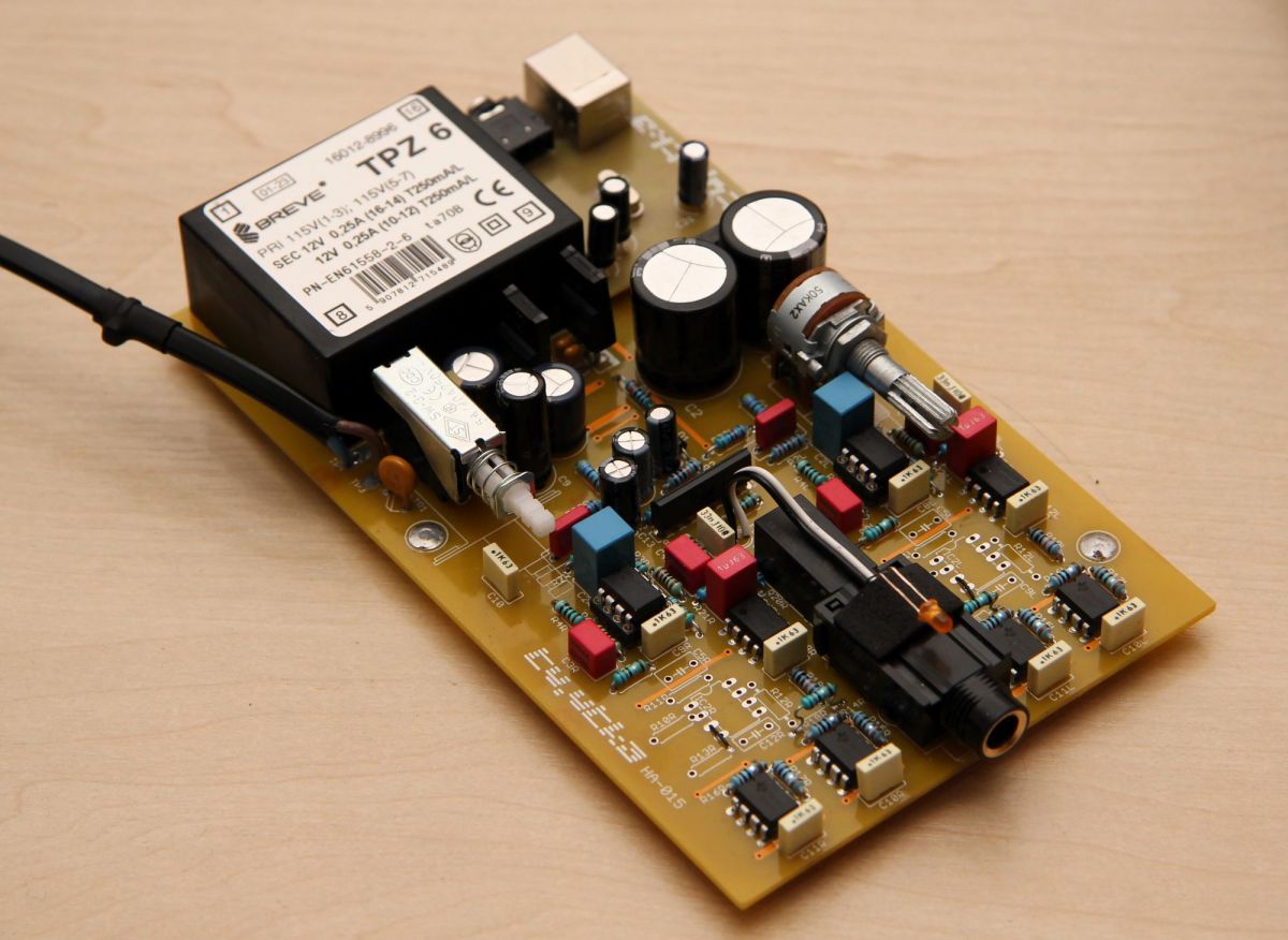

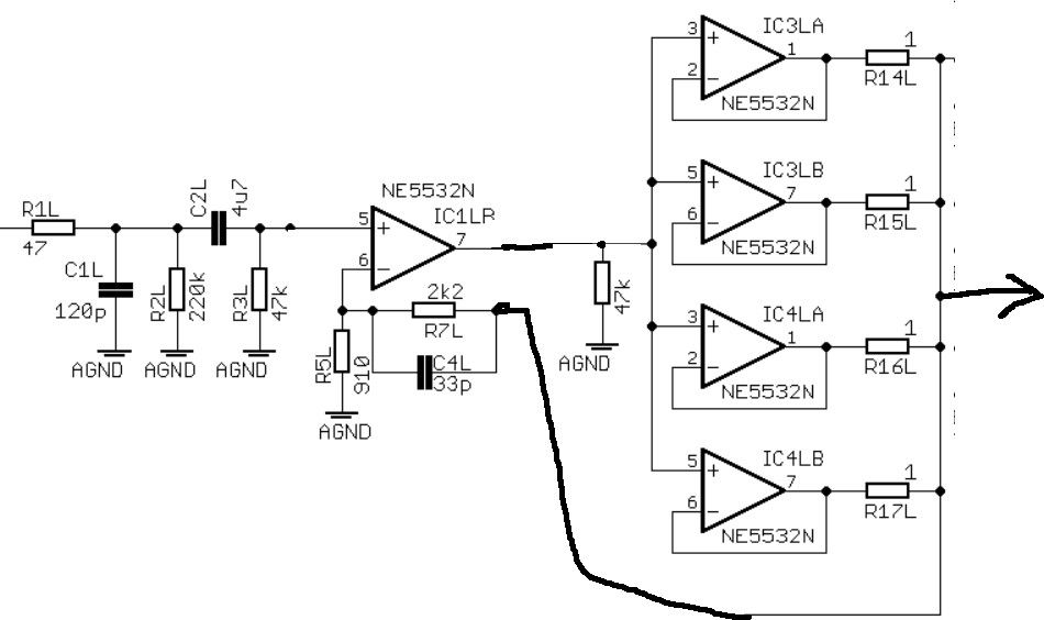

    Now perhaps a little about the electronics.
    For those who haven't seen the previous version, let me remind you that this is a design based on Douglas Self's project on achieving higher power when connecting operational amplifiers in parallel.
    Compared to the previous version, the circuit has been slightly simplified. The amplifier section has been shortened to two stages. Why? The previous version was actually a fitting for a power amplifier realised on operational amplifiers, which I was working on at the time ( Link ). It was known that the circuit there (power amplifiers) would need more gain. However, in a headphone amplifier, such an elaborate circuit is not needed. So I decided to simplify it, resulting in only two stages remaining. The first is a parallel voltage amplifier (2 operational amplifiers) and the second is also parallel, but this time a current amplifier (4 operational amplifiers).
    The rest of the circuitry, i.e. the power supply, the protection circuit, and the DAC, remained as before.
    Headphone amplifier schematic with NE5532N and TL072 components. .
    Electrical schematic of a headphone amplifier with parallel operational amplifiers. Block diagram of a headphone amplifier circuit based on PCM2705. .

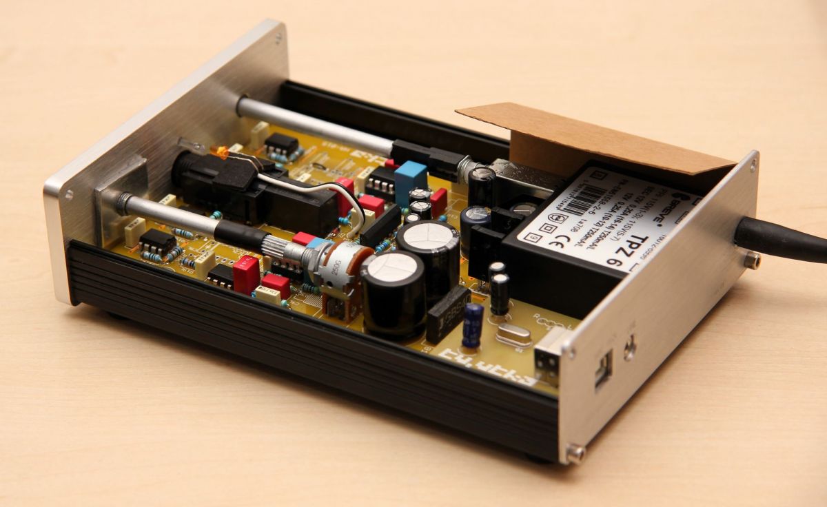

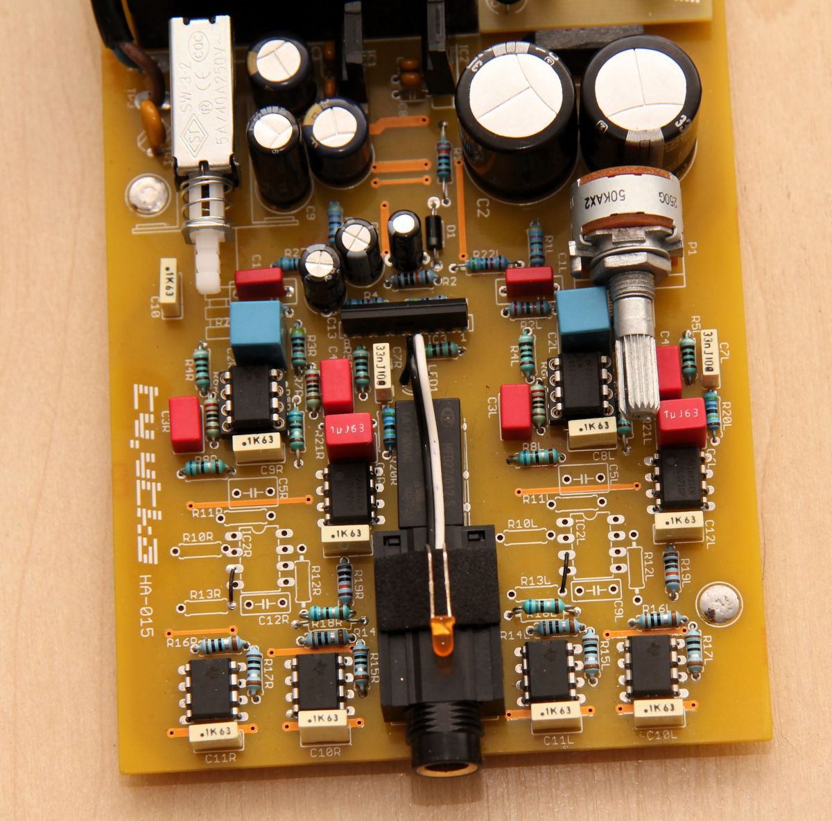

    Close-up of a headphone amplifier circuit board with electronic components. Printed circuit board of a headphone amplifier with various electronic components. Circuit board of a headphone amplifier with electronic components. .

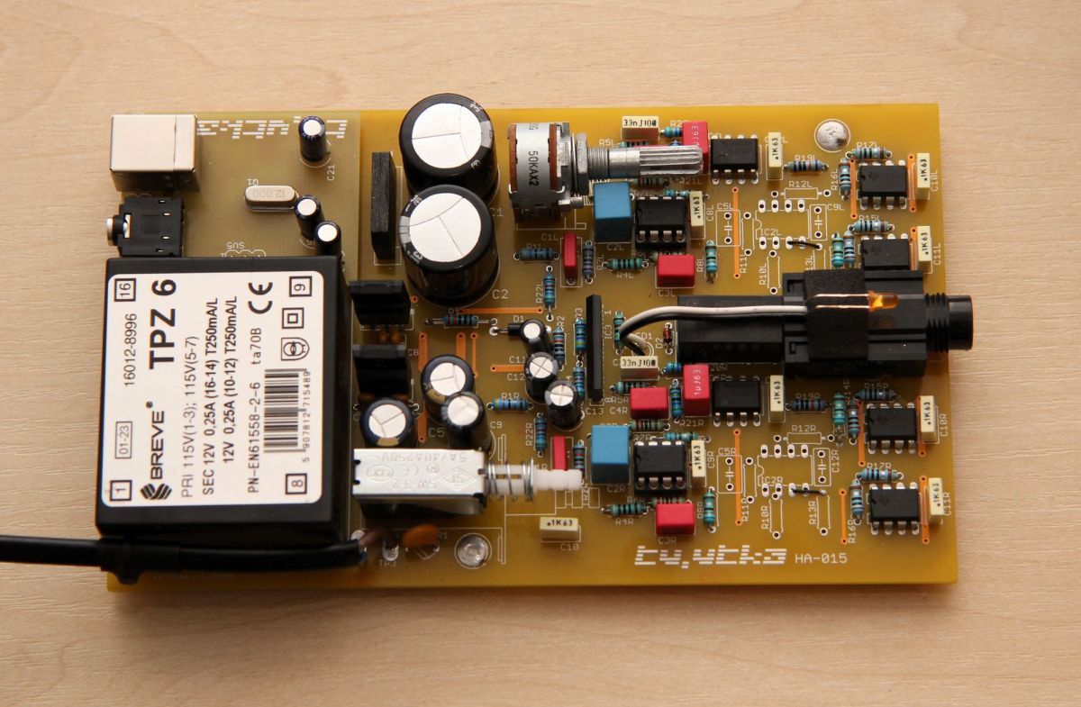

    Below are a few more photos showing the end result.
    Open headphone amplifier with visible PCB and electronic components in an aluminum case. Headphone amplifier in a new larger case with a mounted electronic board. Bottom view of a headphone amplifier with a new, larger enclosure. Black headphone amplifier with a visible power cord, placed on a table. Black headphone amplifier with a visible power cord, placed on a table. Black headphone amplifier with a new, larger case on a wooden table. Upgraded headphone amplifier with larger casing. Metal enclosure of a headphone amplifier with a volume knob and headphone jack. Headphone amplifier in a metal case with front buttons. Headphone amplifier in a metal case with front buttons. .

    Each time, I am impressed by the aesthetics and refinement of the design.
    What is a U3 circuit in an oblong housing? The output protection?
    And a second question - do you mill the front panel in-house or do you have someone where such can be ordered?
  • Output resistor outside feedback loop criticized

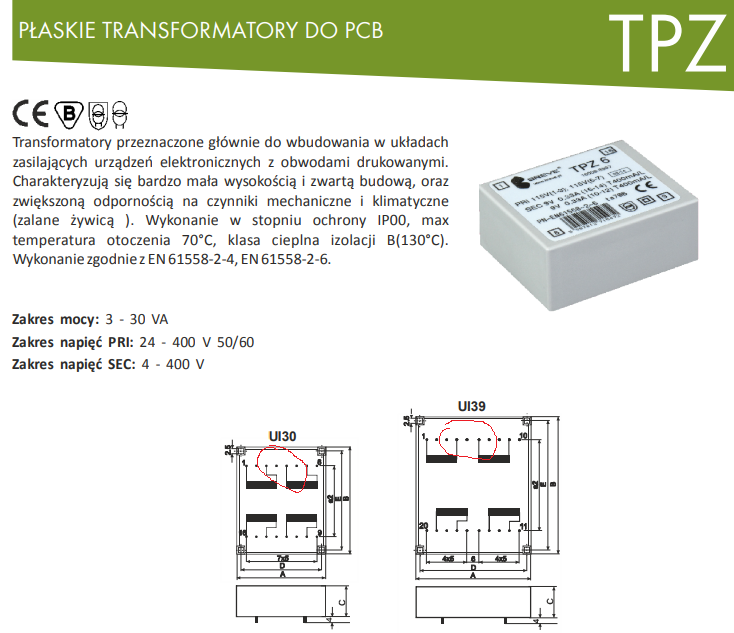

    I see the paper under 230V is :-) .

    I noticed a little zonk in the schematic but that's probably a Czech error.
    A section of an electronic schematic showing circuits and components.
    Diagram and description of flat transformers for PCB with device illustration.

    And referring to your posts:
    - "What is the U3 circuit ?" It is a protection circuit. It delays the switching on of the headphones, and automatically disconnects them if any DC voltage is present at the output.
    - "Do you mill the front panel yourself ?" Yes I did the machining myself. Only the lettering was milled. The holes were made with a table drill and refined with a mini grinder.
    - "Two parallel amplifiers in the first stage ?" Apparently not necessary in this case, although they have their advantages. But note that the board is the same as in the original version, so there was no other option.
    - "An operational amplifier in a 'global feedback' loop?" Well, it's well known that DC-servo circuits probably have as many opponents as supporters. I am, let's say, in the middle, but in this project I decided to use it.
    - " A 6R8 resistor at the output?" Maybe its value seems high. I used it to protect the outputs of the circuits in case of a possible short circuit of the amplifier output. And to be honest, I personally don't use low impedance headphones. Of the ones I own, the least is 44 ohms.
    - " likewise the resistors on the output of the secondaries" I there, would not dare to give up those 1 ohm resistors.
    - "The amp would be complete for me if it included an RIAA equalization circuit" Very interesting and inspiring comment. I won't change it anymore in this amp, but I am thinking of upgrading, my tube OTL. I will strongly take this under consideration.
    - "The paper under 230V is" In the previous version there was a foil, but supposedly wrong, not enough etc.
    - "I noticed a little zonk in the schematic". This is a result of the fact that I had a transformer of the same dimensions in the library, but without the split primary winding. And at the moment, it was quicker to do such a myopic than to add a new component to the library.

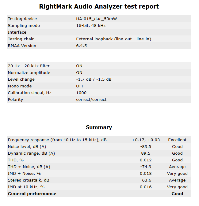

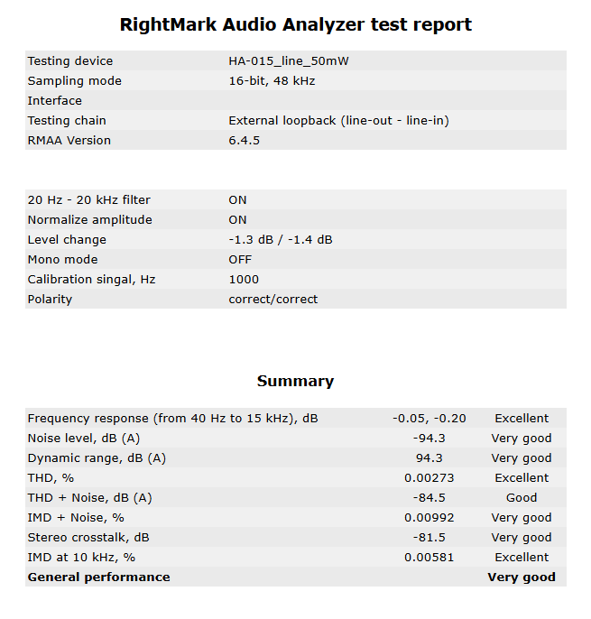

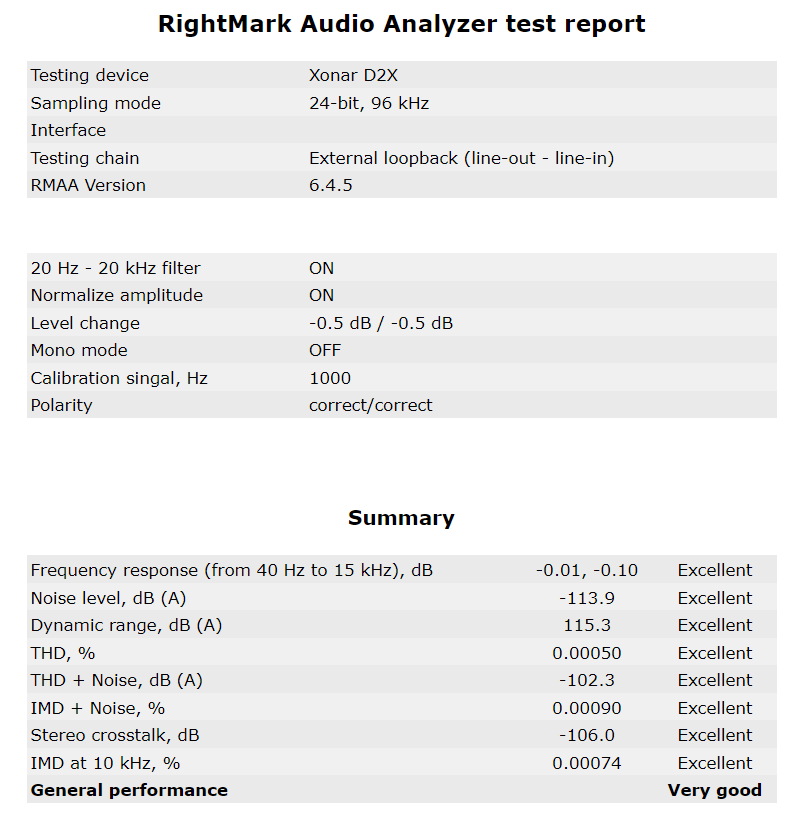

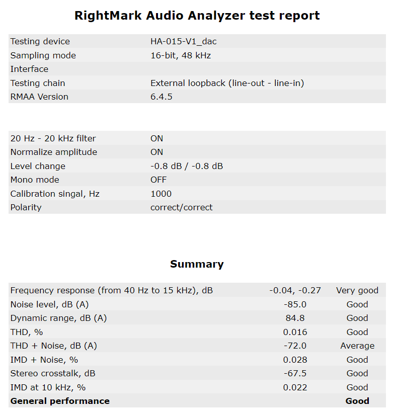

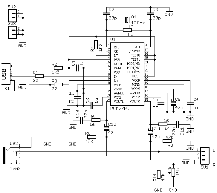

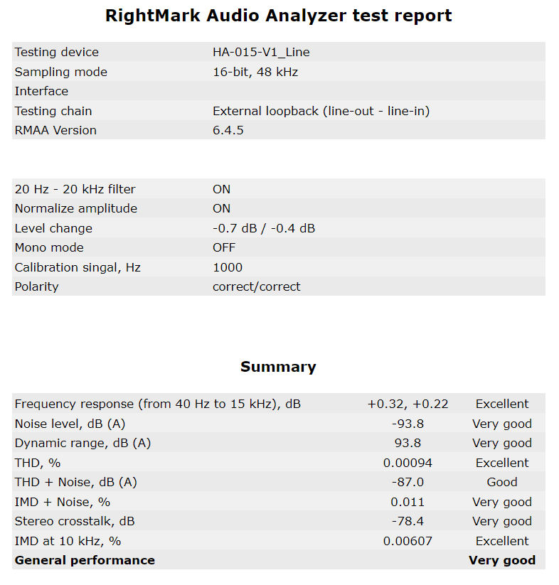

    I promised to post the measurement results of this amplifier.
    There will be some curiosity here, you will see how the PCM2705 chip, turns out to be quite a bottleneck in terms of the measurement results obtained.
    Here is a report of measurements of the amplifier driven from the line input:
    Screenshot of a RightMark Audio Analyzer test report for device HA-015_line_50mW. .
    And this report, is the result of a test carried out, when driven from the digital input:
    Screenshot of a sound test report from RightMark Audio Analyzer program. .
    It appears that I have not achieved the parameters declared in the PCM2705 note :( .

    If I'm not mistaken, this simplified version has slightly better performance than the previous, more elaborate version, especially the THD, which is almost halved. I'm already overlooking the fact that this is probably beyond the limit of perception in either case.

    tytka wrote:
    It appears that I have not achieved the parameters claimed in the PCM2705 note
    Interesting... You must have something wrong. I would expect a lot more from analogue too.
    Can you give measurements of the card/interface itself?

    In fact, this version came out slightly better in the tests carried out. But this may be partly due to the slightly changed measuring conditions.
    It doesn't look like anything is wrong.
    It's just that the PCM2705 surprisingly comes out poorly in the tests I ran. I also tested it on another device.
    Maybe I'll give it another go.
    And if you want to see the card's measurement, here you go:
    RightMark Audio Analyzer test report for Xonar D2X device. .

    Where did you get this enclosure from? I ordered some from the net, it was supposed to have these dimensions, it arrives and here's the trick, the dimensions are given for the outside and it's not possible to put the board inside. This would have been ideal.

    wiorekw wrote:
    If I'm not mistaken, this simplified version has slightly better performance than the previous one
    Today I had a moment, so I tested the original/more elaborate version (as it sits in a drawer one without a case) under the same conditions as now this revised, or simplified, one.
    For the line input:
    RightMark Audio Analyzer test report for HA-015-V1_Line device showing measurement results. .
    For USB input:
    Screenshot of a RightMark Audio Analyzer test report for the HA-015-V1_dac device. .
    Unfortunately I am not able to achieve better results in measurements with this PCM.
    The situation is similar with my other battery-powered headphone amplifier ( Link ).
    There I accidentally achieve virtually identical performance.
    siewcu wrote:
    And where did the colleague get this enclosure from?
    And from Alie...
    I bought a few months earlier, but now I checked and the auction is still active. So if you want it, get back to me on priv and I'll provide you with a link.

How did the simplified two-stage headphone amplifier measure compared with the author's earlier, more elaborate version?
It measured slightly better when the author retested both versions under the same conditions. Another participant already noticed that THD looked almost halved in the simplified version, and the author later confirmed that this revised build came out “slightly better in the tests carried out.” He also warned that earlier comparisons may have been affected by changed measurement conditions, which is why the same-condition retest matters more than the first impression from separate reports. [#21305458]
Why does the PCM2705 appear to be the bottleneck in the USB input measurements of this amplifier?
The USB-input results stayed worse than the line-input results, and the author saw the same pattern on another device using the same PCM2705. He explicitly says the PCM2705 “turns out to be quite a bottleneck” in the measurements and later adds that he cannot achieve better results with this PCM even after comparing across projects. That points to the DAC path as the limiting block during USB tests, rather than the revised analog amplifier alone. [#21305458]
How can you check whether poor audio measurements come from the PCM2705 DAC, the amplifier, or the measurement card/interface itself?
You isolate each block and compare results. 1. Measure the amplifier from the line input. 2. Measure it again from the USB input using the PCM2705. 3. Measure the sound card or interface itself. The thread follows exactly that logic: the author posted a line-input report, a digital-input report, and then a separate measurement of the card/interface on request. That sequence helps show whether the limit comes from the analog amplifier, the PCM2705 USB DAC path, or the measurement chain. [#21302333]

NE5532 versus TPA61xx: which approach makes more sense for a small DIY headphone amplifier?
In this thread, NE5532-based parallel stages make sense if you want to pursue the author’s discrete DIY topology, while TPA61xx makes sense if you want a simpler small-form build. One commenter says that, if he built this topology, he would simplify the first stage from a dual NE5532 arrangement and would personally rather use “something like the TPA61xx.” That is not a measured shootout here. It is a design-choice contrast between a more elaborate DIY op-amp approach and a more integrated headphone-driver approach. [#21299568]
What safety measures should be used around the 230 V mains area inside a compact headphone amplifier enclosure?
You should physically insulate the mains area and protect cable exits from abrasion. The author shielded the enclosure section next to the mains-voltage PCB area with 0.5 mm pre-shrink material and routed the mains cable through a dedicated rubber bend. A commenter also noticed the insulating sheet under the 230 V area, and the author explained that the earlier version used foil instead. In a tight metal enclosure, spacing, insulation, and strain relief are the key safety measures shown here. [#21297550]
How do you choose an enclosure so the quoted dimensions match the usable internal space for the PCB?
Choose by verified internal dimensions, not by the seller’s outside measurements. This project fits because the usable inside is 105 × 160 × 35 mm, while the PCB itself is 97 × 159.5 mm, leaving only 4 mm to each side wall. One later commenter described the common failure case: ordering a case advertised by dimensions that turn out to be external only, so the board will not fit inside. In practice, compare PCB width, PCB length, wall thickness, and mounting method before ordering. [#21304213]
Where can you source the aluminum enclosure used for this project, and what dimensions should you verify before ordering?
The author sourced it from AliExpress. Before ordering, verify both the external size, 115 × 168 × 40 mm, and the internal usable space, 105 × 160 × 35 mm. Also confirm that your PCB dimensions leave room for side clearances, spacers, cable bends, and mains insulation. In this build, the PCB is 97 × 159.5 mm, so the fit is already tight in one axis. That is why internal dimensions matter more than listing titles or photos. [#21305458]
