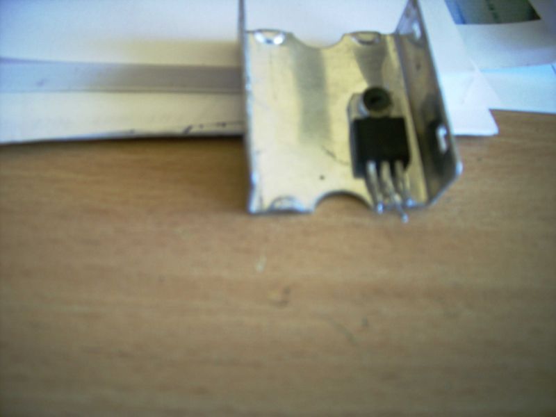

    I did not have much time to go to repair this grinder. I have just mobilized today and ... it turns out that the grinder has some electronics in it. Plastic inscription on the plastic housing; ERST-16A16 (10) 230V 5E4 and below wiring diagram. In the middle, some parts, among others, LM 358, transistors S9015 and S9014. The aluminum cover is attached to the BTA 12 / 600B triac, which should be soldered to the plate, but someone peeked in and snatched it with the aluminum cover. I tried to take out the electronics board but I could not do it because it's glued to the casing ....... and maybe someone knows how to peel it and not break it. How much can it cost new and where you can possibly buy it, although I'd rather fix what it is.
    I attach some photos

    This tile is only a mild start, it costs 25zl on the Allegro.
    This gentle start you can not fix it, it seems to me that not only this triac is detached but the electronics are burnt. Give it to yourself and connect directly under both cables coming out of the stator just like your friend Tomek presented above.

    According to the suggestion, I did not combine to play in the repair of a soft start, I only bought a new one / 19 PLN / and I put it on a grinder.
    After the repair, "hula" grinder that it's nice! I have found that it is very specific, strong and durable equipment and the relation quality / price is very beneficial.
