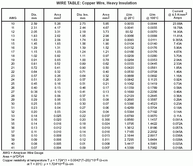

    Do you know the formula for the resistance of the winding wire of a copper model? :D N2E 180 or DN2E 200 or ordinary enamel wire depending on its diameter and length.
    I think this is the wire parameter, which is the number of ohms per meter of length.
    The pattern I am looking for is needed to select the appropriate wire diameter so that the specified number of turns has the assumed resistance, in this case it is a loudspeaker coil.

    R = ro * l / s
    ro = 0.017 ohm * mm ^ 2 / m
    l - wire length
    s - cross-sectional area

    In the Elfy catalog, which is somewhere on the electrode here, there is a table of wire resistance diameters and other parameters
  • #8 3605904
    Gonzo
    Posts: 115
    Help: 10
    Rate: 22
    And the tables are here, and if you want, look for a program called "CPW" by mate_ok, such a small but useful application that will help you with air coils, if you do not find it, give it an e-mail and send it to you ...
