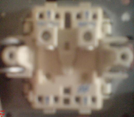

  • #11 7960078
    dareksg
    Could someone explain to me where in this switch lead the individual wires? currently I have 6 wires for each switch. In 1, 2 phases and 4 wires from switch to switch, and in the second, 2 neutral wires and 4 of 1 on.
    How Many Wires for Double Staircase Switch with Independent Lamp Control: Wiring Guide
    it is a le grand switch and has inputs for 8 wires.
    greetings

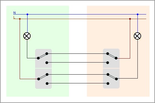

  • #15 7963782
    elkard
    Level 36  
    Posts: 2092
    Help: 397
    Rate: 253
    Buddy, this double stair switch is nothing more than two independent switches in one luminaire (box). And it is used for independent switching of two circuits from two places.
    What is there not to understand?
    For example like here:

  • #17 7963844
    elkard
    Level 36  
    Posts: 2092
    Help: 397
    Rate: 253
    When, for example, in a room with two entrances we have two lighting circuits (a chandelier with one circuit 100W and the other 40W). And we want to switch on or off one or the other circuit at one or the other input.
