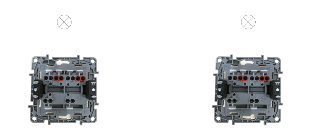

    Hello, I could ask for a diagram of a double stair legrand switch (such as in the picture) for two lamps connected separately to each switch (one lamp for one switch, the other for the other). I managed to make a diagram, but the lamps were connected to one switch.
    Thank you very much in advance.
    Attached are the switches I have and a working diagram (but the lamps are for one switch, and I want them separately)

    You can do this, but you must give power (L) to both switches.
    Interesting suggestion - could you explain it??
    From what I can see, this "scheme" of the connection is correct (if the black terminals are the correspondent and the burgundy ones are resp.)

    Just treat each switch as two separate ones and power from both sides, since the author wants to have the tubes connected to separate switches.

    Zyzy52 but YOU powered the loads from different cans (switches) and the original post was different - both lighting from one off.
    There, in the diagram, this N was somehow drawn strangely and it can be misleading.
    I do not write anything about the lack of protection - because it is obvious that there must be such and by oversight it is not included in the draft.
    I drew this because the author wanted to have the lamps connected separately to each switch. In addition, it is possible that he will have power from the same circuit (fuse) at the second can, he did not write anything about it. In the end, there is no other way to do this. I omitted the protection in the drawing on purpose, so as not to obscure the "scheme", it is known that it should be.
