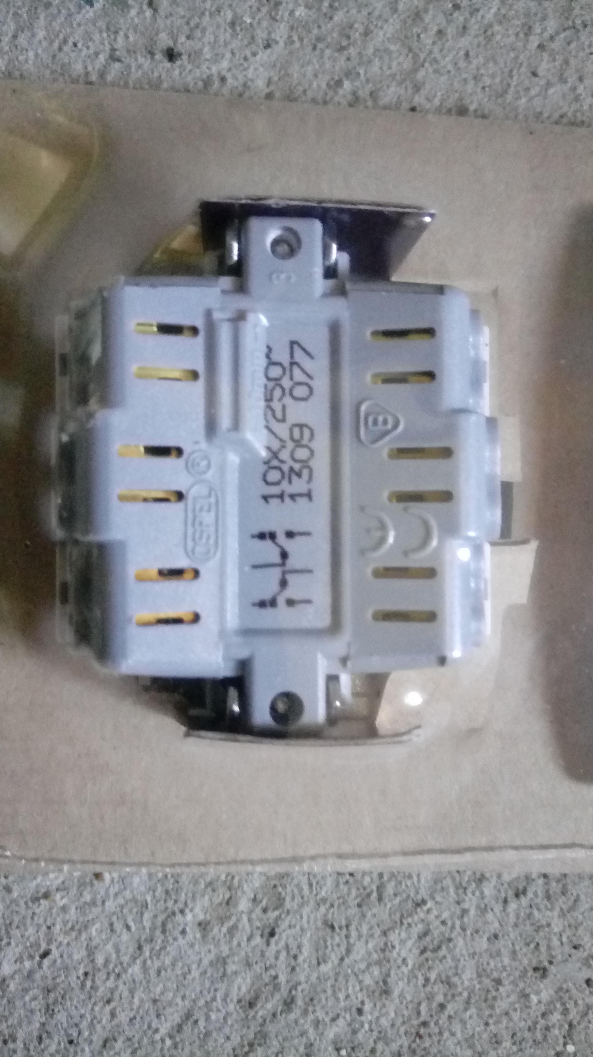

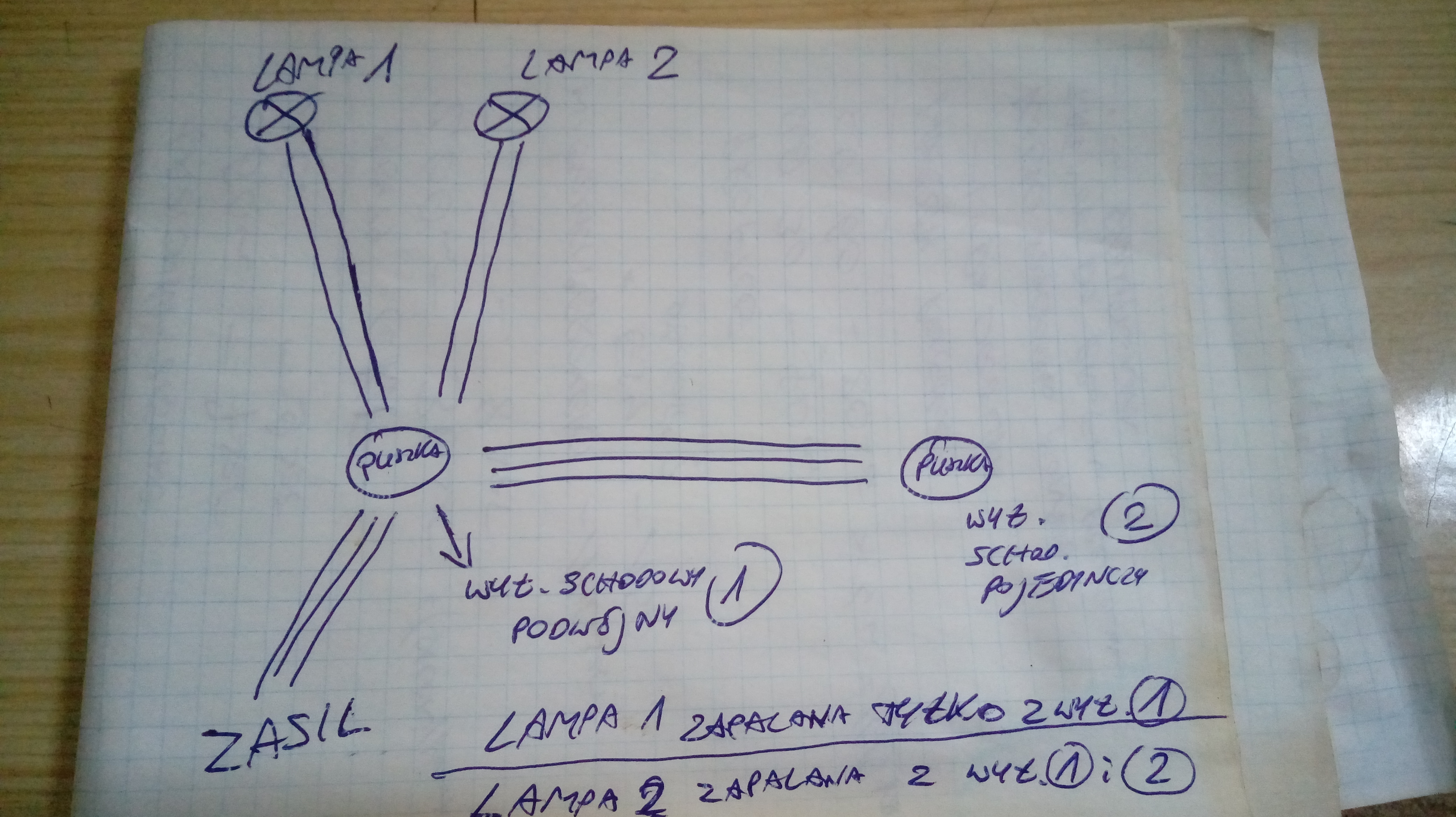

    Hello. I have a single and a double staircase switch.
    Power supply and wires for one and the other lamp are in the box where there will be a double stair switch - it should turn on one lamp with one of the buttons and the other with the second lamp. The second lamp is to be controlled by a second button and a single stair switch from the second can.
    How to connect it?
    • Connecting a Double Staircase Switch with a Single One: Step-by-Step Guide 20170722_182215.jpg (585.51 KB) You must be logged in to download this attachment.
    • Connecting a Double Staircase Switch with a Single One: Step-by-Step Guide 20170722_182059.jpg (826.78 KB) You must be logged in to download this attachment.
    • Connecting a Double Staircase Switch with a Single One: Step-by-Step Guide 20170722_183306.jpg (2.69 MB) You must be logged in to download this attachment.

    According to what you wrote only that I connected the circuit breakers with each other with two wires and has 3 wires between the boxes.
    In the No. 1 slot, I have wires from the No. 1 lamp and the No. 2 lamp, power supply and 3 wires between the two cans
    Added after 12 [minutes]:
    Or at least how to connect the two switches (double and single) to each other with this one double stair and a single staircase to control the lamp from two places. A double staircase will be in the first stage where there is power and lamp wires

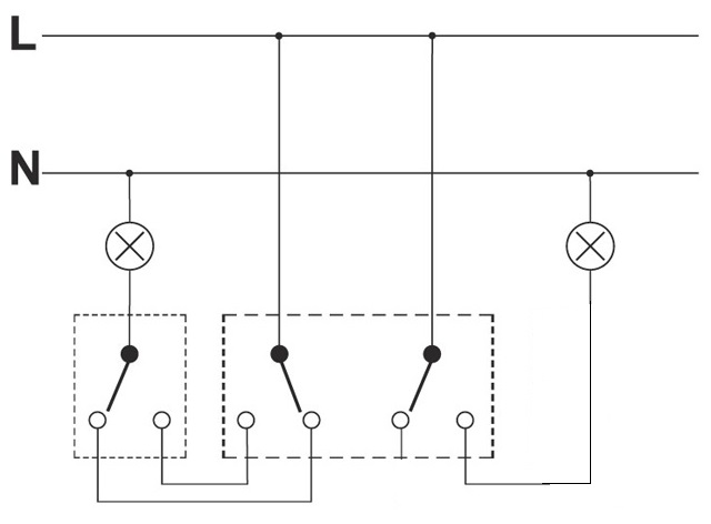

    #8 16617013
    Heinzek
    Posts: 3732
    Help: 554
    Rate: 494
    Something like this quickly:
    in the first can, do not forget to connect neutral and PE wires

    #10 16617077
    rafcio_21
    Posts: 1110
    Help: 137
    Rate: 299
    It is these three wires from the second box that you connect to the brown staircase to the rest of the rest to leave. Go to 1 brown can which you connected in the second box you connect to the lamp and transmission to the staircase for departure, give only the phase on the center of the stair clamp L to the lamp you add N and Pe.

    Added after 11 [hours] 21 [minutes]:
    It works. Thanks for the help
