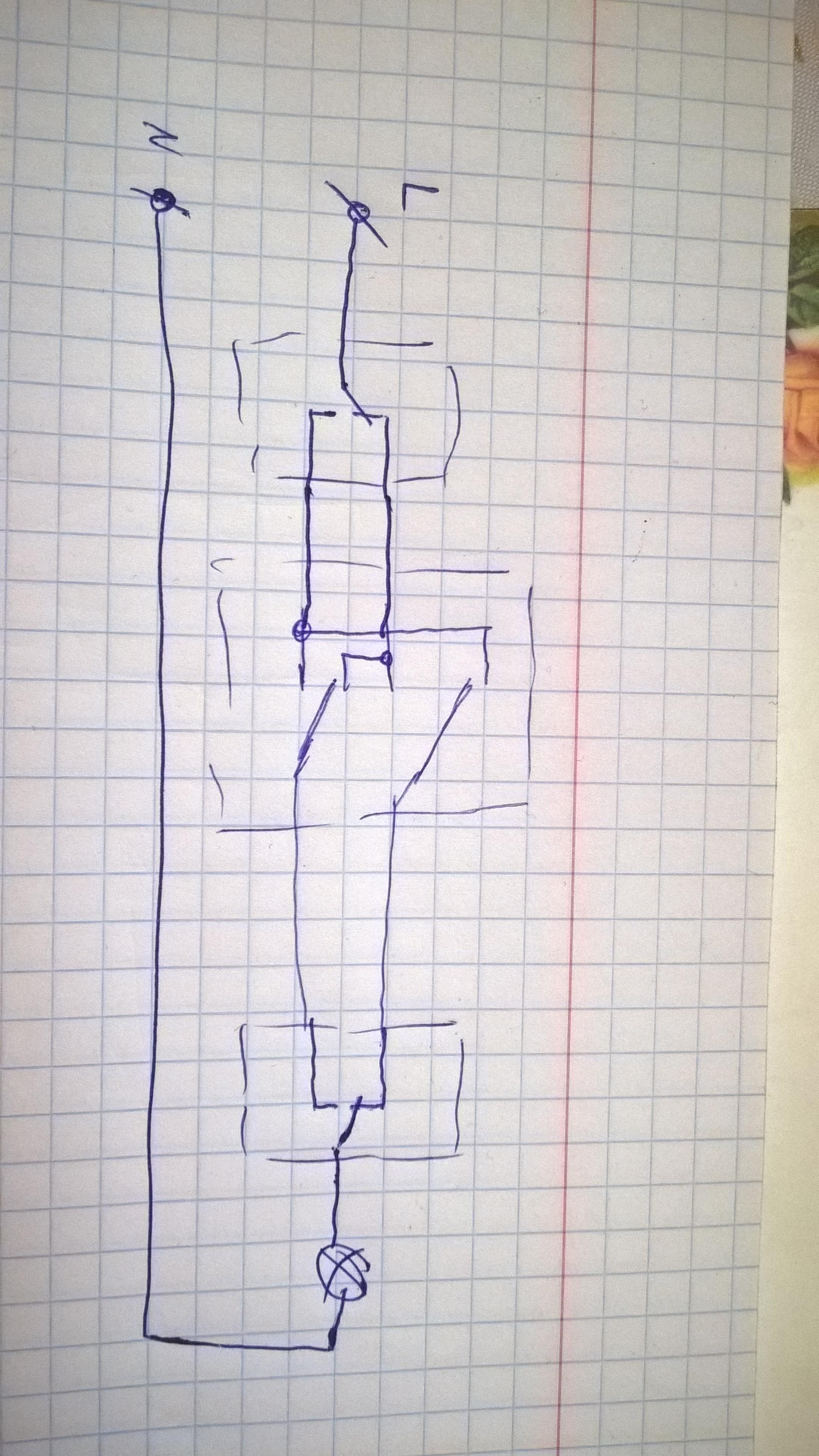

    Hello. I have a stair switch to connect and a single one in one. I connected 3 wires and the staircase works, but I have 2 more wires to connect to a single switch, I can not connect it in any way, someone can help?
    Two-Way Staircase Switch & Single Switch Connection - Wiring 3 Wires & 2 Free Conductors
    One of the two free conductors is phase and the other is neutral.

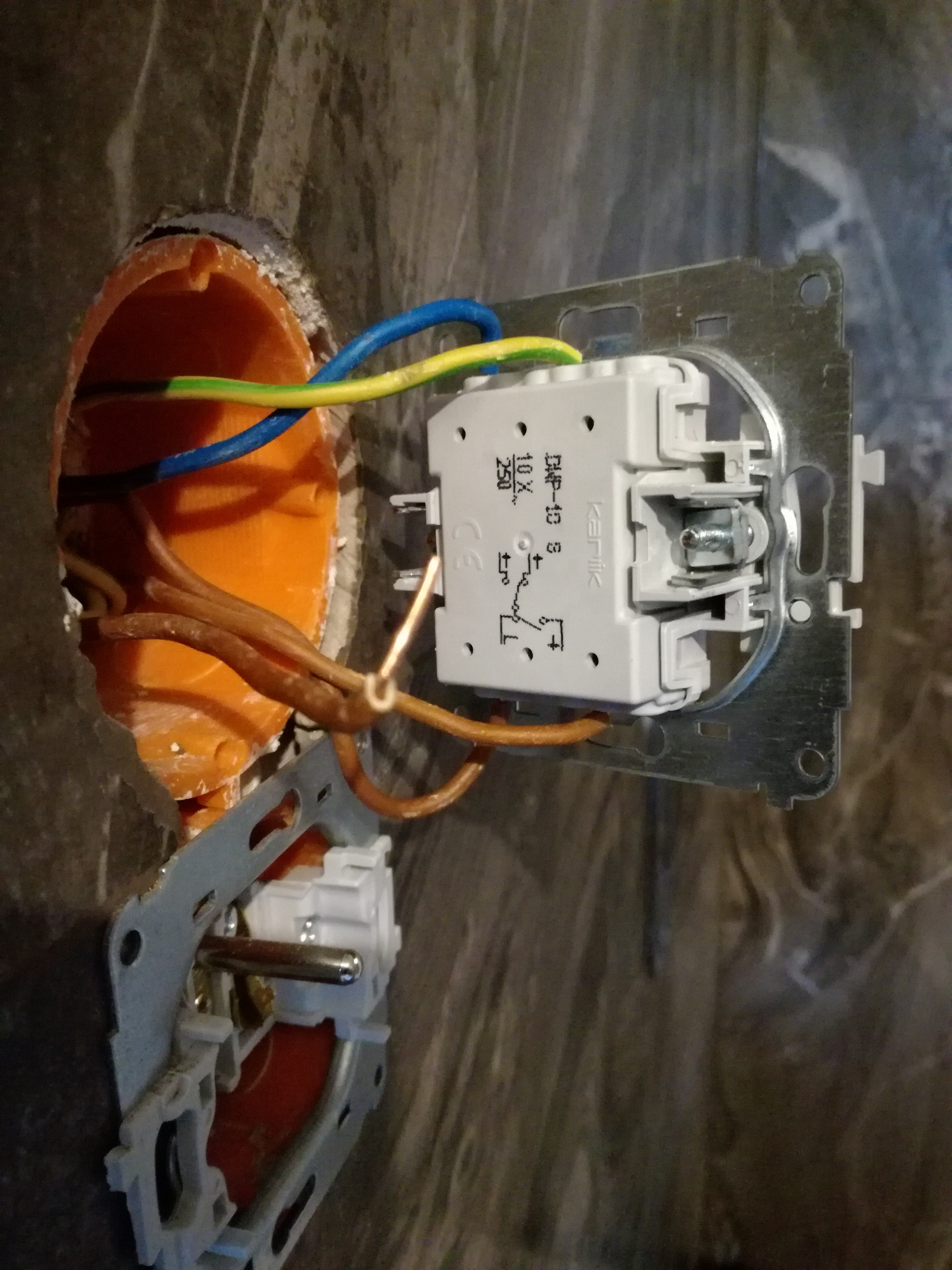

    We'll start with the fact that everything is wrong. :!:
    It is forbidden to use the yellow-green wire for purposes other than intended.
    The phase (I suppose) is already connected, the lamp wire is missing (or wires depending on how many of these lamps are)
    The photo shows that you have two wires, two wires, both brown, neither of them can be a "neutral" wire
    Make the conclusion yourself. :cry:

    Thank you for your interest, I understand that the yellow-green wire is a protective conductor and I understand what it is used for. However, in the case of a stair connection, voltage appears on it depending on the positions of the switches.
    When everything is disconnected, the brown wire that is connected now, as shown in the picture, is in phase. The two free brown wires when this connector turns on, the light in one of them is in phase.
    You are saying that one of the two free brown wires is the neutral wire :?: how did you check it :?: maybe it's a wire closing to N by a light source, hence the misperception.
    EDIT:
    So one of them (non-phase) must go to the terminal next to the terminal marked with L

    Why not so :?: someone just made a separate two-way switch and a single-pole switch next to him and the author wants to connect both on one switch, so one phase wire must be free.
    In the lower left corner of the photo from the first post there is another can and some piece of equipment.

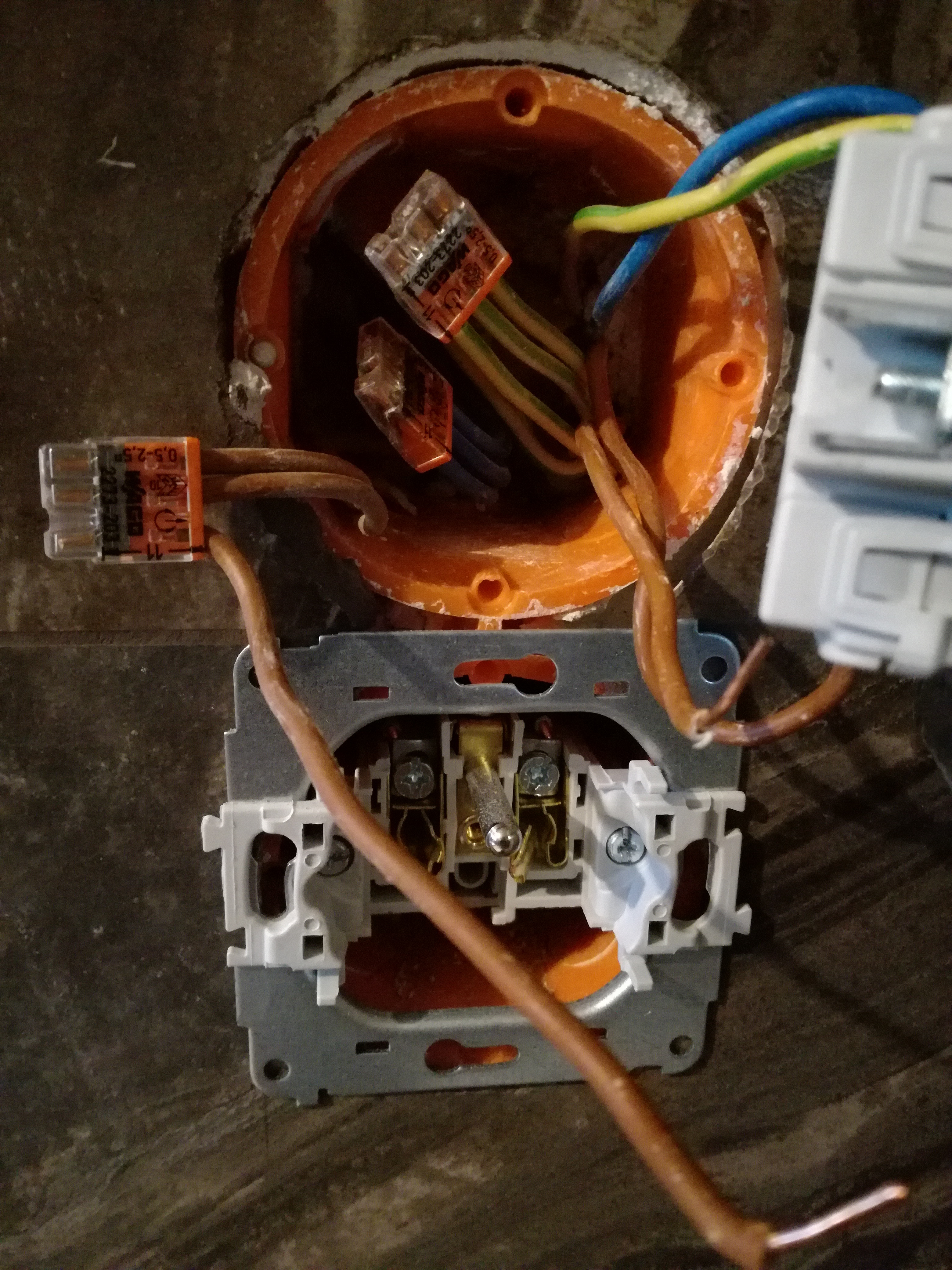

    This fourth wire, called here non-phase from LED lighting, I connected at the bottom as the photo shows next to the L terminal on the right
    As I can see there are five inputs (probably not all with contacts), I do not know which one you connect to, but connect to the extreme right of the connected one.
    I will ask, maybe idiotically, but whether the switch is two-button because you can't see it.

    So it is now connected at the bottom right, this wire is not in phase from the LED
    Yes, the switch is two-button

    I noticed one thing, as it is connected now, the stair switch also turns on the LED lighting, but first it will shine so dimly and in a fraction of a second stronger normally, However, if I shorten these wires, the LED lights up normally brightly.
    So, unfortunately, you have to replace the switch with another one, I found the right one from the series you have Karlik Deco -> http://sklepkarlik.pl/produkt,karlik-deco,dwp...cznik-podwojny-schodów-zmienny,kolor-bialy,71

    mawerix123 wrote:
    In this case, you can agree with the whole statement or not about the power supply, it does not matter in this case
    It does matter, you cannot have two phases in one gang box, coming from different circuits.

    adam998 wrote:
    Am I able to check if these two cables are powered from one source?
    Turn off the power supply of the passer-house circuit and check if there is voltage in the switch box on any of the wires.

    I turned off the circuit in the switchboard and there was no current on any wire.

    adam998 wrote:
    And there are such spells in the forest
    No magic, only boxless installation.

    Ok, that is, everything is clear new double stair switch.
