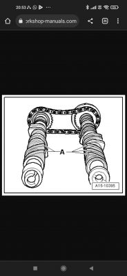

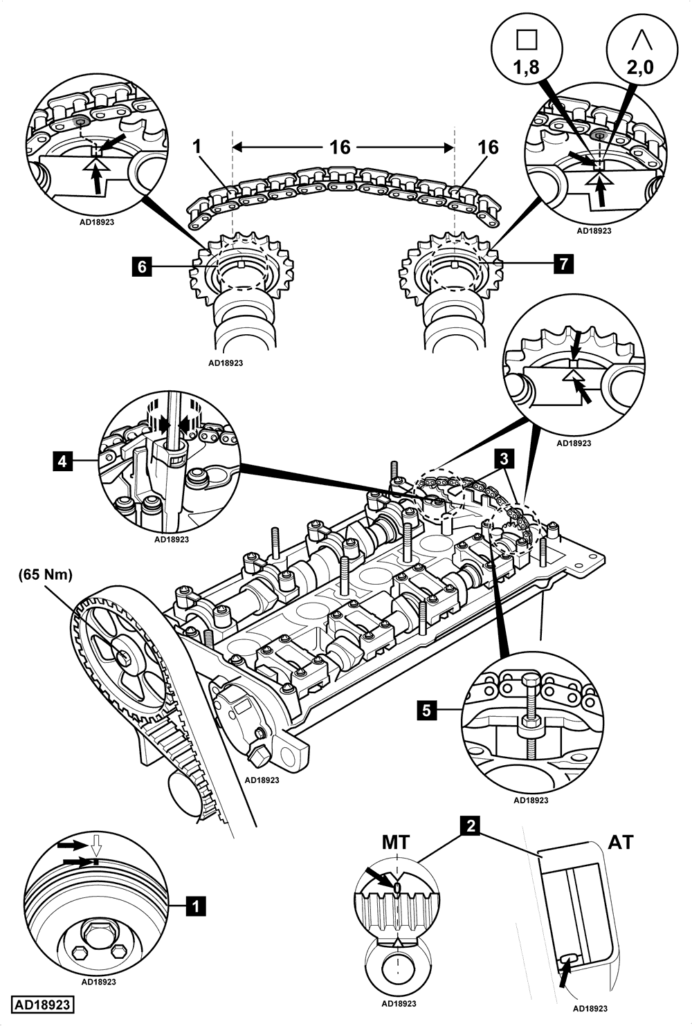

How do I set the camshafts and timing marks on a 2003 Audi A4 2.0 ALT engine when the head is off?
Set the ALT camshafts on the wedge/green timing marks, not on the arrow mark on the variator, and make sure there are 16 chain pins between the marks on the roller sprockets [#20396732] [#20406605] [#20407386] [#8153653] On the 2.0 20V ALT 96 kW, the camshaft wheel mark should be at 12 o’clock and visible in the window; if you do not have the original marks, use the proper locking tool for certainty [#8153570] [#8153285] Fit the timing belt in order a -> b -> c -> d, rotate the tension pulley counter-clockwise, lock it with tool T10008, then turn it clockwise, remove the pin, hold the pulley with an 8 mm key, and tighten the fixing bolt to 30 Nm [#8153570] After assembly, turn the engine two full revolutions by hand and verify the tensioner clearance is 6–10 mm; if it is outside that range, repeat the setup [#8153570]

    Does anyone have an exact diagram of setting the camshafts in the Audi A4 2.0 ALT 2003? I got a car with the head unscrewed and I don't know how to set the rollers exactly? Thanks for any hints.

    if it's the 2.0 20v alt 96kw
    you have a mark on the camshaft wheel at 12 o'clock and in the box window I send ins. installation or purchase of a lock for 100% certainty
    Check the timing marks Attach the tension pulley Attach the timing belt in the order shown in the picture a -> b -> c -> d Rotate the tension pulley counter-clockwise Attach the securing tool T10008 Turn the tension pulley clockwise Remove the securing pin T10008 Hold the tension pulley in in this position 8mmTighten the tensioner pulley fixing bolt 30NmTurn the engine 2 turns by hand Check the tensioner Measure the distance:6 - 10mmIf this is not the case, start the assembly operation again Reassemble in the reverse order of disassembly

    16 chain pins between the marks on the roller sprockets.

    That's what I really meant! :-) photo first class thank you all for your comments, thank you very much !!! Regards

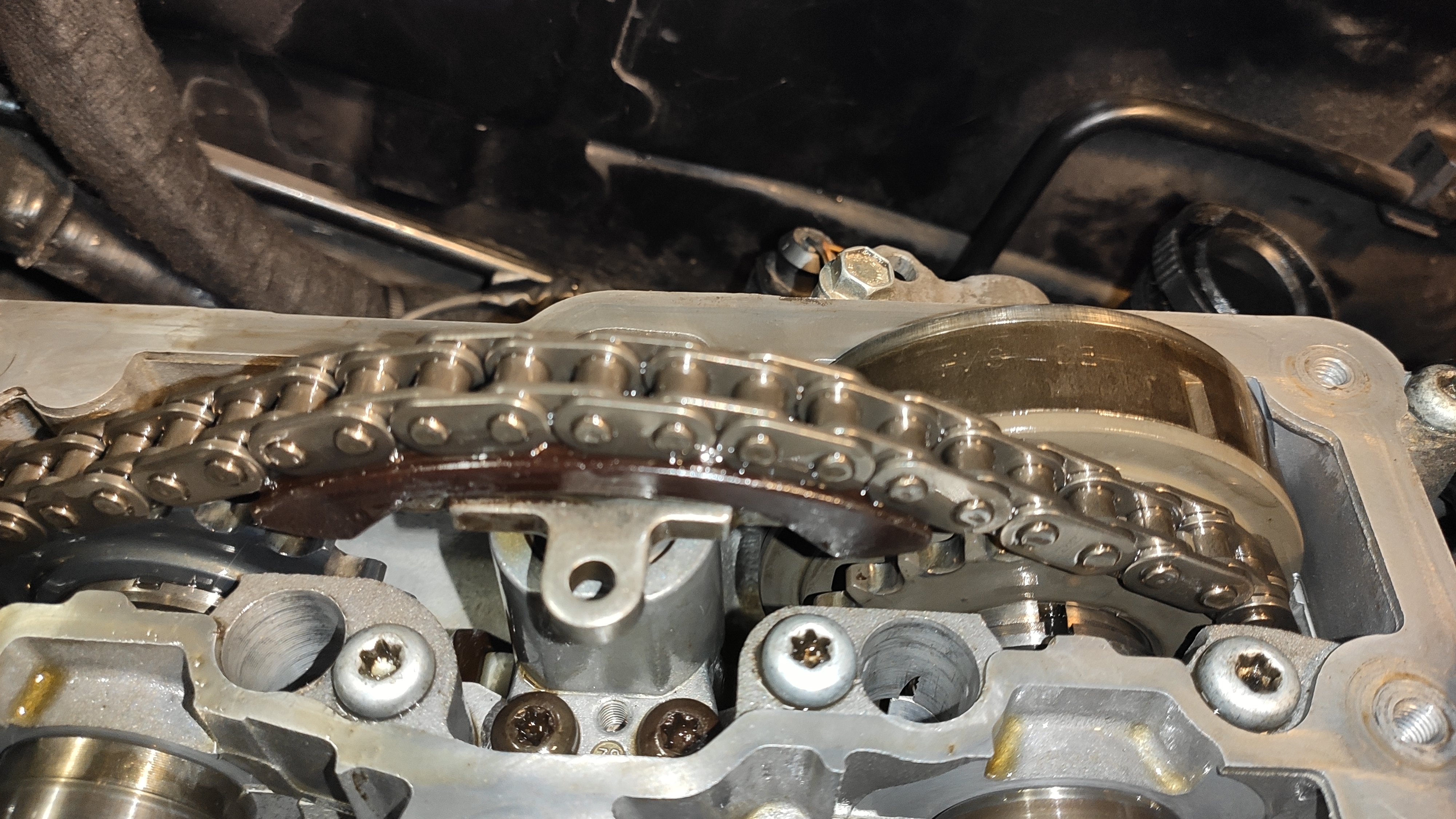

    I folded the fights as in the picture, plus a belt for marks on the shaft. Unfortunately, this setting does not allow me to start the car. No compression on the cylinders. Do you have an idea what I'm doing wrong?

    You have the rollers set wrong. There are supposed to be 16 chain bolts, you have 13.

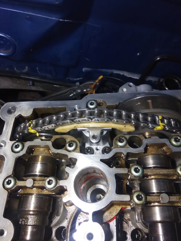

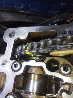

    I marked two places in the picture, should I set the separation on the red or green marks? because unfortunately there is a lot on these wheels Setting Camshafts in 2003 Audi A4 2.0 ALT: Looking for Diagram and Guidance markings.

    Greens.

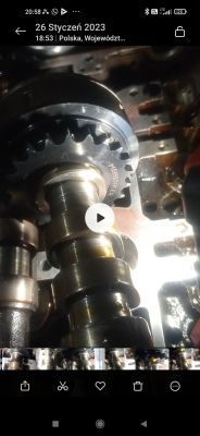

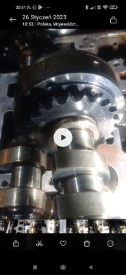

    buddy you have a bad sign on the suction shaft. You set it to the wedge, not to the arrow on the variator sprocket. The cams on cylinder 4 are probably at the top of the engine. The arrow is on the other side 180 degrees you need to turn the suction roller.

    The only correct setting is to set the rollers on the roller wedges. Setting the variator to the arrow results in a lack of pressure on one of the cylinders.
    The car works properly on the indicated settings.
    @majsterek12345 unfortunately you were right, I damaged 2 exhaust valves, the cost is not high but troublesome.

    Yesterday I did and not to cut under the variator wedge, only to the arrow on the variator.
    Setting Camshafts in 2003 Audi A4 2.0 ALT: Looking for Diagram and Guidance Setting Camshafts in 2003 Audi A4 2.0 ALT: Looking for Diagram and Guidance
    In order for the first cams to be in this position, we need an arrow or a triangle on the variator, as in the diagram 2.0 triangle
    And if you have two bent exhaust valves, you set the belt wrong, not the chain.

    Buddy, the thing about the engine is that if you set the belt wrong, the exhaust valves will break, the chain has nothing to do with it, because the exhaust shaft drives the belt, directly from the shaft, as the suction blows, it may be the fault of the belt or chain.
    The suction roller is to be to the arrow for a million percent, not to the wedge.
