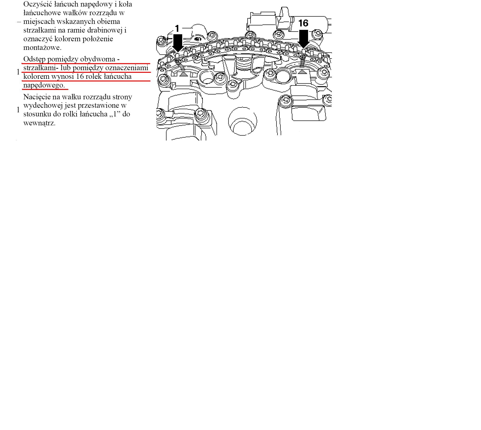

    Hello. I have an Audi A6 C5 with 2.0 engine on gasoline and ALT gas. How to replace the timing chain and align with the shafts.

    Use a new tensioner and new chain. The rest in the picture.

    Thank you for the diagram, it was very useful.
    I am asking for a timing belt fitting diagram for this engine (Alt).
    greetings
    Added after 28 [minutes]:
    I would like to receive detailed instructions on replacing the timing belt on an alt 2.0 petrol engine after breaking the belt.
