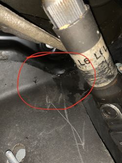

  • #13 13247026
    k4r0l3k84
    Board Language: polish
    Hello, I had the same problem Corsa C 1.3 cdti 3 door from 2005, water on the floor front and rear on the driver's side. I will write a short description of how I solved this problem. Each of you may have different causes, so I advise you to start by checking out some simple solutions. Firstly:
    1. I removed the carpeting from the entire floor (unscrew the front seats and remove the rear seat, seatbelt fastening, sills, plastic cover from the gearshift and handbrake, plastics on the left and right sides at the bottom of the wheel arches).
    2. I carefully cut out a part of the soundproofing sponge. (There was a lot of water, the carpet took a week to dry and the sponge took 2 weeks to dry at about 15C).
    Water was flowing between the clutch and brake pedals.
    Later:
    3. I unscrewed the wipers, the plastic cover from the windshield.
    4. From the inside, I disassembled and disconnected the brake pedal with the servo.
    5. And then we have access to the partition. There is a metal sheet (approx. 40cm x 40cm) screwed from the engine side with four screws. Sealed with silicone. At the bottom of the motor side, this silicone didn't seal well. And in my case, that's where the leak was.
    6. You have to unscrew these 4 screws and tilt the plate inwards, remove the old silicone halfway up the plate and put the new one and then press the plate with screws, remove the excess silicone.
    7. After the silicone dries, it is good to cover the joint with "paint", which protects the bottom of the car against corrosion. I currently live in the UK and bought a "Hammerite Underbody Seal" from Halfords store and the silicone I used was "Evo-Stik Liquid Metal".
    It is laborious, but nothing has leaked for a week. Only today will I install a sponge under the pedals and a carpet on the floor.

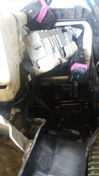

  • #15 16743481
    dgolf
    Posts: 380
    Help: 10
    Rate: 149
    Suggesting the above solution, without thinking, I closed the holes, but it turned out that my friend was raving like broken ... they are responsible for the drainage of water from under the computer box and there is no way for it to get inside. Blinding them will exacerbate the problem, as the water will not drain until it collects enough to flow into the central drain. Stupid work and waste of time.
    The fault is a rotten gasket on the computer cover. Water gets inside the box and when the car is started it is poured inside. The photos show how much it collects in the box. I decided to disassemble the entire piece, remove the water, sprinkle all joints with the preparation, and seal it with silicone. No one has visited it for 14 years, so it won't be soon. In addition, I plan to make some additional cover so that the water from the pit does not run down the casing.

    I also have a problem with the water on the rug. Just today I dismantled the car and took the cover off and in fact the seal was damaged and it was definitely the fault. And I have a question, can you buy such a gasket because it's hard on the net or what to replace it with? thanks in advance

    Today I also took out this whole computer cover and the gasket is degraded. I sealed it, we'll see.
    Naturally, the water was in that box.
