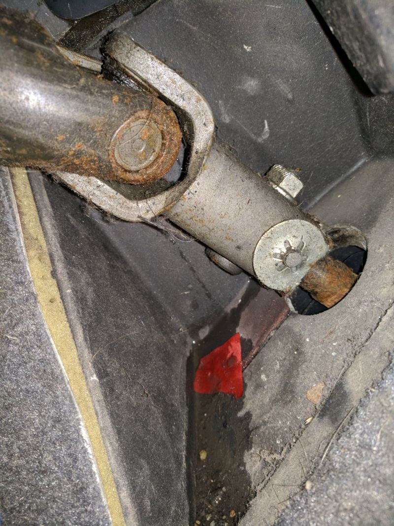

    Hello, I have had a damp under the doormat for some time.
    Initially, I thought that the water from the doormat spilled out, but today, on the occasion that it is raining, I decided to check where it was coming from. And I found it.
    Photo with marked place in the attachment.
    Anyone have an idea where to look for a leak under the hood? Corsa C - Water Leak at Accelerator Pedal: Damp Doormat, Leak Source & Under Hood Search

    Hello. Dismantle the pit and clean the drainage channels in the corners.

  • #5 16609942
    mario 77
    Posts: 510
    Help: 66
    Rate: 335
    Examine the sheet metal (fastening) in the bulkhead wall under the master cylinder and servo. You can pour water gently and then see from the inside if it gets wet.

    Standard leak under the service.

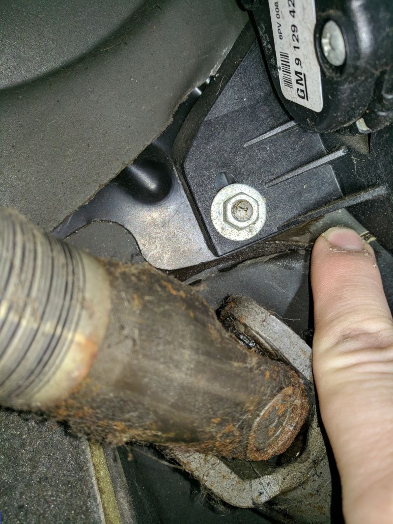

  • #7 16623623
    Coremeil
    Posts: 391
    Rate: 83
    It also seems to me that it is leaking somewhere under the serve. Where exactly to look for leaks?
    Can you somehow seal the place under the servo without removing the pump?
  • #8 16623991
    dabu
    Level 32  
    Posts: 2046
    Help: 190
    Rate: 695
    The servo must be unscrewed.

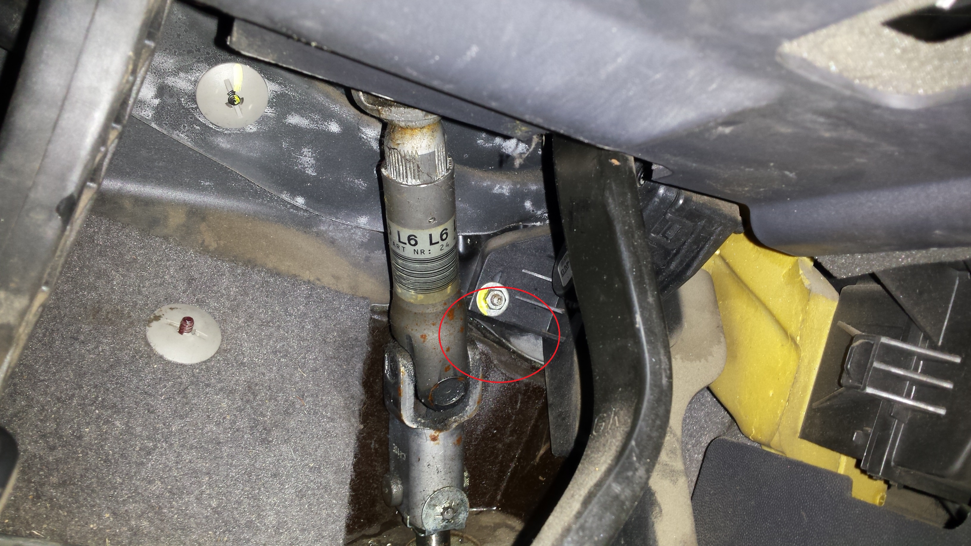

  • #10 17553358
    wikara23
    Posts: 42
    Hello, I also have a problem in the corsie c, the sponge leaks behind the brake pedal, it is wet and it flies onto the carpet. I located the problem today and haven't done anything yet. I am already reading a bit and I read that the first is to unscrew the fuse box in the shaft. Anyone else suggest something? Corsa C - Water Leak at Accelerator Pedal: Damp Doormat, Leak Source & Under Hood Search Corsa C - Water Leak at Accelerator Pedal: Damp Doormat, Leak Source & Under Hood Search Corsa C - Water Leak at Accelerator Pedal: Damp Doormat, Leak Source & Under Hood Search Corsa C - Water Leak at Accelerator Pedal: Damp Doormat, Leak Source & Under Hood Search

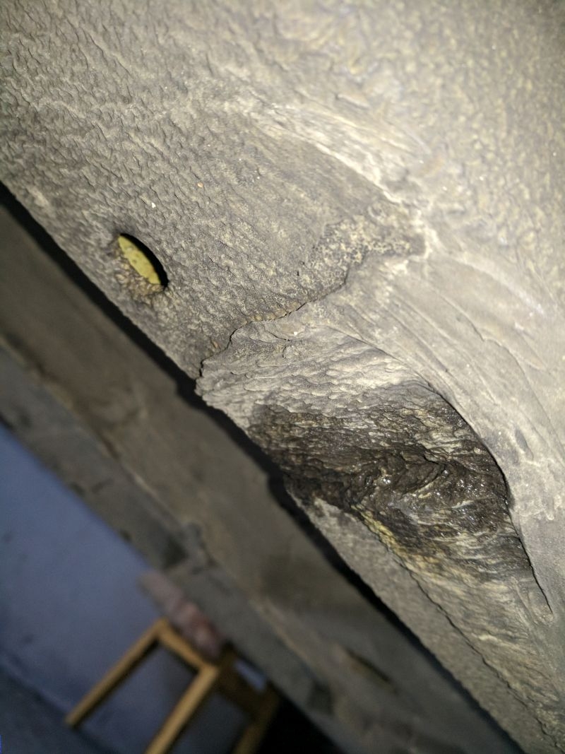

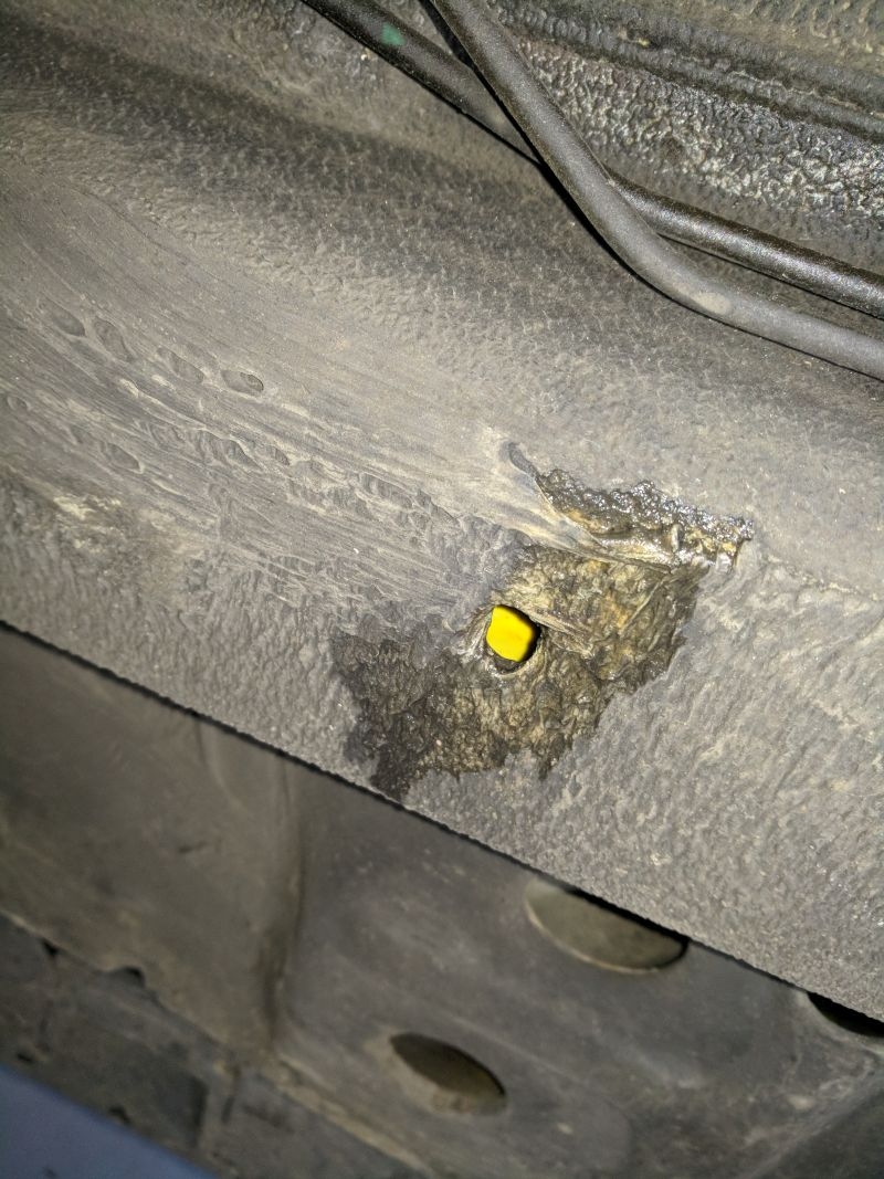

  • #11 17553734
    Coremeil
    Posts: 391
    Rate: 83
    I had the same. Probably the seal is leaking from the connection with the body of the element to which the power steering is bolted
    It has the consistency of plasticine / chewing gum. A bit of putrid muck will collect there and after a while a small hole is formed through which water flows through.
    I removed this mass and glued it with a sealing compound for roofs. Since then, it's been dry under the rug.
    And earlier it was flowing so that even when pouring water from a bucket, you could see a stream at the brake :D
    Overall, it is a bit of work and you have to be careful not to bend the brake hoses in any way so as not to weaken them. (need to disconnect the master cylinder from the power steering)
    There are demonstrative videos on the internet. :)
    However, if someone has such a problem and does not know how to do it, I recommend going to someone who knows you, because safety is the most important thing.
