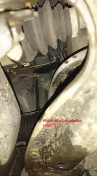

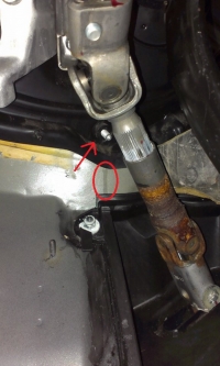

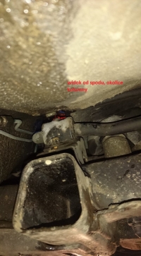

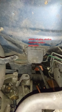

    There is progress in the matter. I dismantled the entire driver floor covering again. One and a half hours of sprinkling water on the car and leakage visible in the picture. Between the partition and this black element there is a space thanks to which it is possible to determine on which section it is wet. I felt that the leakage of water is at the height of the screw shown in the picture.
    Do you have any ideas on how to go about making the replacement of the seal relatively simple? I looked at the car from above and below and unfortunately I do not see the place where this element could be screwed as it is for example from a fuse box under the glass.
    I am sending photos of the leakage area.
    (The steering column rusty from the moisture that it absorbs with the sponge covering the column - It is not in the picture, so please do not suggest that it is leaking with the column)

    #6 16619528
    mario 77
    Posts: 510
    Help: 66
    Rate: 335
    To remove sheet metal under the servo in the bulkhead wall and re-assembly with silicone or glass adhesive.
  • #7 16619599
    LadyMasha
    Posts: 24
    Rate: 10
    The question is how to disassemble this plate? Where to start? Do you see where the metal sheet is screwed on from the outside pictures that I sent?
    Added after 10 [hours] 19 [minutes]:
    I dismantled the entire pit to get to the above sheet. The entire sealing around the serva looked good so I didn't turn it on. I tightened all the screws of the plate that were not particularly tightened ... I think tightening should solve the problem. In addition, I sealed the entire joint around the outside of the car with automotive silicone to seal the engines. I submit the car and wait for the first rain. I recommend that everyone looking for a solution to a similar problem start by dismantling the interior and carrying out a water spray test.
