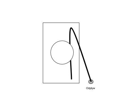

    My washing machine drain is placed very low (basically at floor level, no idea who came up with it), the effect is that water is lost from the washing machine while washing. Is there any way to solve this problem without breaking down the walls and raising the drain?
    Ps. Just raising the hose higher at the back of the washing machine does not help because it is already routed by the manufacturer to the very top, but since it is usually full of water, the effect is when draining the fuel - water still flows....

    You need to raise the hose higher (above the water level in the washing machine - to create a so-called siphon)
    This hose is already raised to the maximum by the manufacturer, it looks like this:
    How to Connect a Washing Machine to a Floor-Level Drain Effectively?
    ...but it is often filled with water and then the effect mentioned above appears, as when draining fuel, the water still pours out. If I missed something, I apologize in advance!

    You extend the sewer riser outside the wall (elbow and pipe section). At the upper end of the pipe, put a tee ("T" turned 90 degrees). You connect the washing machine from the side (e.g. through a washing machine siphon, because it`s easier). There is an air valve at the top of the tee.

    The drain simply does not vent.. When it gets sucked in, it flows like wine from a balloon.. Insert the pipe into the drain and raise it to 60 cm. The pipe must be wider than the drain hose, preferably 50 cm.

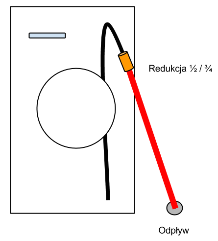

    Problem solved, I bought a hose with a larger cross-section than the one for the washing machine, connected them with a 1/2 to 3/4 reduction with external threads and everything works fine :)
    hmm, what difference does it make, I don`t understand?

    Water doesn`t escape :)
    ...but seriously, think about whether you would be able to drain the fuel from the tank with such a hose with an "adapter"? No, because there will always be some air in the "wider" hose, the narrower one cannot fill it.
    Ps. More details on Wikipedia( Hydraulic jack ): "...the condition for the operation of the siphon is to maintain the continuity of the stream, and therefore the siphon must be completely filled with liquid (initiating operation by suction or pouring)..."
