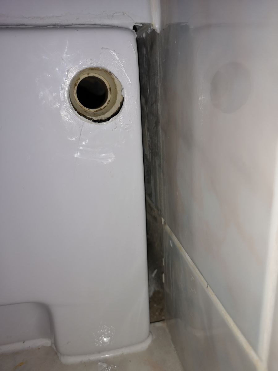

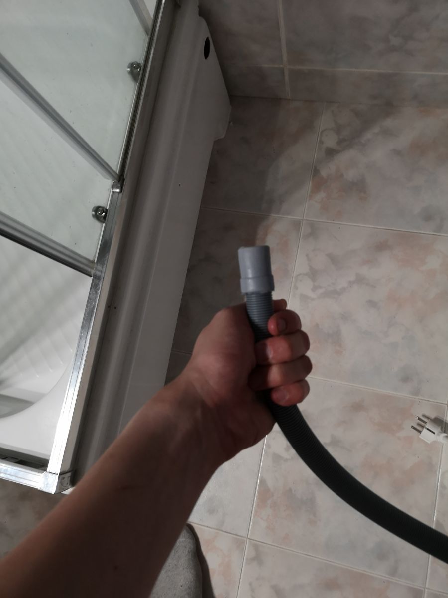

    Hello, I have a problem with the drain from the washing machine, I moved into an apartment and the drain from the washing machine is probably connected to the shower, I have a hole for the drain in the shower tray practically on the ground and the question is whether such a connection will be OK or whether it will not drain water. I would have the drain next to the washing machine on the highest hook, and then it goes practically to the ground (an inverted "U")
    appearance similar to picture no. 2/5 https://obrazki.elektroda.pl/11_1284637226.gif
    DRAIN IN SHOWER TRAY BELOW.

    The first wash cycle will go without a problem, but then eggs will start to form and you will waste a lot of water!

    This is what I`m afraid of, that a lot of water will escape, I have the drain hose from the washing machine as above, but the water drain is at the ground.
    Added after 49 [minutes]:
    After talking to a plumber friend, he said that it would be best if the washing machine hose was suspended on hooks above the drum, and the drain hose into the sewer could lie on the ground.

    This plumber`s advice is nonsense! You will find out during washing, just watch how it wastes water. The wash will finish, and if you start with the first one, the main wash will be done in the remaining powder.

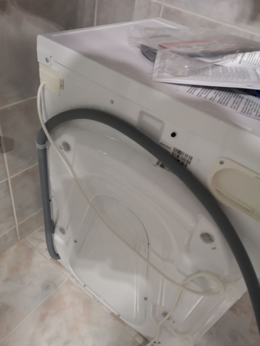

    The plumber`s advice is good. There is no way water will leak from the washing machine. Gentlemen. For this to happen, there had to be water in the hose, in the entire hose, and it would normally not be there. The water comes up to about half the height of the washing machine. I have a drain in the floor and nothing escapes me. Mercy.
    It just has to be suspended as in the photo.

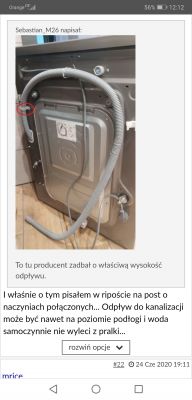

    How does a siphon work? In new houses and after renovation, drains are made low, and washing machine manufacturers or those installing the washing machine ensure the appropriate height.

    This lever also sucks. I flooded the laundry room twice because of a crappy washing machine. If the pump does not pump out, not much will leak out, despite the lever. But now I have a new one. Bosch😁

    So I can make the drain hose on the washing machine as in the photo above, i.e. at the top above the drum, and the drain to the tub can go through the ground?

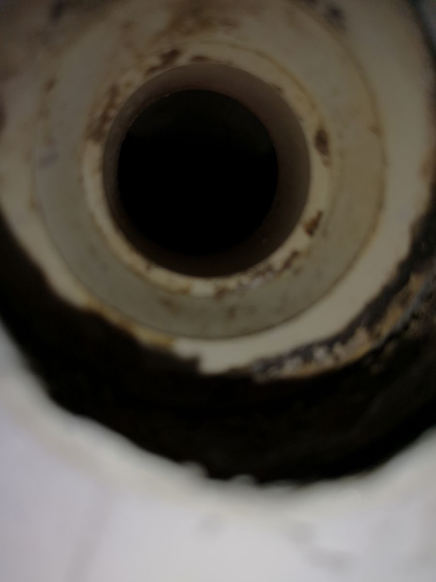

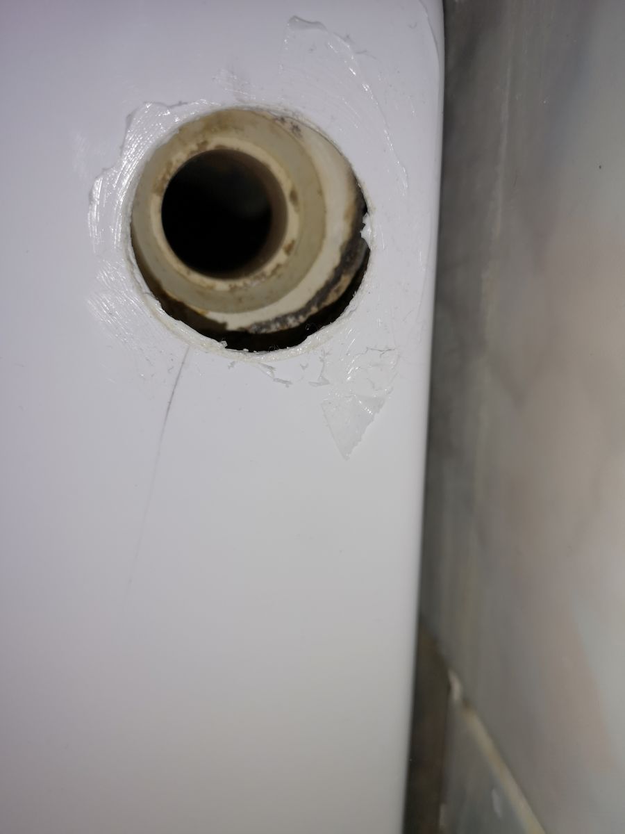

    Guys, the diameter of the drain into the sewer is smaller than the diameter of the hose, I can`t insert it...

    New apartment, otherwise there are drains and I didn`t get the right information from the owners... I`ll keep trying, guys, thank you very much for your help ❤️❤️

    The pipe into which water from the hose is to flow must have a larger diameter than the hose, and not be pressed and sealed. Because it will become an extension of it with all the consequences in the form of wastage of water and detergent, i.e. washing efficiency.

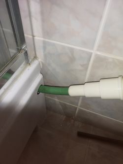

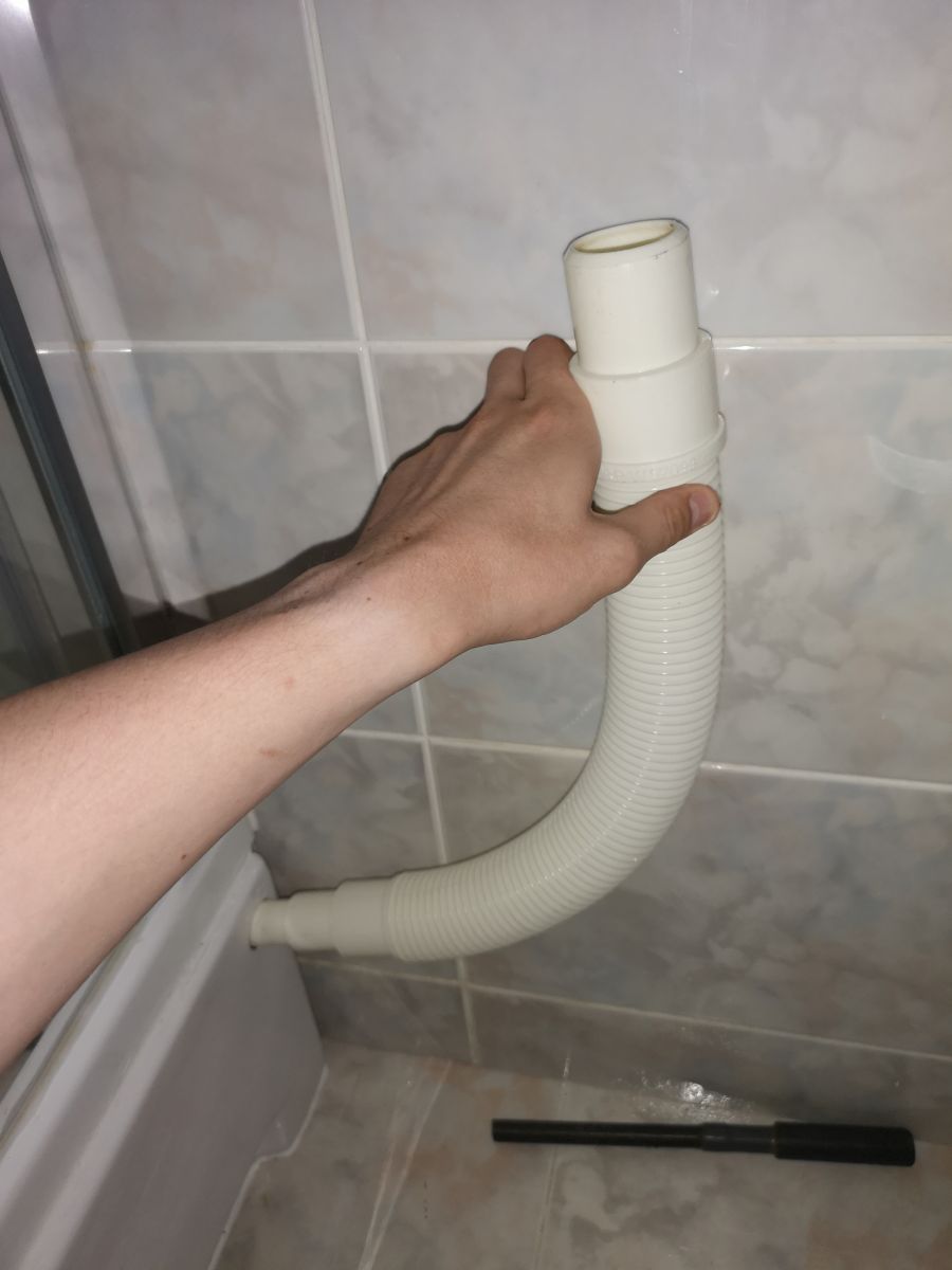

    Guys, I came up with something like this, I put a hose that fits almost perfectly into the drain, I connected the hose to the pipe and the 50 goes up, it will be attached to the wall. Will he pass the exam?
    Washing machine drain connection - Washing machine drain problem Washing machine drain connection - Washing machine drain problem
  • #30 18838391
    wojtek1234321
    Level 36  
    Posts: 3554
    Help: 306
    Rate: 1133
    If it doesn`t leak at the joints, it may pass the test. Apart from the fact that it may be a bit of a nuisance on the wall and look nasty, and maybe "stinks" from the septic tank may escape through this pipe...
