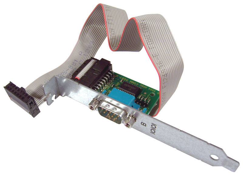

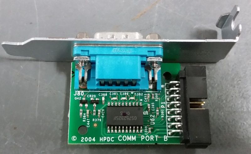

    As for the COM2 port, the connector is not yet recognized, but it seems to me that there is a TTL level signal, because I found such an adapter on the network:
    Connecting LPT Printer Parallel Port (D-SUB 25x1) to HP Model 6000 Pro Microtower VN784EA Connecting LPT Printer Parallel Port (D-SUB 25x1) to HP Model 6000 Pro Microtower VN784EA
    So the classic driver for RS232.
    Maybe it will help someone.
