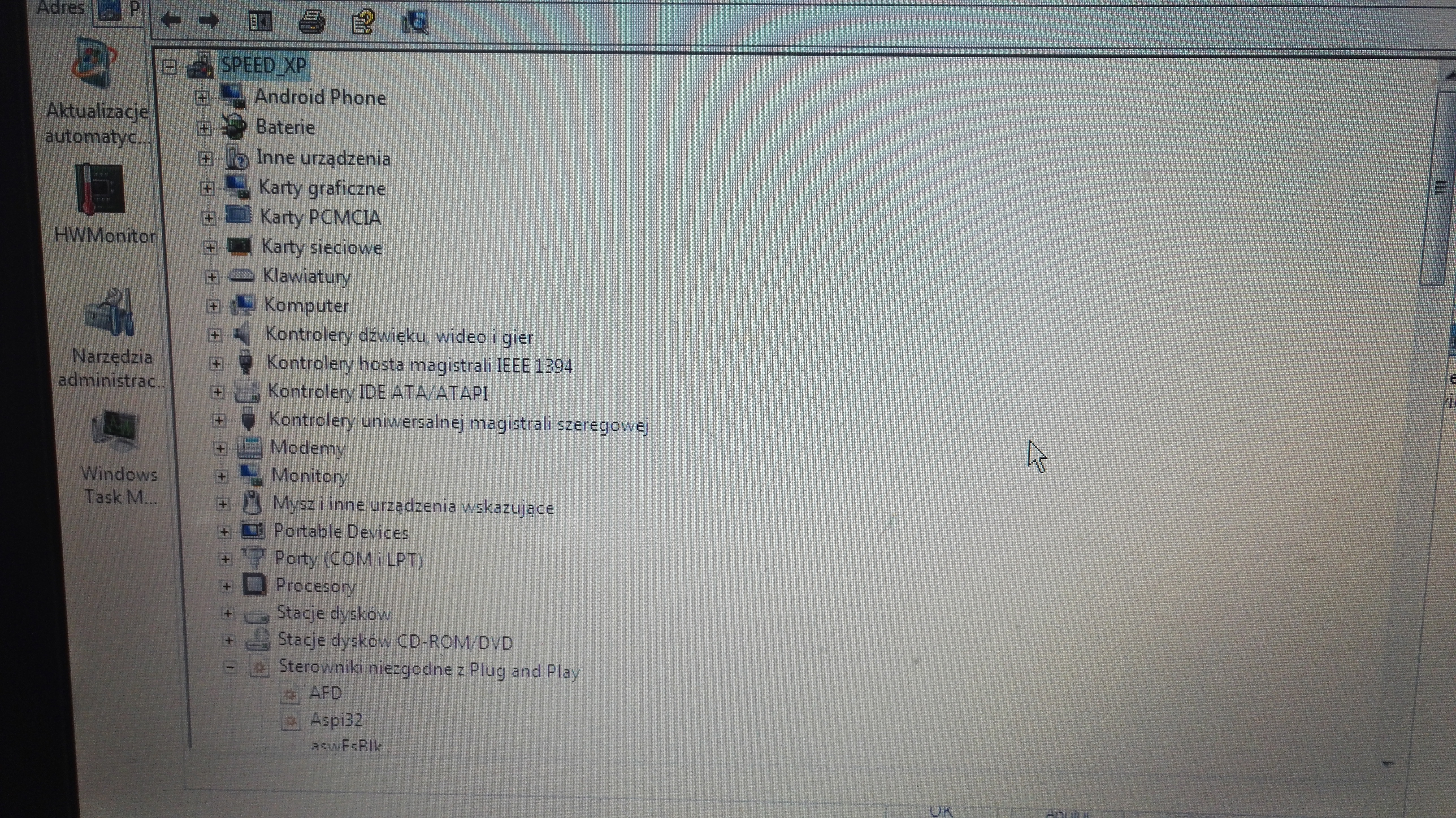

    Hello, as in the subject I have the Vag kkl interface, car diagnostics and it only uses COM1, COM2, COM3, or COM4 ports and needs one of these ports to choose, but I can't because I don't have it in the device manager, I don't know if this laptop or windows fault. My equipment is Sony PCG-7Y2L with Windows XP installed.
  • #2 16917104
    Ture11
    Posts: 5421
    Help: 573
    Rate: 1130
    Show the screenshot from the device manager - the interface probably has no driver installed, after a correct installation a virtual COM port should appear.
  • #3 16924231
    Noras14
    Posts: 7
    Sorry that so late but I didn't have the answer when here is a photo.
    • Port COM1-4 & LPT Missing in Device Manager - Vag KKL, Sony PCG-7Y2L, Windows XP Issue IMG_20171230_143551.jpg (9.14 MB) You must be logged in to download this attachment.
  • #4 16924236
    Kasek21
    Posts: 45667
    Help: 4981
    Rate: 3548
    After all, the ports are detected in the Manager.

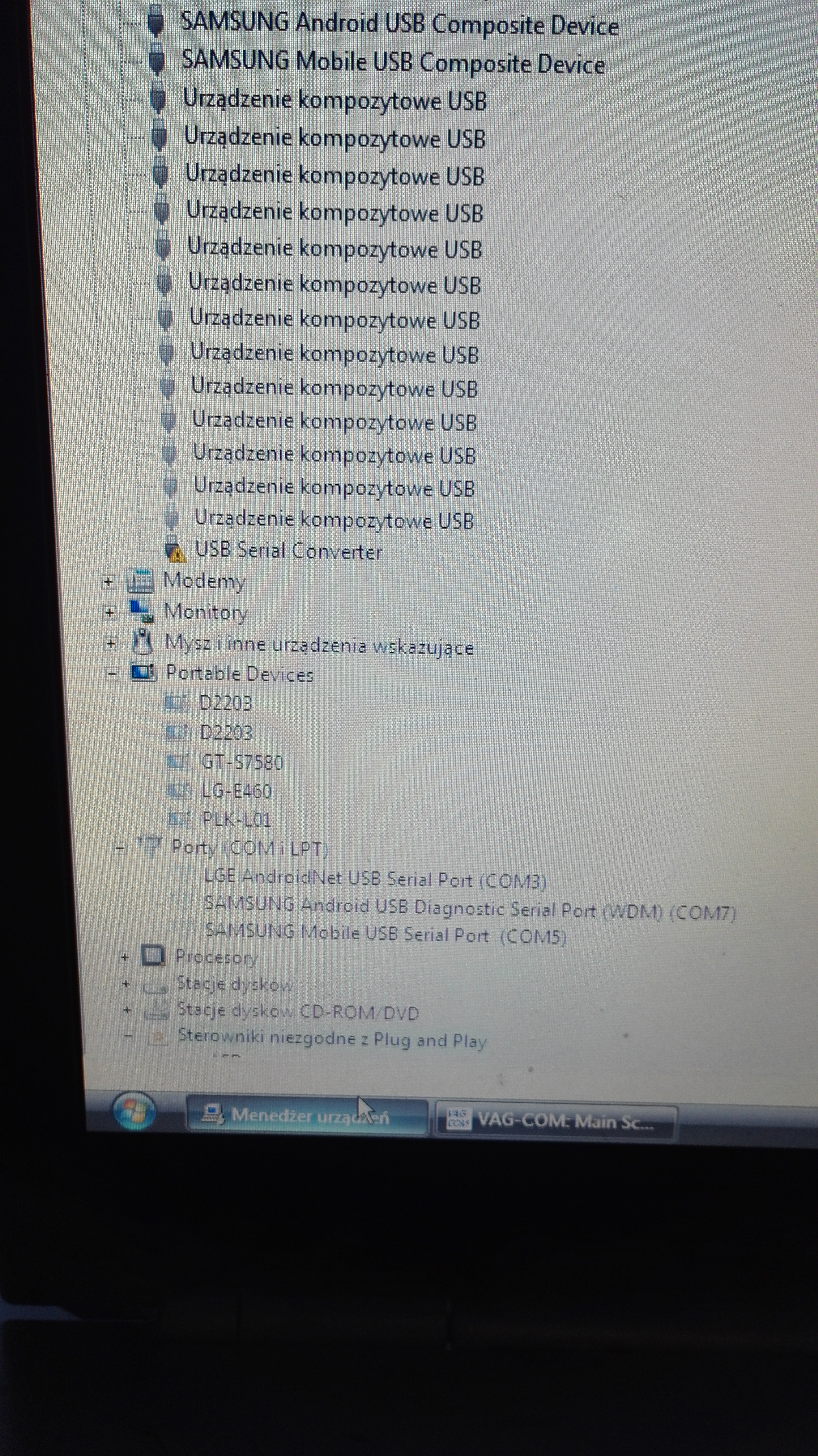

    Noras14
    Posts: 7
    Now there are ports and before they were gone I don't know why.
    Added after 46 [minutes]:

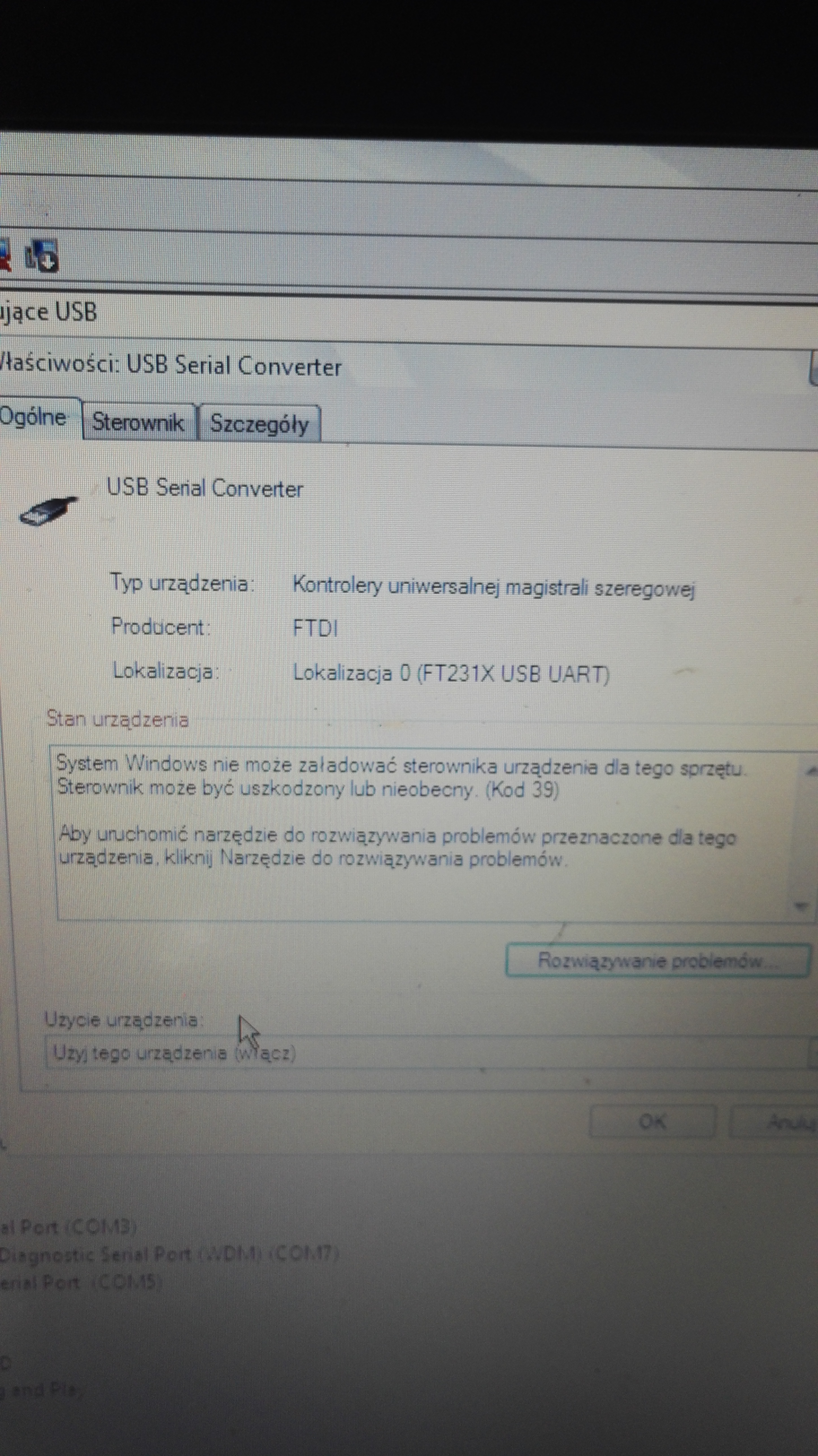

    Yes, only now I have ports in the manager. But when I connect the Vag kkl cable I can't see it in the ports and in the USB serial converter an exclamation point pops up.

  • #9 16924360
    Ture11
    Posts: 5421
    Help: 573
    Rate: 1130
    Then see the properties of this exclamation mark - what error does the computer give ...

  • #11 16924379
    Noras14
    Posts: 7
    The manager can already see the ports.
    And I have drivers installed.
    • Port COM1-4 & LPT Missing in Device Manager - Vag KKL, Sony PCG-7Y2L, Windows XP Issue 1514645366867-420012848.jpg (5.39 MB) You must be logged in to download this attachment.
  • #12 16924383
    Kasek21
    Posts: 45667
    Help: 4981
    Rate: 3548
    This is not about ports on the computer because they are emulated anyway.

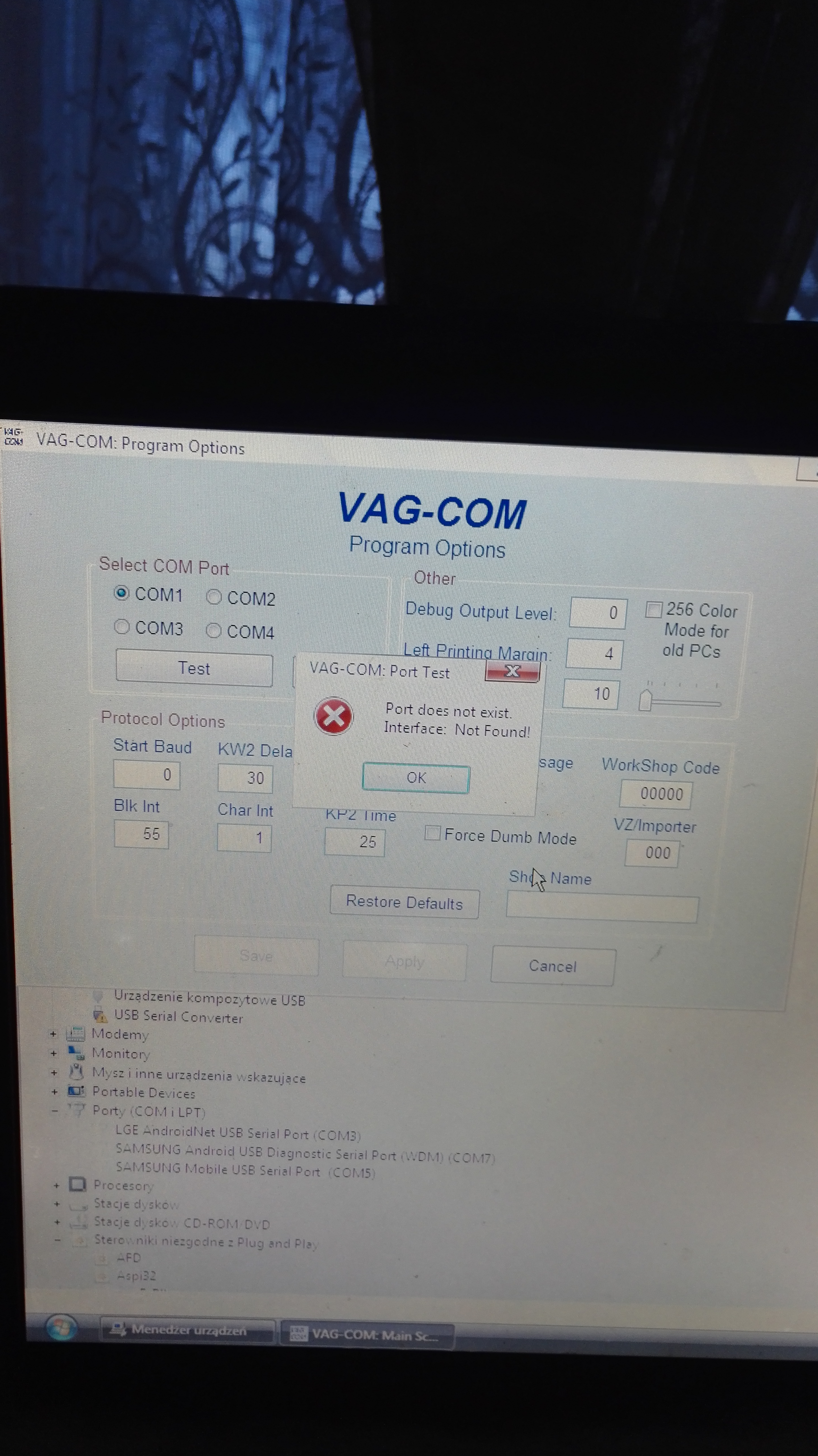

  • #13 16924393
    Noras14
    Posts: 7
    I chose each of the ports and after clicking the test error with the port
    I understand the interface must be connected to the car but the port should write ok because it was on a friend's laptop.
    • Port COM1-4 & LPT Missing in Device Manager - Vag KKL, Sony PCG-7Y2L, Windows XP Issue 1514645479671-1747170298.jpg (4.71 MB) You must be logged in to download this attachment.
  • #14 16924420
    Kolobos
    IT specialist
    Posts: 85182
    Help: 17174
    Rate: 10460
    You need to install the drivers for the converter, only then you will have a com port with vag, which you must select in the program.
    Enter the ID of this "USB Serial Converter" from the manager (PID and VID).
  • #15 16925013
    Noras14
    Posts: 7
    The topic can be closed already everything works.
