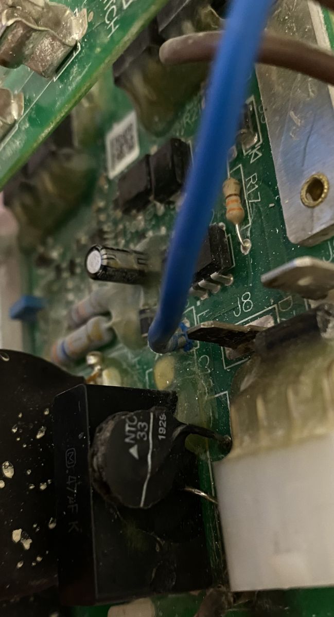

    Hello!
    I have a card with NTC 33 and it's damaged NTC 33 I want to replace it but I can't because in my country I can't find it.
    How can I replace it with an equivalent?
