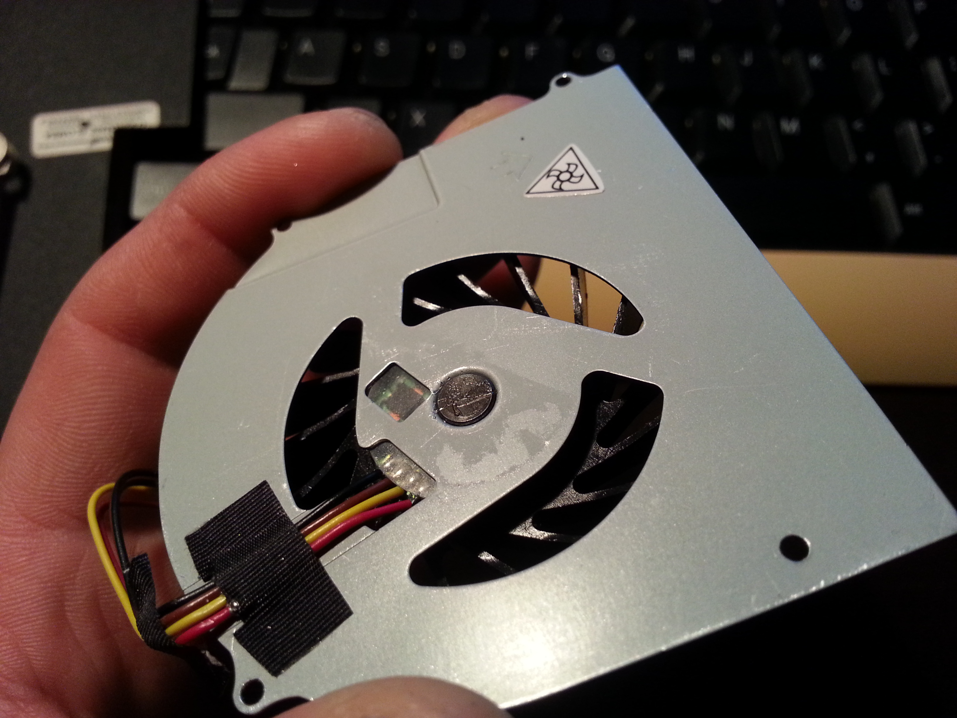

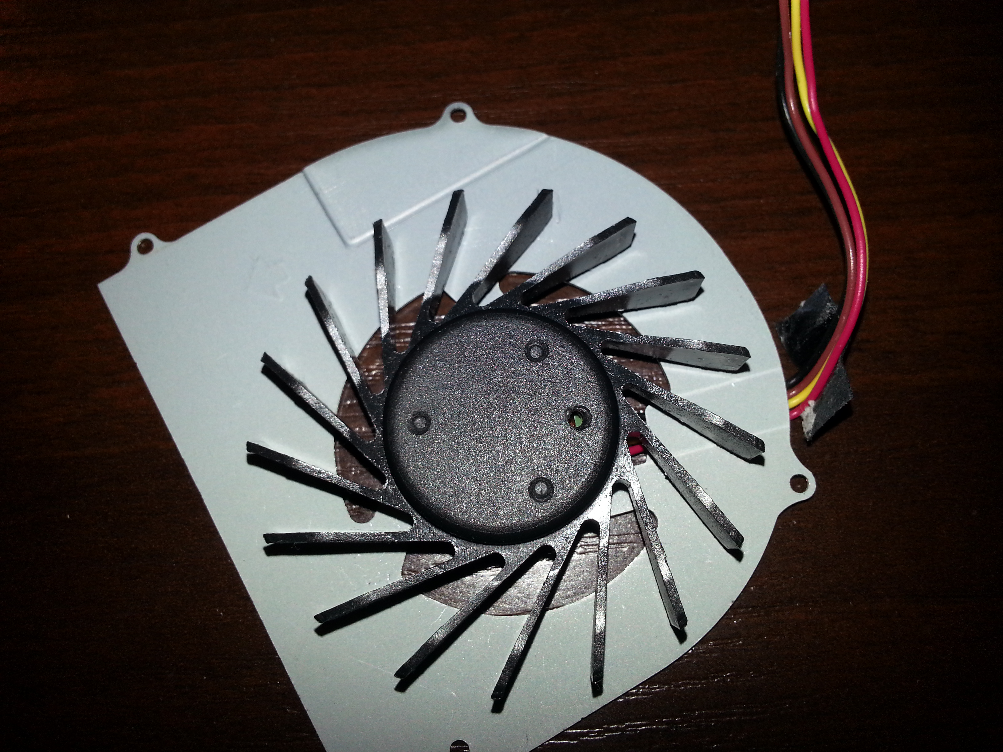

    I have a problem with the fan in the lenovo g770 lap, namely I have cleaned the cooling system prophylactically, etc. I put everything as it should be and the fan started to tickle me, I wanted to lubricate it, but unfortunately I have a problem with taking it apart, please help, I put pictures of the fan.
    Regards.
    https://obrazki.elektroda.pl/8985361200_1387395375.jpg
    https://obrazki.elektroda.pl/1016183300_1387395380.jpg
    https://obrazki.elektroda.pl/7406182100_1387395384.jpg

    You probably damaged it, replacing the fan in your case.

    Probably not because normally it works, it just spins like that. And anyway, as if I could damage it as soon as I cleaned its dust from its blades.

    By doing so, you have unskillfully destroyed the fan. It's only eligible for replacement now, I've been through this before.

    I have already cleaned such fans is my first time and the best thing happened to me in my case :D , nom but nothing I have struggled with him for a long time today and I made him for as long as it remains to be seen :) I will be looking for a spare just in case.
    So thanks so much for the information everyone.
