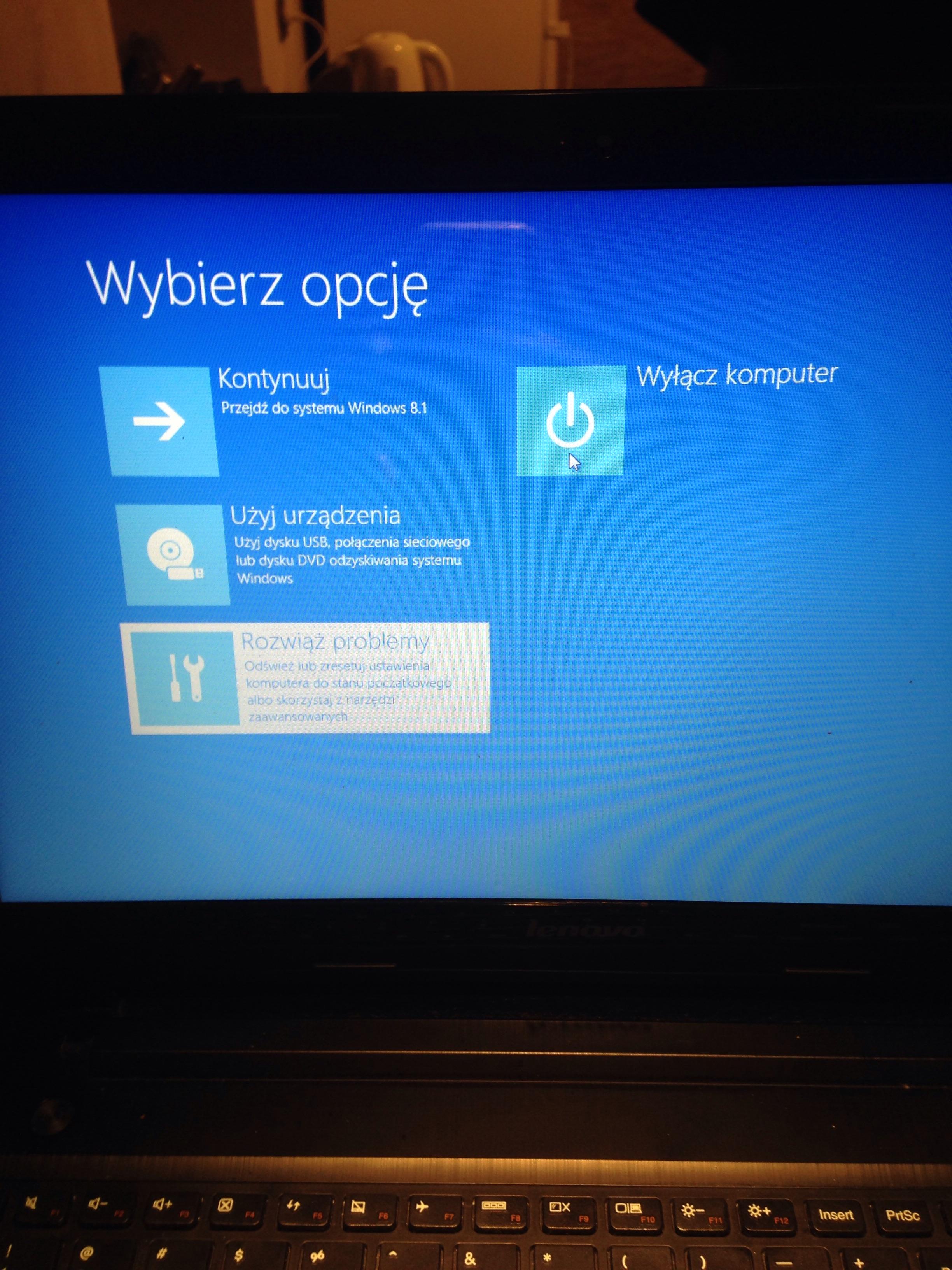

    Hello, my laptop does not want to start, after turning on, the computer diagnostics pop up immediately, which lasts a long time and at the end a message is displayed that it has encountered a problem over and over again. It does not respond to any commands, I wanted to do recovery but also does not respond to buttons
    • Lenovo - Laptop diagnoses all the time and then an error pops up IMG_0181.JPG (713.17 KB) You must be logged in to download this attachment.
    There (in this message) should there be information about the problem?
    Not necessarily.
    Probably at least corrupt system files, and at most a damaged disk.
    @Orzeszkowe sweep SMART from bootable MHDD.

    now it displayed after an hour of diagnosis
    • Lenovo - Laptop diagnoses all the time and then an error pops up image.jpg (928.97 KB) You must be logged in to download this attachment.
    And if you give "restart" then "diagnose" again?
    Will we get to know SMART?

    Orzeszkowe wrote:
    And you can't enter the bios
    At 100%? If so try to enter the BIOS after disconnecting the disk. One more sign indicating a disk.

    I went into advanced options from the previous photo but it doesn't respond to any clicks even
    • Lenovo - Laptop diagnoses all the time and then an error pops up image.jpg (776.85 KB) You must be logged in to download this attachment.

    safbot1st wrote:
    It just can't be restarted because it doesn't respond to anything

    As I wrote - you need to try to disconnect the disc. Ba. It's best if you took it, connected it to another computer and gave it SMART already. Use Crystal Disk Info.
    Try to have 1 RAM chip for a change. If it does not help - replace the bones.
    I hope you do all this with the power supply connected.
    Is windows 8.1?
