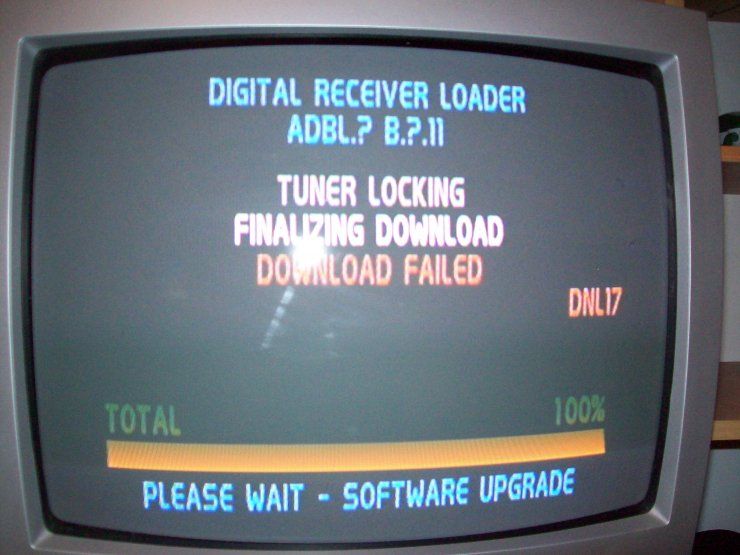

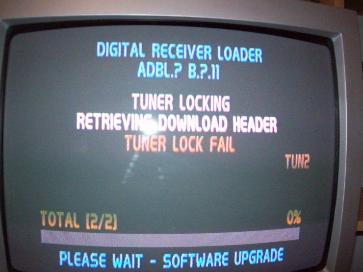

    Interruption of the upgrade operation in the download phase of the software file does not result in anything special. Only in the recording phase of the fully received software, turning off the power will cause the nbox to remain without the main software. This is your case.
    Then the "Loader" (in a separate flash memory) finds the lack and starts an attempt to download from the satellite, and then to save the software, which in effect restores the full efficiency of the decoder.
    If the nbox receives a poor quality antenna signal, the software download fails (due to reception errors). Then it is necessary to disconnect the power supply and switch it on again (sometimes several times). This is a source of faults.
    First, improve the quality of the antenna signal!
    The drive must be identical to the factory-installed drive in terms of capacity and manufacturer.

    Well, you fell into a mess and devilish types of cards.
    I will add that the nbox had a damaged HDD. It behaves the same with the new disk and without the disk.
    Who told you to rummage through the equipment? Now just look for a good APS point so that they "do not notice" the broken seal. Or pay...

    camil9 wrote:
    Today, the tuner has been connected to the sat installation with very good range and quality. Unfortunately, it failed to update. Still the same problem :(
    I searched and read a lot.
    Did I understand correctly that you put another drive into this nbox? And what about him? with this disc? Wasn't it password protected by nbox? Can you still use it on PC?
