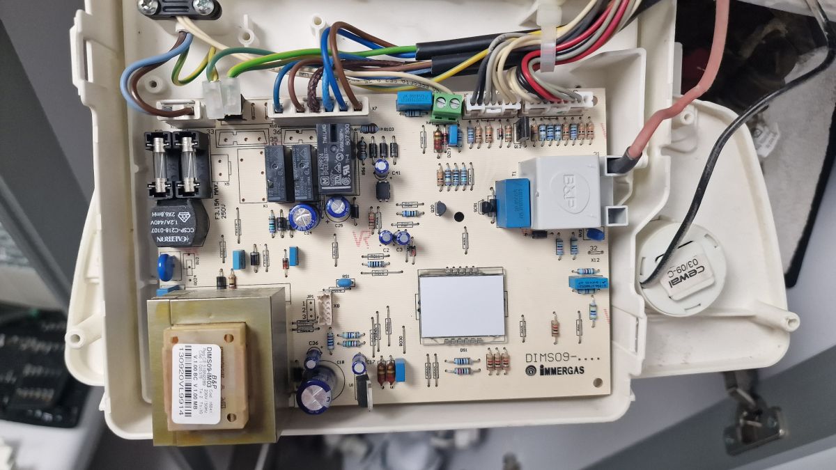

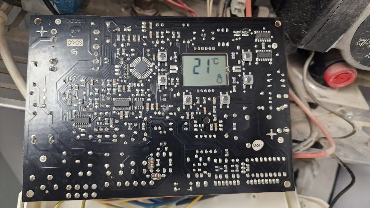

  • No voltage from board to fan on error 11
    #24 21120626
    elekam2
    I'm having a problem with error 11, Immergas EOLO STAR.
    In my case it looks like an electronics problem, but I don't know how I can check it exactly.
    I am an electrician, not an electronics technician, but with your help it might be possible to diagnose specifically what the problem is.
    I have checked the patency of the hoses from the pressure switch and the fan itself (they look ok).
    There is no voltage coming from the board to the fan.
    Attached is a video of what happens when I turn the hot water off.
  • #25 21120641
    zales.vip
    Posts: 1179
    Help: 191
    Rate: 589
    Replace the relays. And preferably the capacitors at once.
    All electrolytes.
    Replace all components 1:1 with EXACTLY the same ones.
    If you are not proficient in soldering, contact an electronics technician.
    The Immergas circuit board is a little fragile and it is easy to chip the tracks.
  • Need to confirm board fault before replacement
    #26 21120678
    elekam2
    Thank you for your quick response.
    But that doesn't solve the problem of the cooker not working on Sundays ;-(
    I am sending a picture of the board.
    PS. You can hear the relay ticking after turning on the hot water.
    I don't think I'm going to do it myself, even though I'm good at soldering, it's a time-consuming task to gather parts etc.
    I'm pressed for time, so I can either buy new or reconditioned electronics. (How much does it cost to remanufacture such electronics?)
    Close-up of an Immergas boiler circuit board with visible wiring and components. Image of an electronic circuit board with a display showing a temperature of 21°C. .
    I would like to be sure that this is the fault of the board and not some other component of the cooker. That's why I asked for help in diagnosis.
  • #27 21121124
    zales.vip
    Posts: 1179
    Help: 191
    Rate: 589
    The relay "ticks" but if you open it and look at the contacts you will understand.

  • #29 21695038
    raks0
    Posts: 791
    Help: 258
    Rate: 450
    Yes, the fan is powered by 230V AC. Here you have the relay from the fan marked
    Electronic board with fan relay for 230V AC highlighted in red .
  • #30 21695639
    thuug
    Posts: 185
    Rate: 11
    Is there a motor starting capacitor under this relay ? Or does it need to be focused on ?
