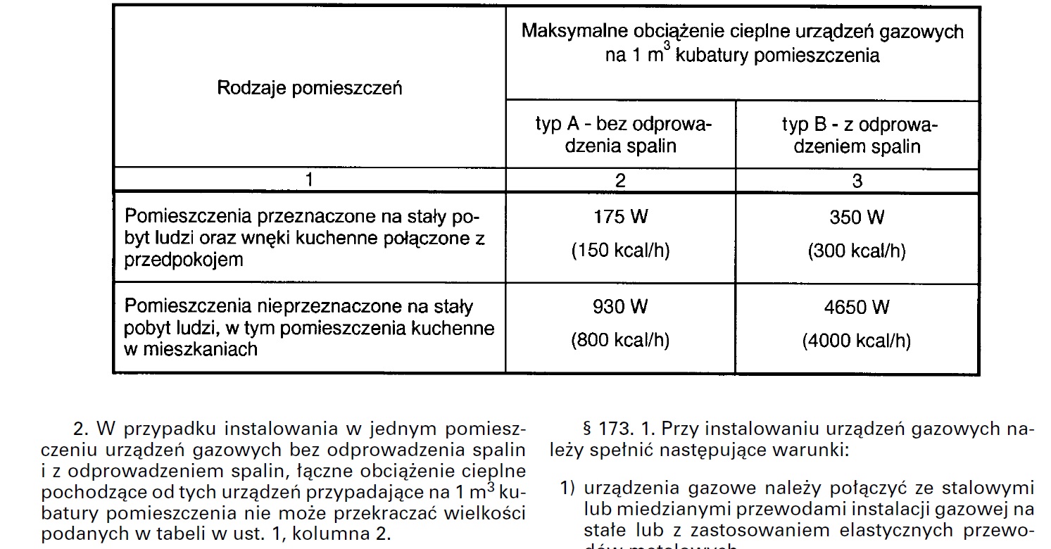

    unitral wrote:
    ... The stove has to be moved because the bathroom volume is less than 8m3.
    There is a solution: install a thermal bath with a closed combustion chamber. Then the conditions change and only 6.5 m3 are needed
    In the kitchen, you may not be able to install it too. There are other regulations regarding cubature. You must have a very large kitchen.

    MM2X wrote:
    ... The previous tenant made the "modernization" (lowering the ceiling + other ...) at the cost of over 2 m3. The kitchen is connected with the hall, but even without it it is over 8 m3.
    So knock down that ceiling. It will be the cheapest.
    Here you have the guidelines for the cubature. Also read p. 2,
    Can a Cu gas pipe be covered with drywall + 3 cm vents – code compliant?
    You add the power of devices (from the nameplate), i.e. 930 W / m3 is valid
