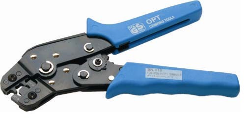

    opamp wrote:
    I can recommend the OPT Sn01B
    Best crimping tool for goldpin connectors and source for compatible cables

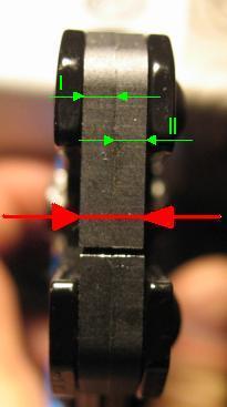

    I have a question about this crimper
    What are the jaw thicknesses of this crimping tool?
    I attach a picture to more accurately illustrate my question.

  • #22 12248775
    opamp
    User under supervision
    Posts: 3612
    Help: 266
    Rate: 925
    The dimensions of the head itself are 5.28 mm and the dimensions of the handles are 10.30 mm.
    Cheers Marcin
  • #23 12249845
    miro68
    Posts: 8
    If it is useful to someone, the SN-01BM crimper has a jaw (head) width of 4.1 mm
    I am useful for slightly smaller connectors.
  • #24 12265948
    sq6fmy
    Level 22  
    Posts: 585
    Help: 50
    Rate: 60
    HT225D has a jaw width of 6mm. Is SN01B suitable for connectors with a spacing of 2mm? Do the jaws have a different clamping slot height - is it split and the two parts of the connector clamp to different heights? And does it fold the wings correctly? (because I already had one of these, which was squashed instead of wrapping)
  • #25 12283459
    miro68
    Posts: 8
    From what I found out, the SN-01B crimper has a jaw width of 4mm
    I was going to buy it if it was wider, but its width is the same as the SN-01BM I have, except it has inverted jaws.
