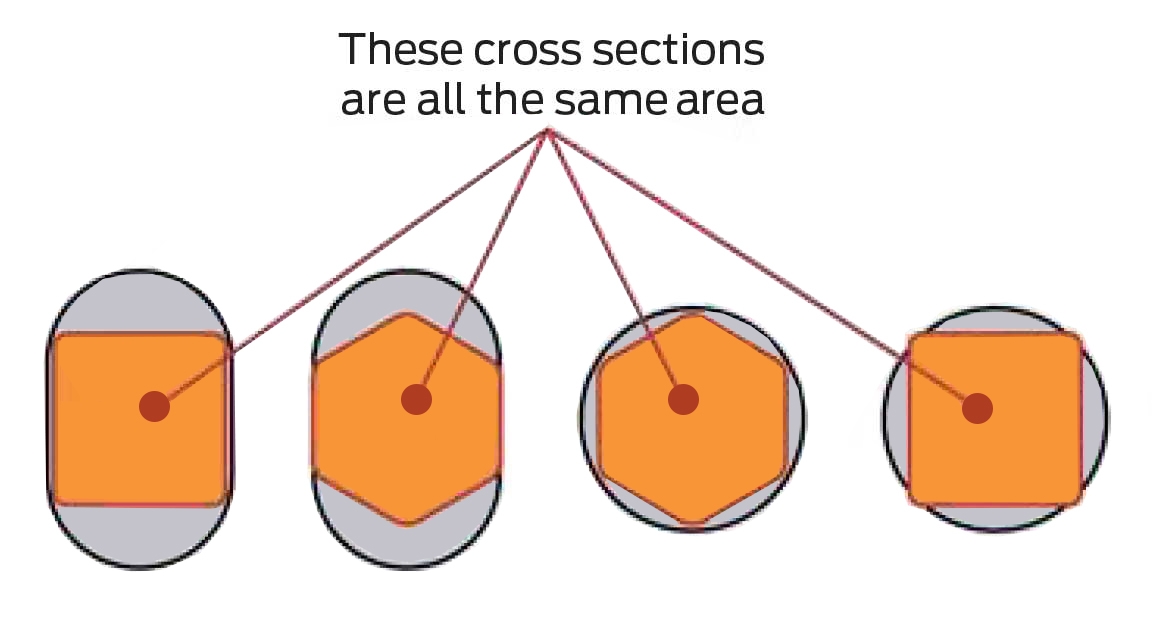

    Hello. I need to purchase a crimping tool. I am thinking of the square-tightening one. Unfortunately, I cannot afford Knipex or something from this price range yet, so I would ask for advice with a choice of up to about PLN 150 :)
    It's about something like this:
    Crimping Tool for Insulated Sleeves Under PLN 150: Comparing Electrotitanium, NEO & Knipex Options
    There are some models to choose from: Electrotitanium, NEO, etc., have any of you worked on this type of equipment ...? How does it work ... is it really worth spending the 500-600 on Knipex? I do not intend to tighten only the sleeves for the rest of my life :D

    I recommend presses with a pressing range of 0.08-16.0 mm with hexagonal pressing. They are not that cheap, but they will withstand several years of intense clamping.
    raspberry555 , you can go ahead and buy even the cheaper ones with a four-sided crimping, but it's not the same as with a hexagonal crimping. They are perfectly sufficient for amateurs.

    I am curious to argue and explain what is worse in square pressing in professional applications?
    Larger diagonal (it is the dimension between opposite corners).
  • #18 17153336
    Ryszard49
    Posts: 6245
    Help: 312
    Rate: 1011
    protasiewicz When you go to the warranty service for several hundred kilometers, you will understand what the difference is in the crimping machines. Anyway, tools are "thrown" into production costs, so there is no need to save on tools.

    Mikado
    Posts: 54
    Unfortunately, I have to dissuade you from turning Praga into a square. It just so happens that I have to use this type of tools quite often in the company, such as, cabinets, slats, PLC, etc.
    The problem appears when you need to crimp the sleeve on the "contact", and even worse when you need to insert two under one clamp, and you do not always have to use two wires. Thus, when crimped into a rectangle, it is more compliant and compliant with clamps, etc.
