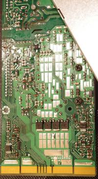

    Okay, here's the picture...
    Server Power Supply HP PS-3701-1C: Pin Out and Dry Start Procedure Server Power Supply HP PS-3701-1C: Pin Out and Dry Start Procedure
    Regards
    Robert

  • #9 9388680
    swiatrob
    Posts: 15
    Unfortunately, I couldn't find such documentation that would contain the information I need...
    Coming back to the power supply - I managed to start it, and the connection shown is in the attached photo.
    I hope that such a connection will suffice and to find out about it, there are still load tests to be performed.
