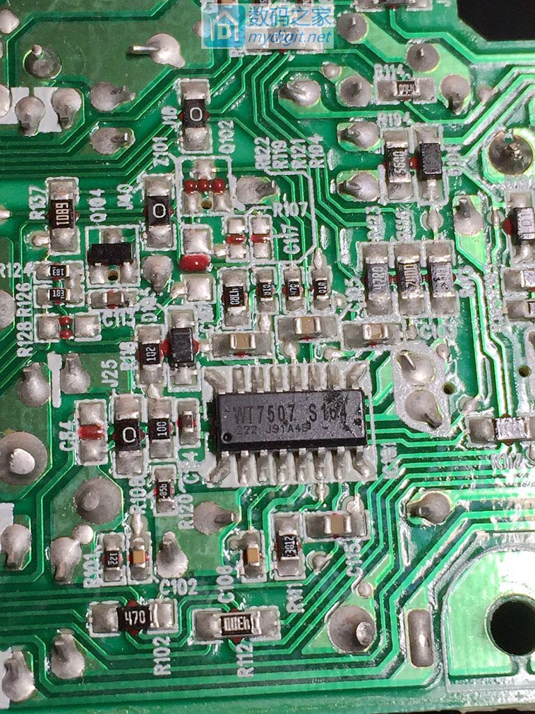

    Supervisor: WT7507

    Damage to either the power supply or the WT7507 SOP16 (himself or the RC parts in his vicinity)

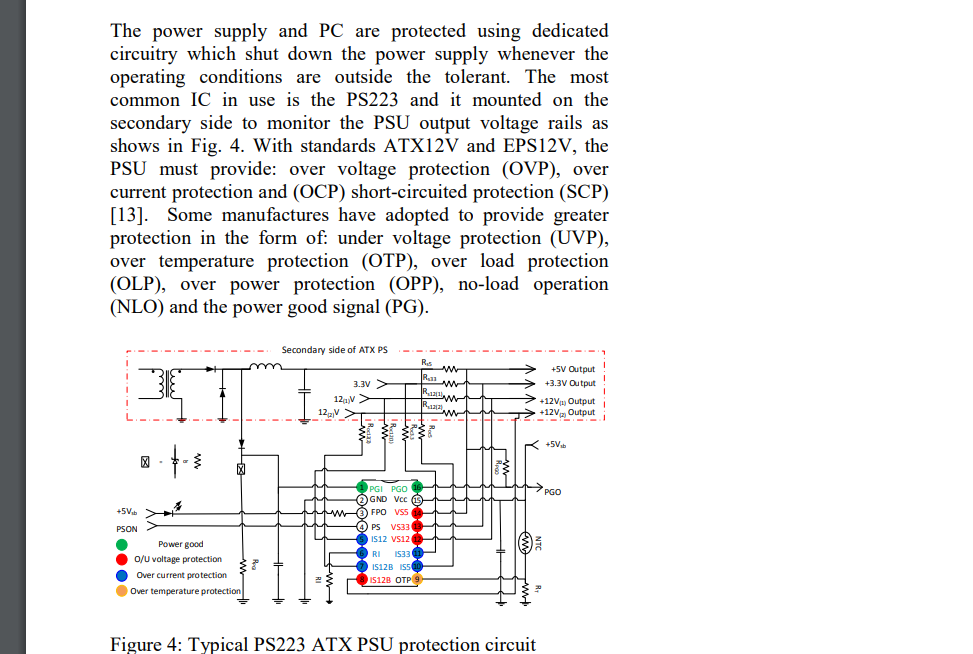

    one of the most important protections (the OTP or Over-Temperature Protection) is only supported by two monitoring ICs, the SITI PS223 and the Weltrend WT7507. However, there are other ways to implement this protection and trigger one of the other protections in a monitoring IC, in order to shut down the PSU.
    About WT itself briefly on Link
    and Link
    Comparison of available systems "watchdog = supervisor" under Link
    Read the datasheet of that other system Link__ SITI PS223
    - :!: compare pin "y
    - * pin.9 PS223 OTP Over temperature protection input
