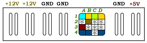

    I dismantled the whole thing and started to investigate what the pins from the 4x4 pin are for. Without going into details, I have determined that the pinout looks like this:
    [Modification] We are taming the DELTA DPS-600QB 40A / 12V, 600W, pinout server pinout.png (2.77 kB)You must be logged in to download this attachment.
    From the left, as in the picture below. The two copper terminals are 12V outputs, the next two are ground / GND / RTN, then we have a "mysterious" 4x4 header, the next two are ground / GND / RTN and 5.1V.
    4x4 header:
    A2, C2, D2, B3, C3, D3, C4 = GND / GROUND - are marked with the sign " * "in my drawing.
    A1 = This pin raises my doubts. It is connected to two SMD resistors with a resultant resistance of 100 Ohm. In a word: the pin is of no use to us. The so-called pull down.
    B1 = After connecting the power, this pin is high through a 10k pull up resistor connected to 5VSB inside.
    C1 = Power_ON works the same as in the ATX power supply. To turn on the power supply, connect this pin to ground. This pin is connected to a 1k resistor inside, then the signal goes to transistor sot-23 and so on.
    D1 = POWER_OK on the tested unit, the High signal appears here about 1.1 seconds after switching on with the Power_ON (c1) pin. It is probably an open collector output, watch out for this pin lest you burn the small sot23 transistor when fumbling with the meter ...
    B2 = Analog input pin. Applies to the 12V line. After applying a current of 130..180uA to this pin, it causes a change of 12V output voltage linearly. The easiest way to describe it is: 0-130uA U_out_12V = 11.90V but when we give 180uA and more, the output appears about 12.15V. In a word: voltage regulation 12V. We don't have to use this pin, but the voltage will be 11.9V (that's exactly what I have).
    A3 = Analog input pin. It applies to the 5.1V line. Same as above, but: current 10..40uA causes a change in the range of 5.10..5.23V. In a word: regulation of the 5.1V line.
    The pins below are for the I2C memory soldered to one of the standing PCBs (specifically the larger PCB).
    A4 = VSS of 24C02 chip
    B4 = SCL
    D4 = SDA
    I haven't tested thoroughly if sometimes the uC STM7x also hangs on the I2C lines. Between pins B4, D4 and A4 there are 100 Ohm resistors between the chip, just in case. Note: A4 is not connected to GND / RTN ground.
    To sum up: For proper operation of the power supply, it is enough to short PWR_ON with ground and hula. The rest are nice additions.

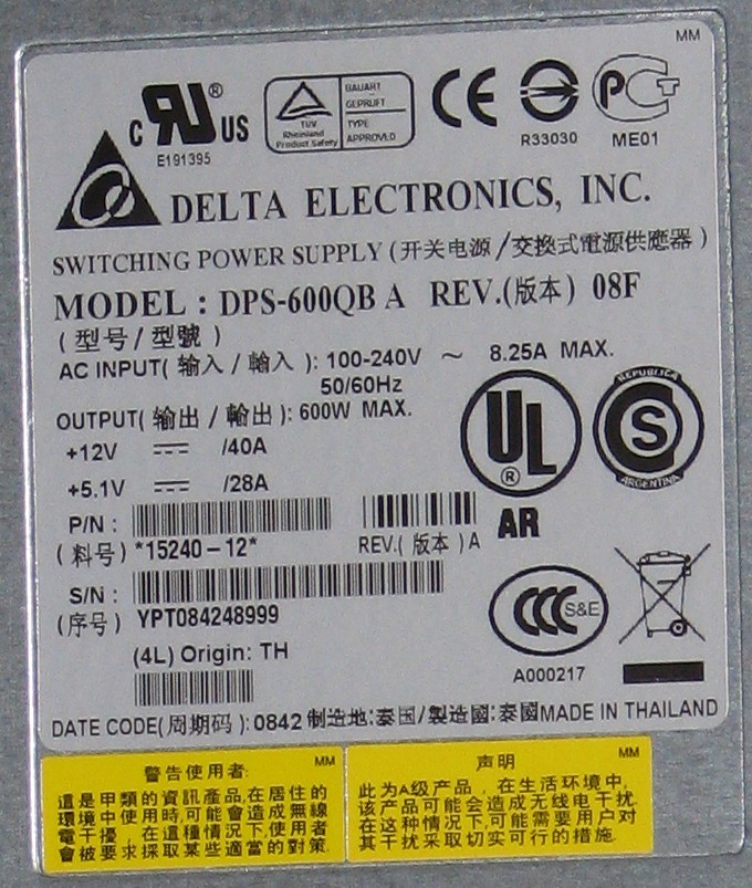

    [Modification] We are taming the DELTA DPS-600QB 40A / 12V, 600W, pinout server 1.jpg (469.77 kB)You must be logged in to download this attachment.
    Yes, Delta shows the parameters.
