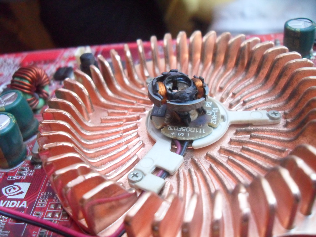

    My ASUS 22 '' monitor started showing a pink image yesterday.
    What is the reason for this?
    I wonder if it's not the fault of the graphics card. NVIDIA GEFORCE 8500 GT. When I turn off the computer for the first 10 minutes, the image is ok, and then this pink again. And so every time I turn off the computer. Moving the cables does nothing. I pulled out all the cables, blown it and nothing.
    What could it be and how do I fix it?

  • #13 9296521
    kinkietka
    Posts: 9
    Board Language: polish
    You know what? I unscrewed the side cover from the computer to see how the card behaves when the computer is on and I noticed that the fan on this card is not spinning. So I turned it off, unscrewed the card and it turned out that this fan is burnt - (of the four windings that were on this fan, two are burned) and now the question is is it only the fault of this fan? could anything have gone further?
  • #14 9296548
    SLAVCO1983
    Posts: 331
    Help: 16
    Rate: 33
    Maybe the reason for the flush is overheating of the system, but I shoot. In this case, I would replace the fan or put another one temporarily for cooling. If it turns out that everything returns to normal, replace the fan and that's it.

    And this is what my card looks like in which this windmill burned:
    • ASUS 22 Monitor Displaying Pink Images: Causes & Fixes for NVIDIA GeForce 8500 GT SDC17803.JPG (400.97 KB) You must be logged in to download this attachment.
