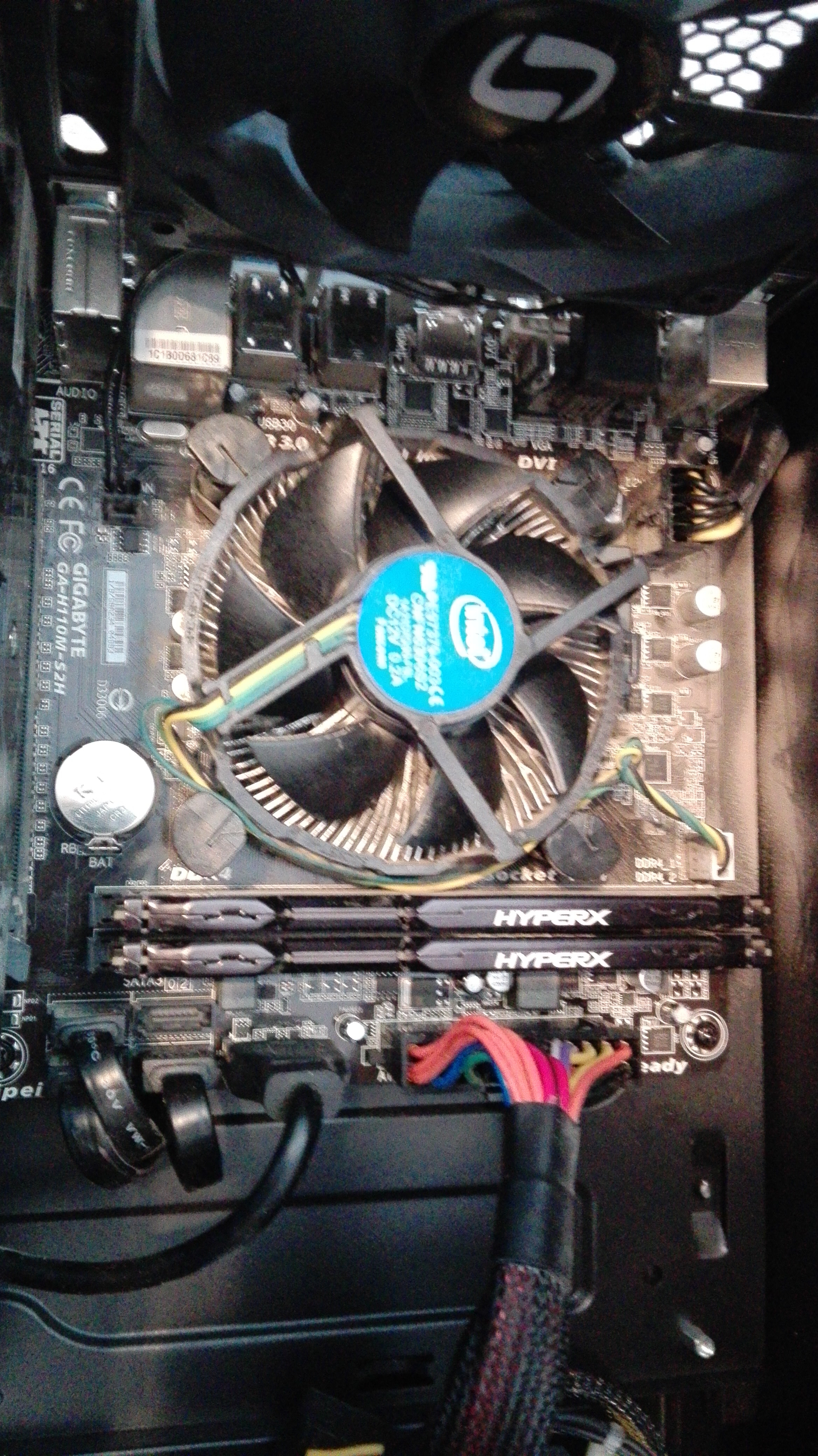

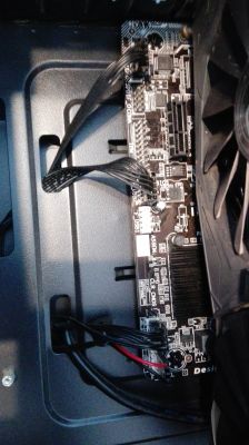

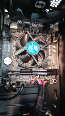

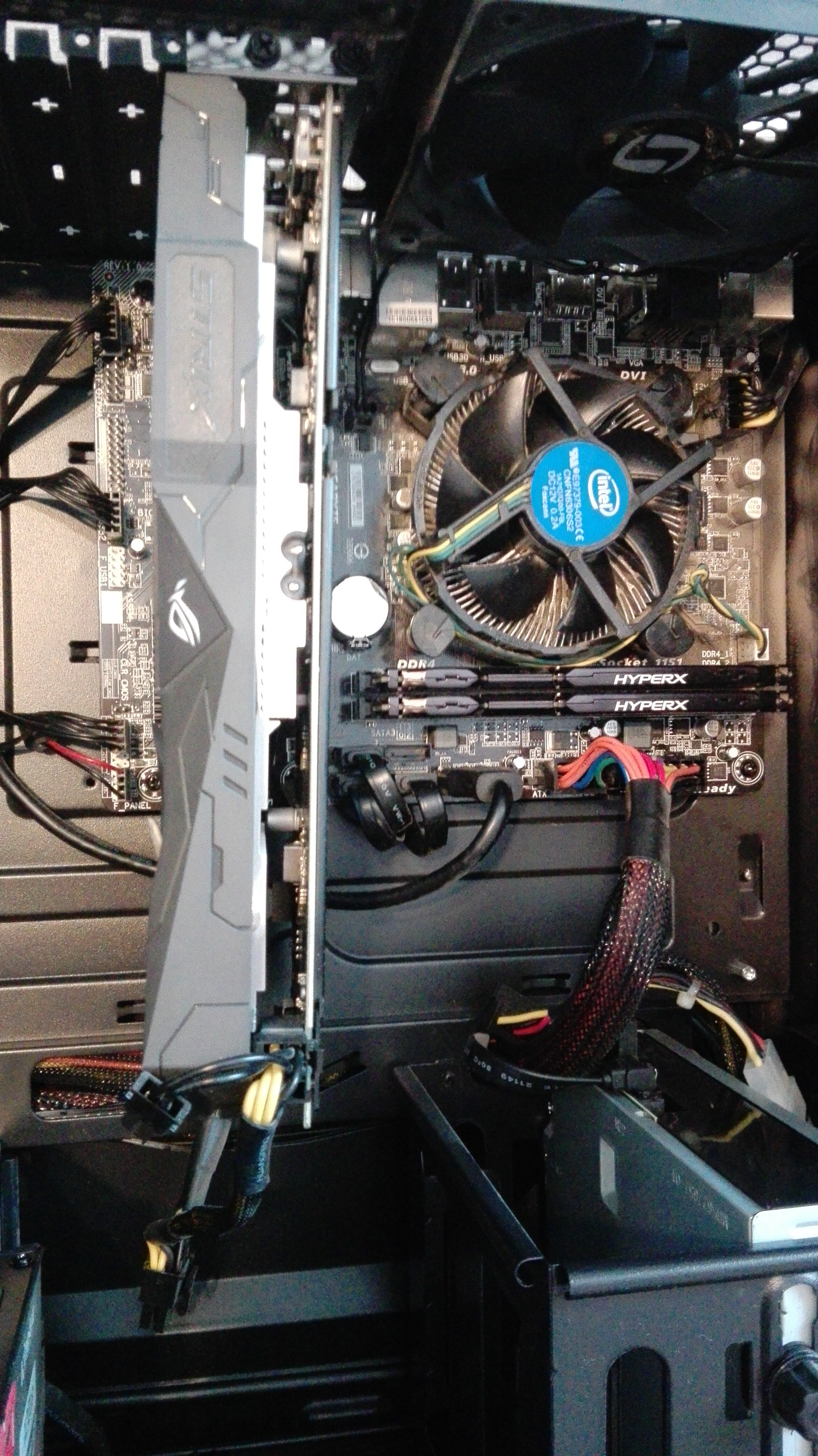

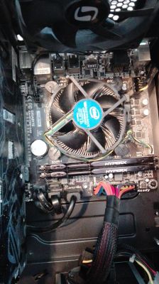

  • #6 17163541
    MajkMagic
    Board Language: polish
    Graphics Card Issue: Nvidia 1050 Ti Not Displaying Image on LG 144Hz Monitor (HDMI, VGA, DVI) Graphics Card Issue: Nvidia 1050 Ti Not Displaying Image on LG 144Hz Monitor (HDMI, VGA, DVI) Graphics Card Issue: Nvidia 1050 Ti Not Displaying Image on LG 144Hz Monitor (HDMI, VGA, DVI) Graphics Card Issue: Nvidia 1050 Ti Not Displaying Image on LG 144Hz Monitor (HDMI, VGA, DVI) Graphics Card Issue: Nvidia 1050 Ti Not Displaying Image on LG 144Hz Monitor (HDMI, VGA, DVI)
    as he wrote @ mariuszp19 I tweaked all the slots and checked that everything was tight. It was hard for me to take a good picture, but maybe you will notice something. It is possible that a small detail flew off during cleaning, but it never happened to me and I didn't do it somehow haphazardly. I did not unfasten the pins during cleaning, only took out the framework and the card.
