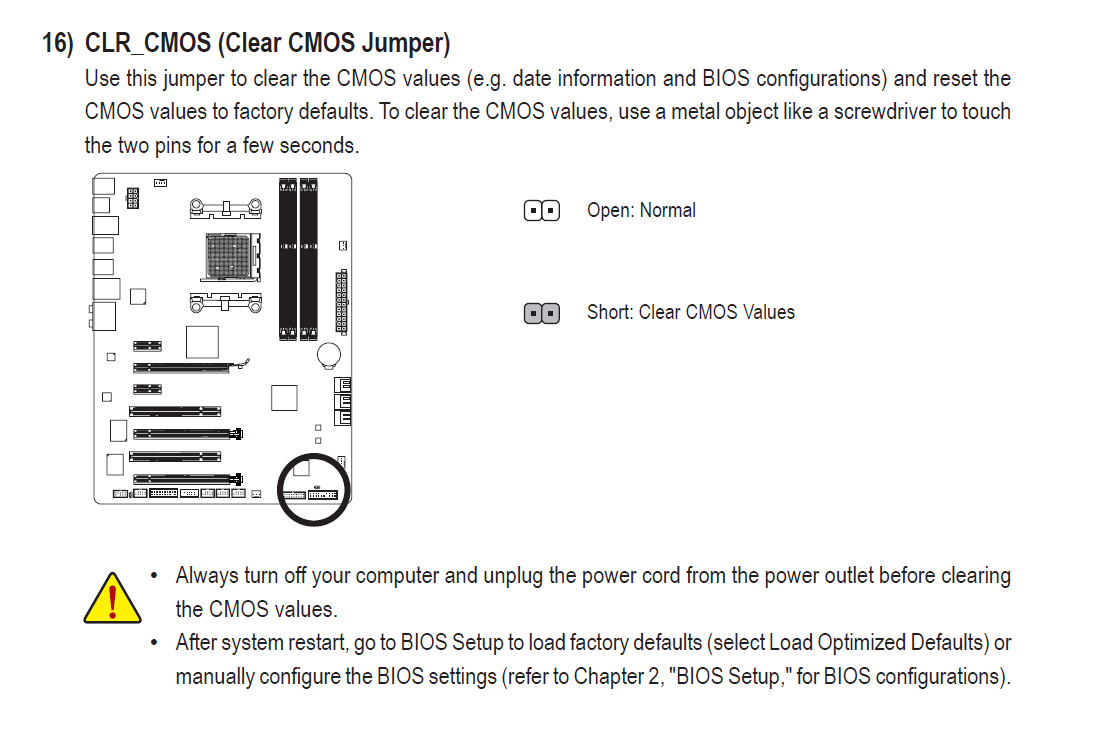

    It's hard to advise. You can reset the bios. Find the CLEAR CMOS jumper, disconnect the power, remove the bios battery and reset the bios. If it doesn't work, it's a service because anything could happen from a power supply failure, motherboard, ram, processor or gpu, etc.
  • #7 17318078
    XDNAMEXDPL
    Posts: 36
    An informant can help here?

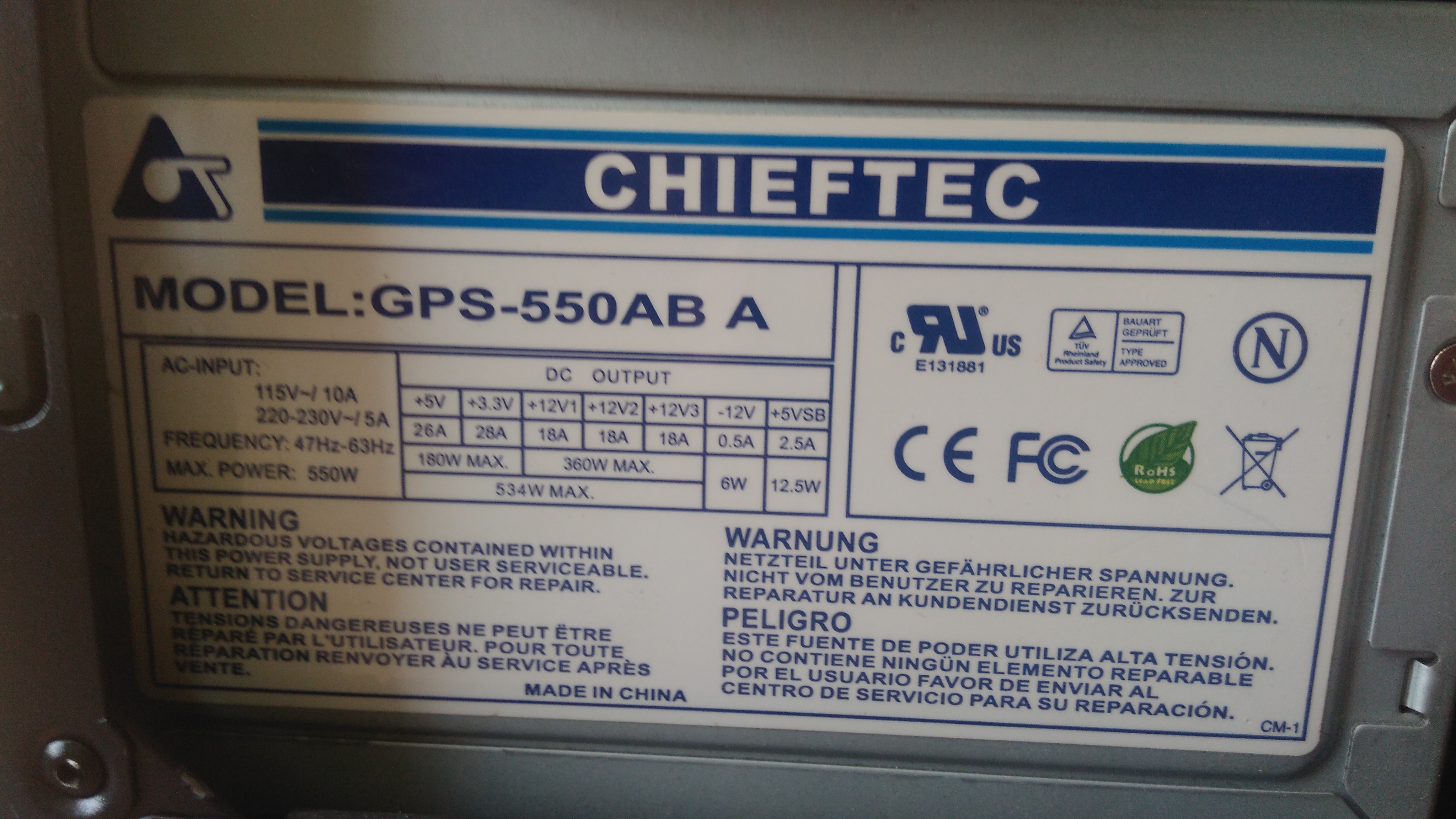

    And check the power supply, because "it was 550W" does not mean anything. The model is more important, if it's some kind of carrion, it's worth looking at if it's causing problems.
  • #13 17318373
    XDNAMEXDPL
    Posts: 36
    dt1 wrote:
    There is no motherboard in this computer? Because it is based on it that you can determine whether you have an integrated graphics card on the board or not.
    And check the power supply, because "it was 550W" does not mean anything. The model is more important, if it's a carcass, it's worth looking at if it's causing problems.
    Motherboard is Gigabyte GA 990XA DA
    And the power supply I don't know, I'm not at home right now, so I'll check in the evening

    And the power supply is Chieftec
    And I wanted to add that he is doing very well

    Restoring the BIOS to factory settings certainly won't hurt, and it may help, so it's worth doing.
    The card may have a cooler that starts working when it exceeds, for example, 50 degrees. On the card manufacturer's website, you can definitely check whether this method of cooling was used by the manufacturer in this model.
  • #21 17318769
    XDNAMEXDPL
    Posts: 36
    dt1 wrote:
    Things are so weird with devices. They work and a moment later they don't.
    My model is the GTX 1050Ti, these cards probably have it, but you could send me how to reset the BIOS without having a screen because the image is not displayed as I mentioned above.
  • #22 17318787
    dt1
    Admin of Computers group
    Posts: 48250
    Help: 7315
    Rate: 8292
    XDNAMEXDPL wrote:
    My model is a GTX 1050Ti and these cards seem to have it
    No, these cards, depending on the model, may have it, and they may also have standard cooling that works at low speed when not under load. Guessing that "probably they do" is wrong, because it depends only on whether the manufacturer used them in a specific card model. One company may use them, another may not. In addition, even different models from one company could use such a solution, while other models used a different one. The specification solves this problem, not guesswork.
    XDNAMEXDPL wrote:
    how to reset bios without screen
    The motherboard manual (page 30) explains it all - no monitor needed.

    In that case, I'll try to reset the BIOS and go to the IT specialist tomorrow, if anything is clear, I'll let you know and close the topic! Thank you very much for the advice! :)
    Added after 35 [minutes]:
    XDNAMEXDPL wrote:
    dt1 wrote:
    Graphics Card Fans Stop Spinning After 20 sec: Driver Update Issue & Possible Solutions

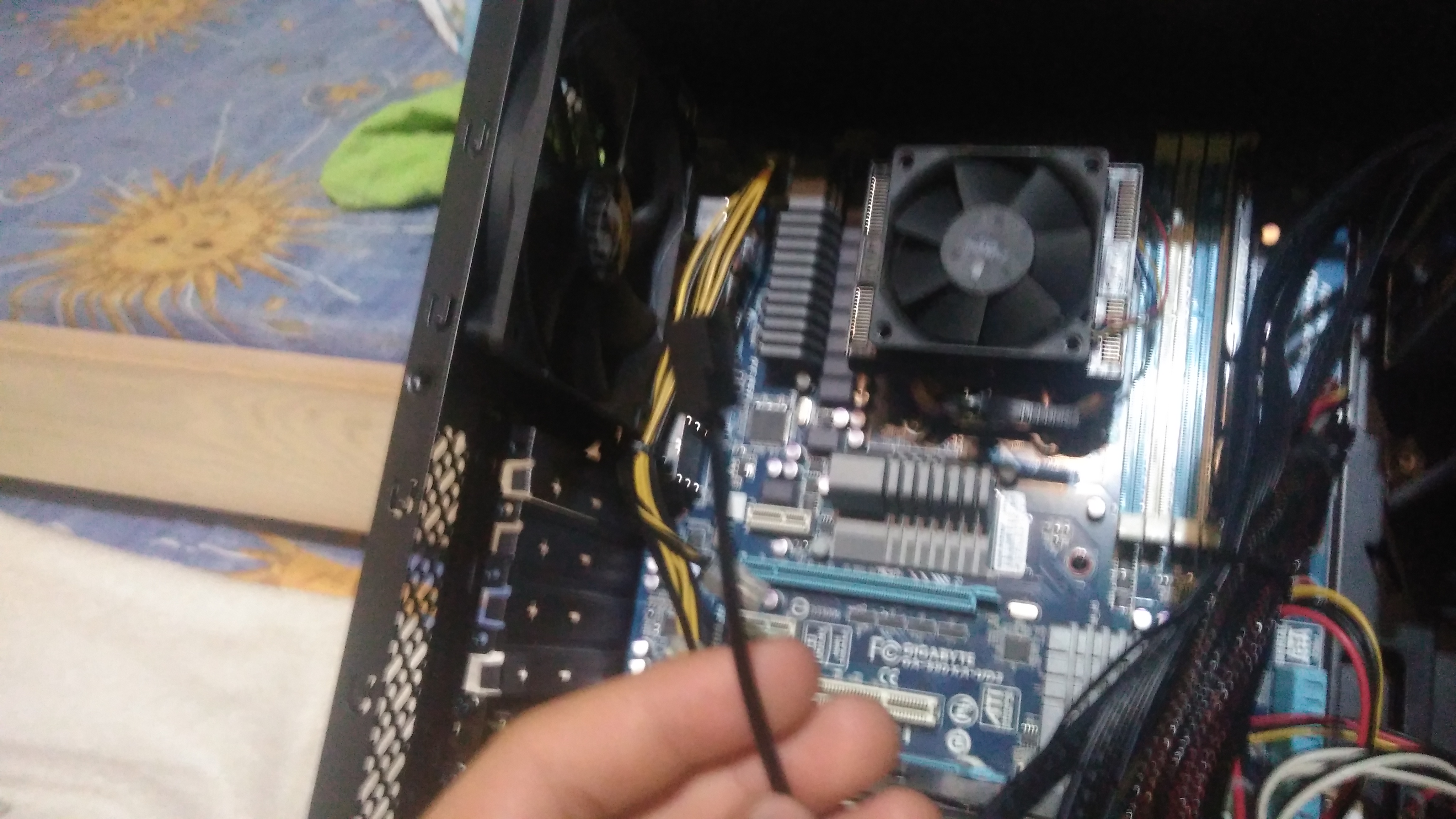

    Okay BIOS reset! But the one thing that worries me is the cable that got disconnected from something but I don't know what

    Resetting the BIOS did nothing.
    I'm going tomorrow so maybe something will be clear?

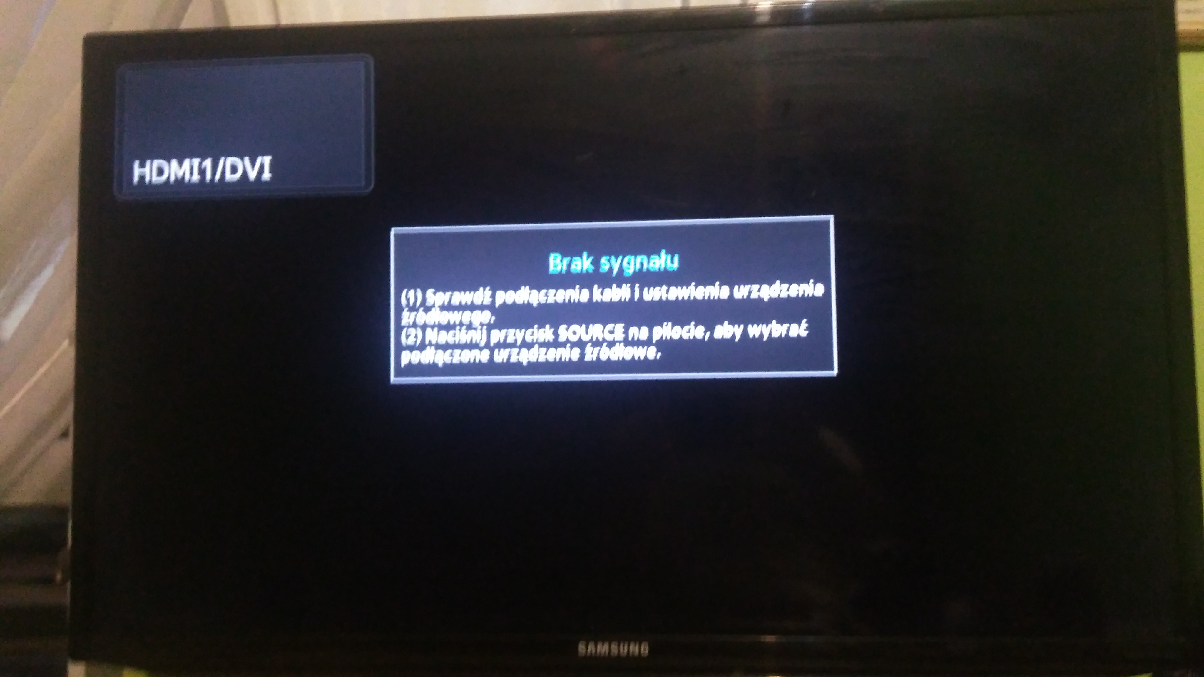

    Well, that's what I wanted to present so that no one would misunderstand me, but can you give me the reason why the image may not be displayed (when I have HDMI connected, it says "No Signal" and when not, "Please connect the cable", maybe it's a clue what could be the reason besides the card graphics.
  • #28 17319555
    kindlar
    Level 42  
    Posts: 7888
    Help: 919
    Rate: 1622
    The monitor does not detect a signal (image) hence the message.
  • #29 17319560
    XDNAMEXDPL
    Posts: 36
    Is it from the graphics card? Could the problem also be in the cables?

3. How do I clear CMOS without a monitor?
Use the onboard CLR_CMOS pins: 1) Unplug PSU and press the power button once. 2) Move the jumper to short pins for 10 s or remove the coin-cell battery for 30 s. 3) Restore jumper/battery, reconnect power, boot [Gigabyte Manual, p.30].
