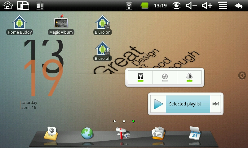

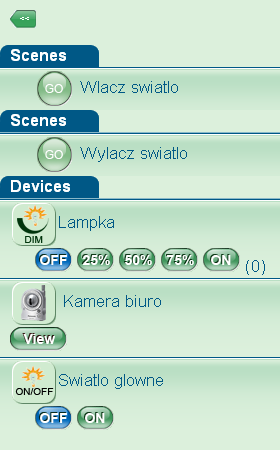

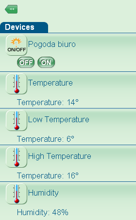

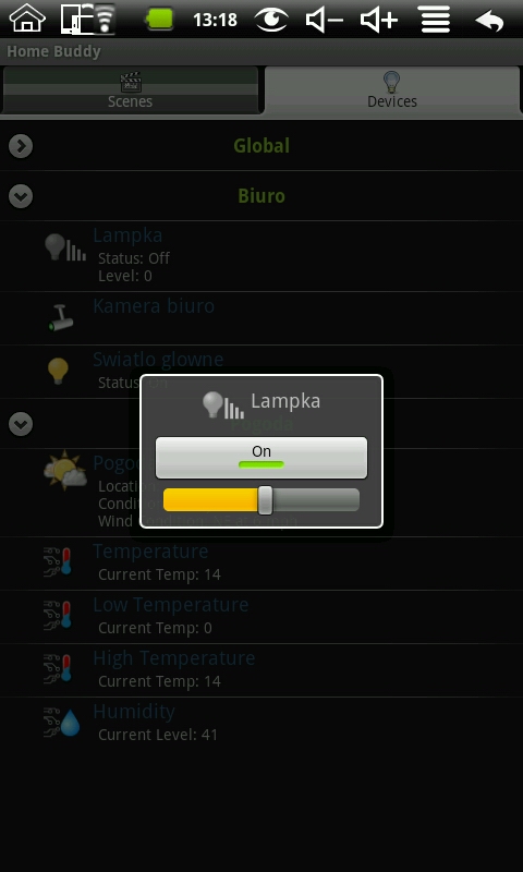

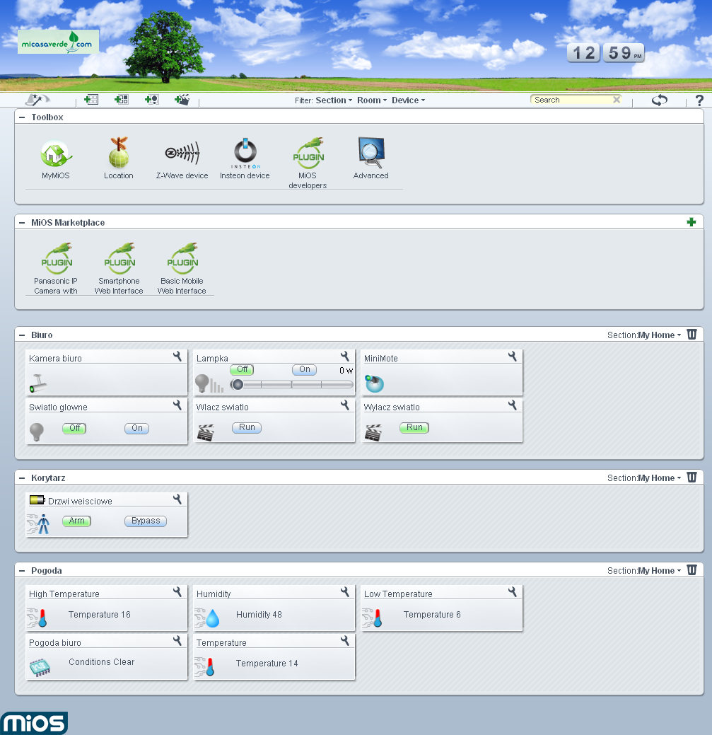

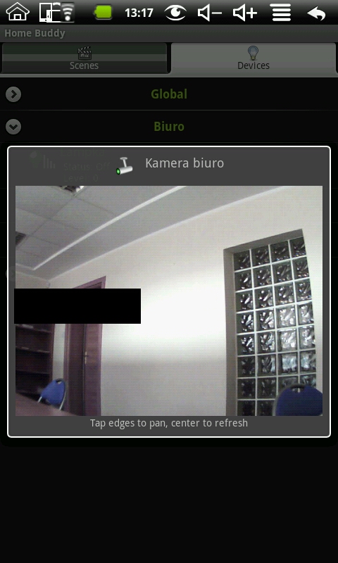

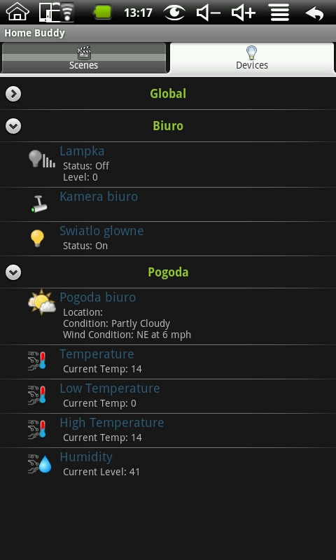

    I personally work with Z-Wave. It offers a wide range of possibilities, and installation and configuration are incredibly simple. New products and software for this system are constantly being released, so there’s a really wide choice.
    We’ve installed a basic Z-Wave presentation system in our office. I’ve attached screenshots of the web interface, the mobile app interface, and screenshots from our tablet. There are also several other apps available for iPhone, Windows and other platforms.
    If you have any questions, feel free to message me privately. I can even grant you temporary access to the server if you’d like.

    I can see that both Z-Wave programmes look very decent, but could you confirm whether you are integrating these programmes with the Moeller XComfort system? Because I’m actually looking for software to control XComfort.
  • #6 9422634
    Max25
    Posts: 59
    No. We use Z-Wave. I think I misunderstood the question. I thought you were asking about alternative systems, but I suppose you meant alternative software. If so, please forgive me.
