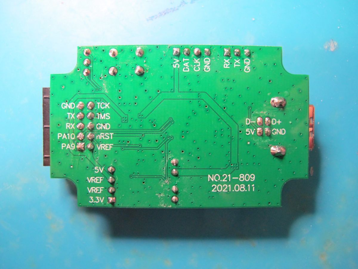

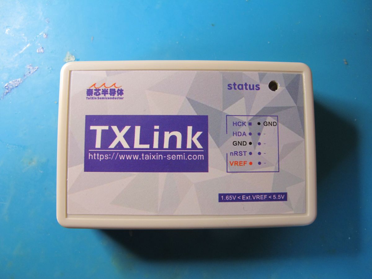

    Here's a dump of information relating to the Taixin (Huge-IC) TXLink programmer/debugger I bought ages ago from Taobao. Mostly notes and pics. More to be added I expect.
    refs:
    https://www.elektroda.com/rtvforum/topic4121456.html
    https://www.elektroda.com/rtvforum/topic4123724.html
    https://github.com/voidobserve/project/tree/branch_1/Project/Keil
    device = TX-Link-U
    hw = V1.10
    fw = L:V1.31 D:V1.15

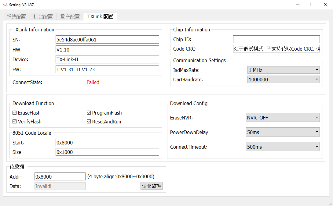

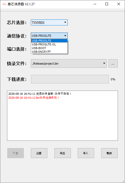

    Latest TXProgrammer versions are too new. TXLink connects OK with
    TXProgrammer_V2.1.37
    TXProgrammer_V2.1.37 does not support TXW81X, but does support TXW80X but only with USB programmer types
    Taixin TX-Link-U, TXProgrammer 2.1.37 - pics, notes, OpenOCD JLink probing, ongoing investigations
    Choose a platform type that has TXLINK as an option and you get to connect to the com port that the connected TXLink device enumerates as. Open settings then you see it connecting to the TLink and fecthing serial, hw, device, fw info
    However, as seen here in my forum post: https://dev.taixin-semi.com/topic/49/tx-link-...%E7%A8%8B%E5%BA%8F%E4%B8%8E%E6%96%87%E6%A1%A3
    The one without "lite" was used by us to burn other non-Wi-Fi products; the one with "lite" is for burning Wi-Fi products.

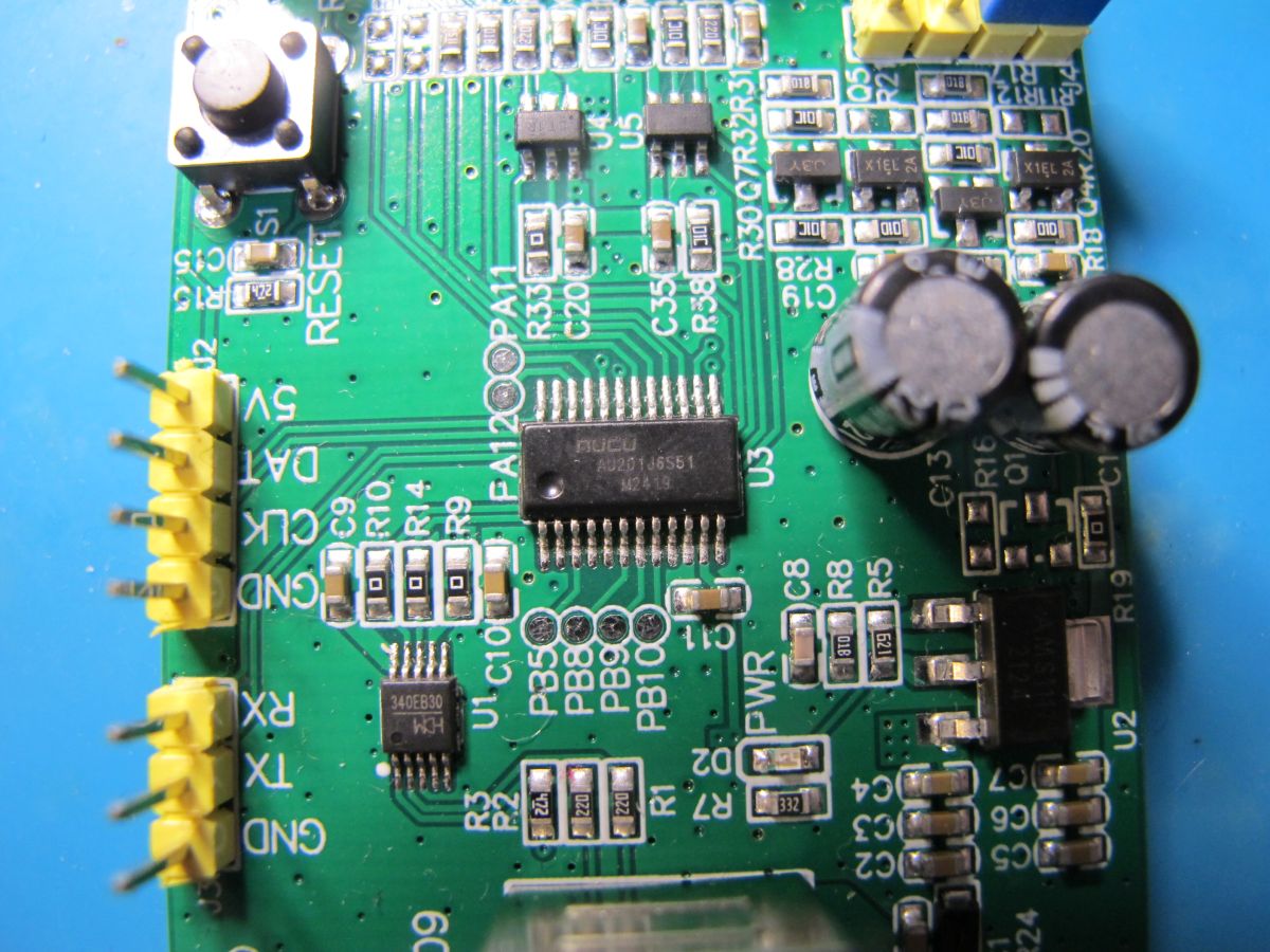

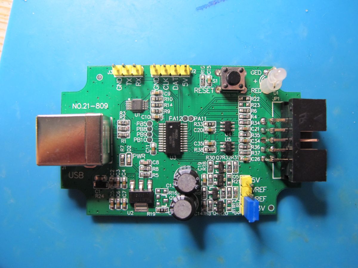

    The Aucu AC201 MCU is not listed on the AUCU web site, but the attached datasheet for the AM32M2032JS5 appears very relevant. The package is the same. IOs match. SWDs for AU201 MCU and for connected Taixin to debugger are correct
    C:\OpenOCD\bin\openocd.exe -f C:\AU201\au201-jlink-openocd.cfg

  • AU201 is the programmer MCU, not target MCU
    #5 21956122
    Posts: 5241
    Help: 450
    Rate: 920
    The AUCU AU201 is the MCU at the heart of the TX-Link-U programmer, not the target platform of the programmer.
    The target devices are Taixin (Huge-IC) MCUs. And it seems to be for the older non-wifi Taixin platforms at that.
    So for investigations into how TXW81X can be made easier to flash for users (currently requiring CK-Link/STM32), this TXLink device I have seems less relevant than it once did. A TX-Link Lite would have been a better purchase.
