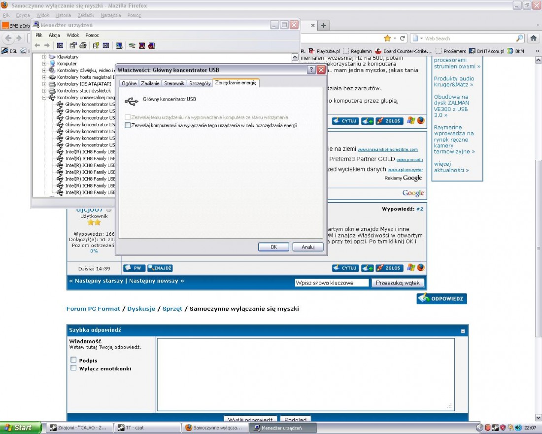

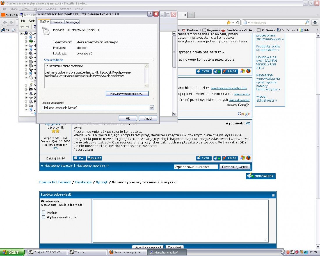

    Device Manager/Mouse Properties/Power Management - check if there is an option to allow disabling...
  • #3 9418521
    Stangen
    Posts: 20
    This option is not checked (I already unchecked it). Maybe not enough energy? Would replacing the power supply help? Maybe something wrong with the cable? Do you recommend replacing it? Will this help? :) )
