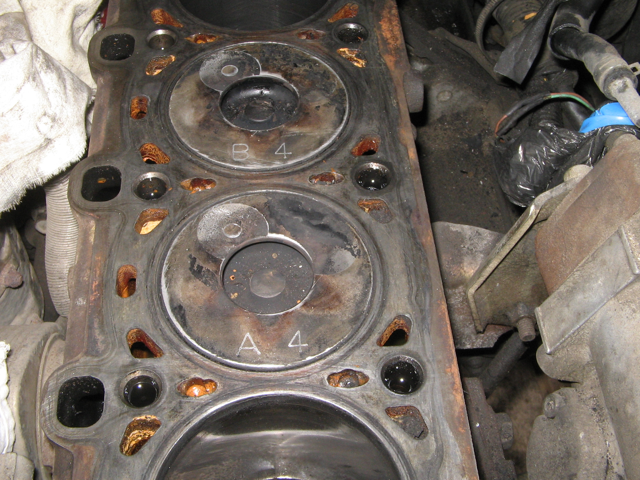

    #14 16197087
    zmarta
    Posts: 6
    Rate: 14
    pioart wrote:
    Little data
    MAZDA 6 (GG) 2.0 DI
    1 GMP marking
    2 reference mark
    3 Retaining screw (s)
    4 Bolt (s) - Tensioning Device
    5 tensioning device
    Mazda 6, 2.0 Diesel: Seeking Timing Belt Setup Scheme for Replacement Process
    I'm replacing the head gasket. Head removed.
    Setting the motor shaft according to the TDC signs - as in the picture, pistons 2 and 3 have TDC, piston 1 and 4 are at the bottom
    how to explain it? in principle, you should set the timing to cylinder 1 or 4 depending on the engine design

  • #15 16197397
    coperfild
    Level 35  
    Posts: 2760
    Help: 291
    Rate: 1697
    Set the timing shaft to the marks and see which cams are up, maybe it should be.

  • #17 16197736
    T5
    Admin of Cars group
    Posts: 12861
    Help: 1004
    Rate: 4182
    A turn the shaft so that the first piston is up and see the mark on the shaft. :)
    Thinking at work, thinking :)

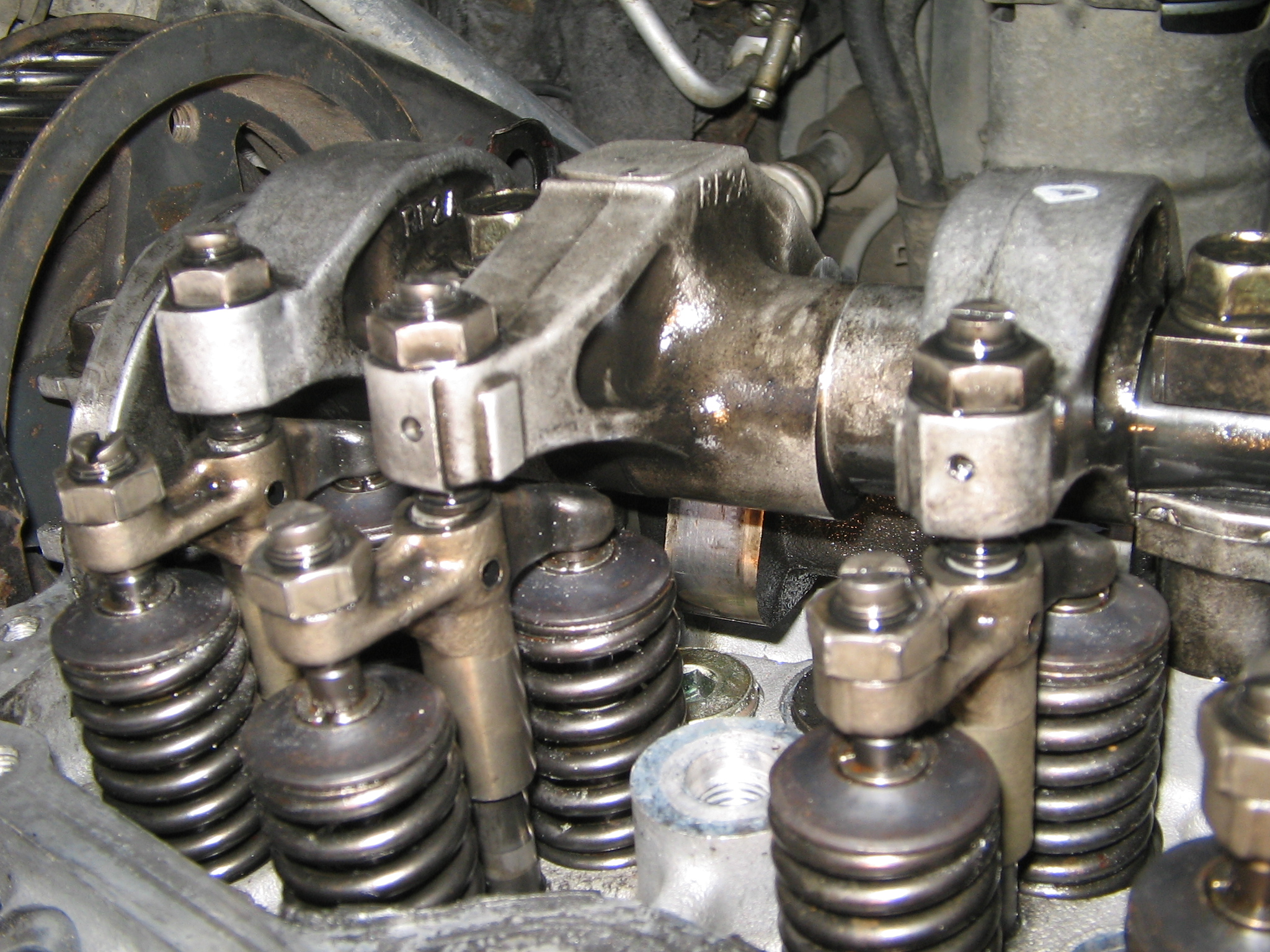

  • #18 16199208
    zmarta
    Posts: 6
    Rate: 14
    T5 wrote:
    camshaft installed. toothed wheel as per mounting point> valves closed for 1 cylinder / cam at the bottom /
    the piston of the first cylinder at TDC, but the mounting mark on the shaft is shifted by 180 degrees / you have to make the mark yourself with a marker, physically it cannot be otherwise.
    I wonder if this is normal, or if someone unscrewed and vice versa mounted the wheel with marks on the motor shaft?

  • #19 16199258
    T5
    Admin of Cars group
    Posts: 12861
    Help: 1004
    Rate: 4182
    But that's not a sign, buddy :)
    The sign is cast aluminum behind the gear on the shaft and a cutout on the gear on the side of the engine block.
    Look, this cutout is supposed to match the mark on the casing, it's hard to see with the strap on.
    https://www.google.pl/search?q=mazda+6+2.0+d+...PzEN_ptlRnru0M%253A%253B7HGFeBlyMa1A1M%252F3A %252252 elektroda.pl%25252Frtvforum%25252Ftopic1979591.html&source=iu&pf=m&fir=PzEN_ptlRnru0M%253A%252C7HGFeBlyMa1A1M%252C_&usg=__32b-YbGpKM6PJ2KPRxiPVbdU2SM%3D&biw=1280&bih=651&ved=0ahUKEwjavoruhcLRAhVBoBQKHaJWCmwQyjcIPw&ei=blB6WNpPwcBSoq2p4AY#tbm=isch&q=mazda+6+2.0+d+ko% C5% 82o + spread% C4% 85du + on + shaft & imgrc = keqfSecRs6lbGM% 3A

  • #21 16199538
    zmarta
    Posts: 6
    Rate: 14
    the notch on the engine block and the protrusion on the shaft gear are not "marks" of the belt assembly, because they show after setting the piston DMP, that means that there is no factory mark on my shaft wheel relating to the GMP setting of the piston on 1 cylinder.
    Photo with description.
    I marked the point with a marker, everything is set, the bar is on, everything spins without collisions.
    When I start the engine, I do not know, because in my garage it is cold, and there is still some turning time left.
    When I run it, I will let you know.

  • #22 16201492
    zmarta
    Posts: 6
    Rate: 14
    Rectification and explanation:
    I checked where there is a notch on the block> there is a V-shaped notch on the gear wheel, according to my last photo, the setting is correct.
    Only the notch on the gear wheel is invisible, it is obscured by the car frame.
    Thank you to everyone for your willingness to help solve the dilemma. Maybe these tips will also be useful to someone.
