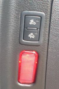

    Hello, does anyone know what the buttons in the photo below are for?
    They are located at the driver's side door in the lower section

    Thanks in advance for your help.

    The upper one turns off the motion sensors inside the vehicle (e.g. you leave your dog inside and go to the kiosk to get pipes), the lower one turns off the body tilt sensor (you load the car on a tow truck)
    Of course, both are for factory alarm
