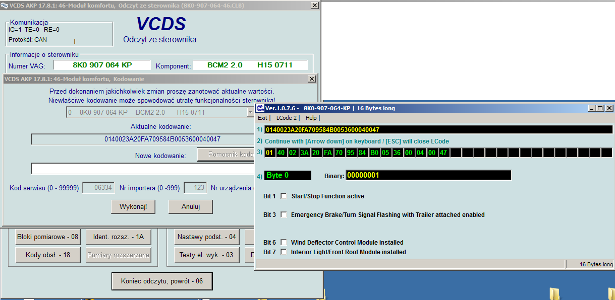

    My father-in-law came to me asking if it was possible to activate the opening and closing of the windows with orig. pilot.
    Audi Q5 2015.
    I read that you have to use VCDS to enter the comfort module - coding - coding assistant - BAJT 7 and select BIT 2 and 5.
    Unfortunately, after entering byte 7, there are no options for checking / unchecking.
    Comfort module: 8k0907064kp
    AUDI Q5 2015: Activating Window Control with Original Pilot Using VCDS - 8k0907064kp Comfort Module
    Can anyone tell me if there is an option to turn on the remote control?

  • #9 17197531
    tomason2
    Posts: 249
    Help: 15
    Rate: 164
    I don't know if it matters, the car is the US version.
  • #10 17233751
    tomason2
    Posts: 249
    Help: 15
    Rate: 164
    After updating the program and re-entering the comfort module, the coding assistant correctly displayed all available options.
    In byte no.2 I marked bit no.2.
    After this operation, an additional option appeared in MMI 3G that allows you to control the windows and sunroof from the remote control.
    Thanks to everyone for the response.
    Best regards.
