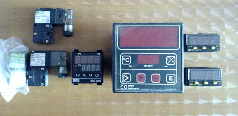

    gentlemen - a little bit different. I have such equipment:
    Yihua 937D vs Zhaoxin 936D Soldering Station: Comparing User Experiences for Home & Project Use
    is it good for something? I have it in my wardrobe and I don't know - garbage can or something else?
