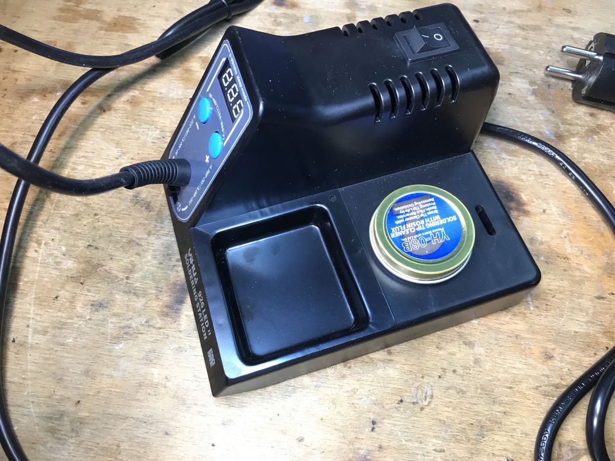

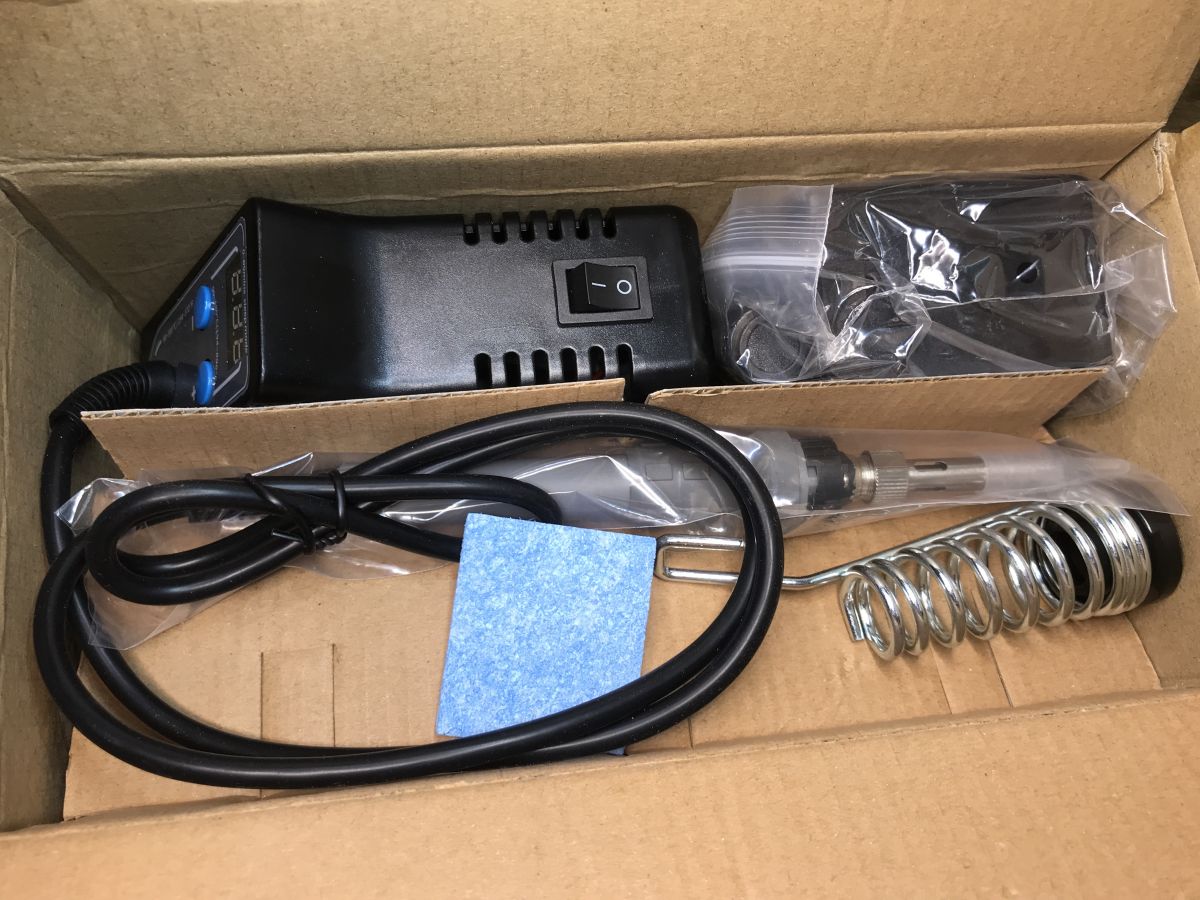

    And the contents of the set - pretty much everything you need is:
    YIHUA 926 LED II 120W soldering station set in a box YIHUA 926 LED II 120W soldering station in an open box.

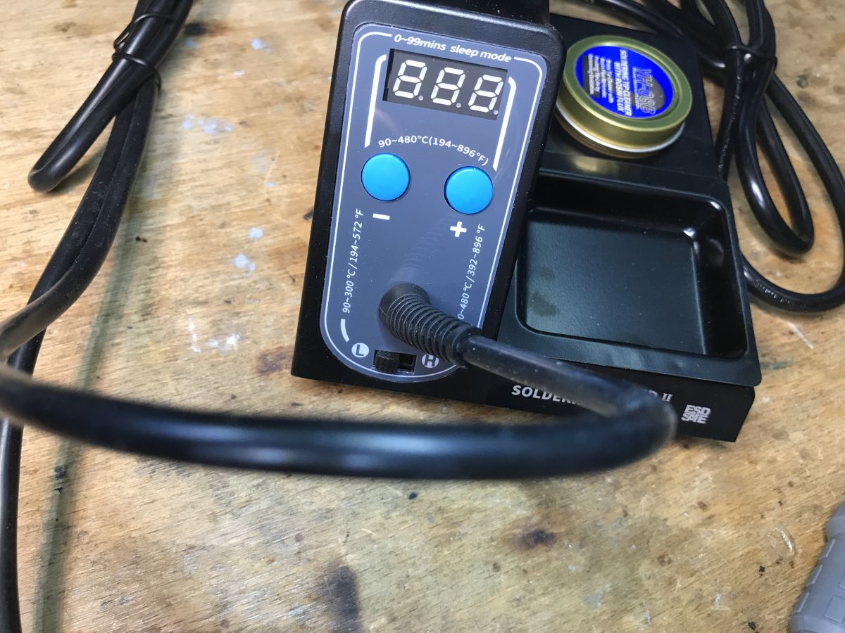

    The display is a classic 7-segment LED, of course it is readable, and there is also a switch for two temperature modes (see photo):
    YIHUA 926 LED II 120W soldering station with LED display. YIHUA 926 LED II soldering station with a 7-segment display and temperature control. YIHUA 926 LED II 120W soldering station on a workbench

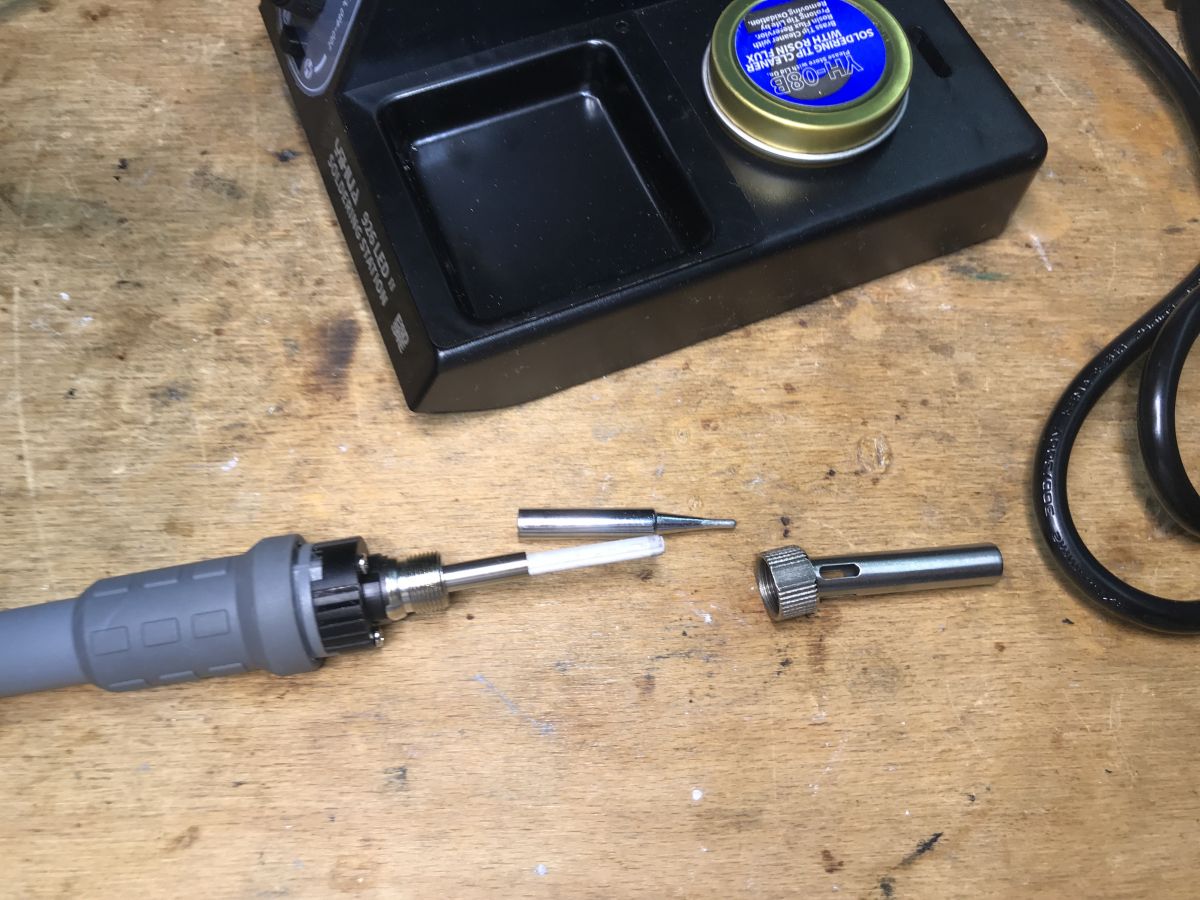

    Replacing tips:
    Soldering tip replacement for YIHUA 926 LED II 120W on a workbench
    900M tips fit here, the same ones used in the cheapest soldering irons from China.

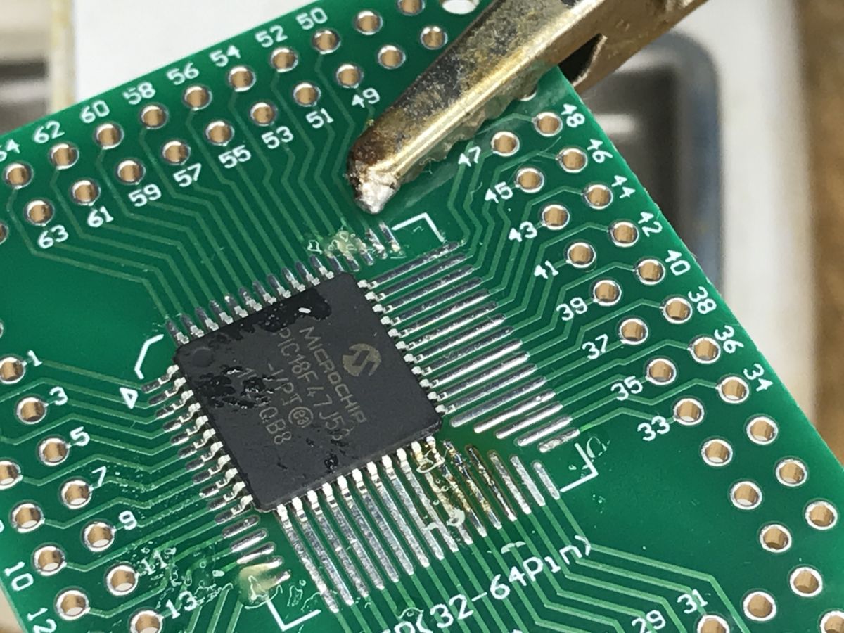

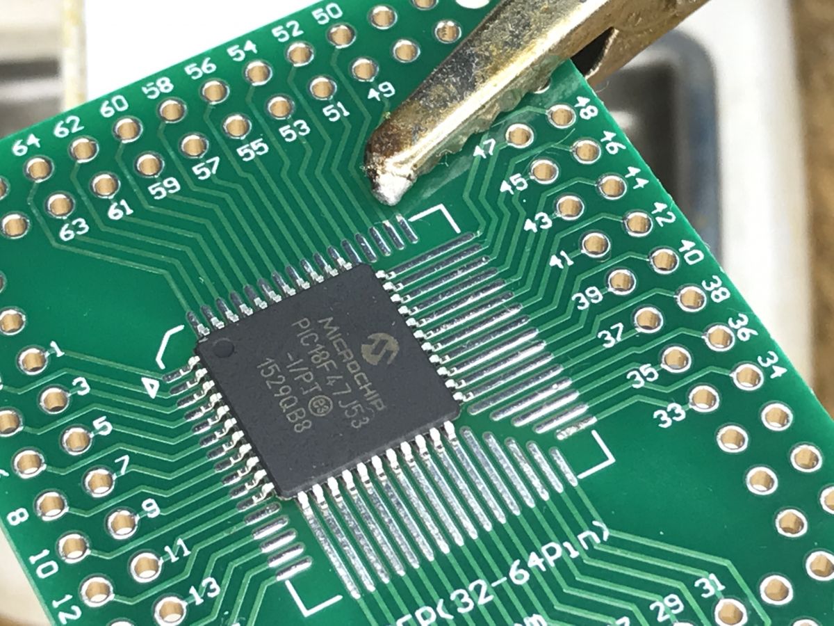

    TQFP soldering
    I solder TQFP with a regular tip, although a mini-wave tip would probably be better. My soldering method is "on foot", I grab one and the other corner of the system and then I try to solder the remaining legs using the "drag soldering" method. Dragging the tip over the legs of the system spreads the binder, and I can remove the excess with a braided line.
    I know there are other, perhaps better, methods, but when soldering on such a small scale as I do, I didn`t need to try them.
    On-site layout:
    Printed circuit board with a TQFP chip secured by a clip.
    Caught legs:
    Close-up of a TQFP integrated circuit soldered onto a PCB.
    A little fun (it`s a bit hard for me to solder with a big tripod and a phone in front of me) and then soldering a few legs, you can see how the binder melts and catches:
    Here the soldering is shown a little better, you can see how the filler "goes" along the legs to the corner behind the tip, and then I remove its excess with a braid:

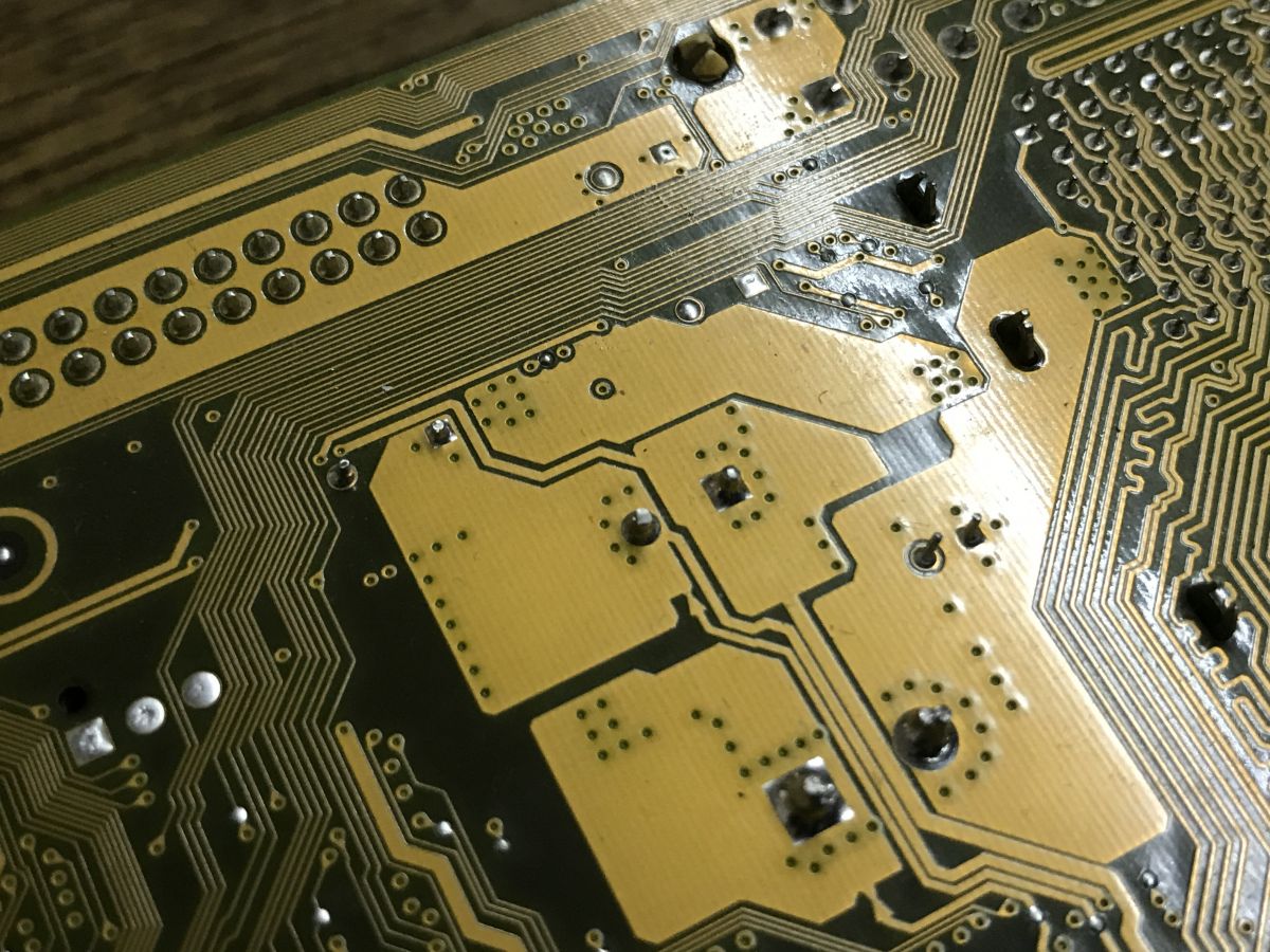

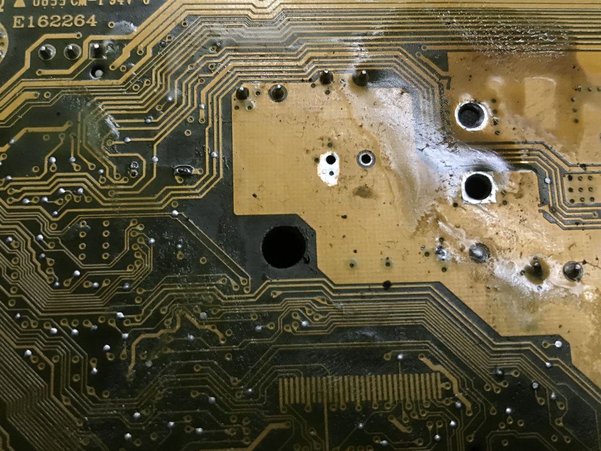

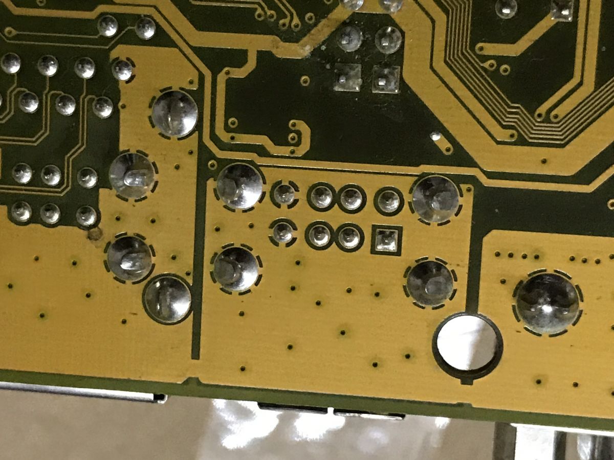

    Output from the motherboard
    The covered desoldering method is:
    1. applying flux to February
    2. adding lead binder to mix with the solders
    3. heating

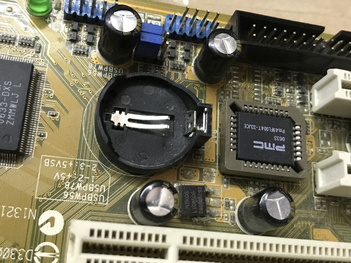

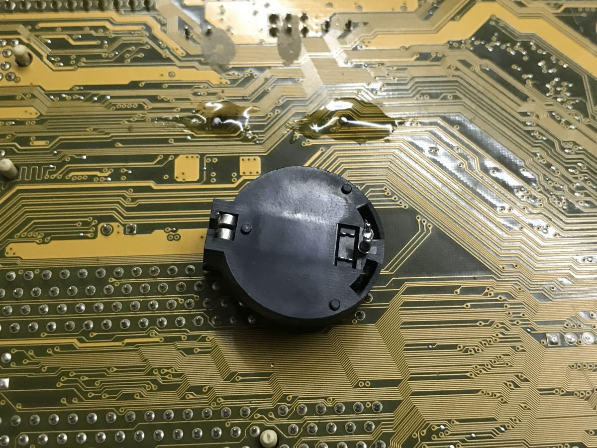

    First, maybe something simple - a battery basket:
    Close-up of a circuit board showing traces and holes. Close-up of a computer motherboard with a battery socket and components. Battery holder on a PCB.

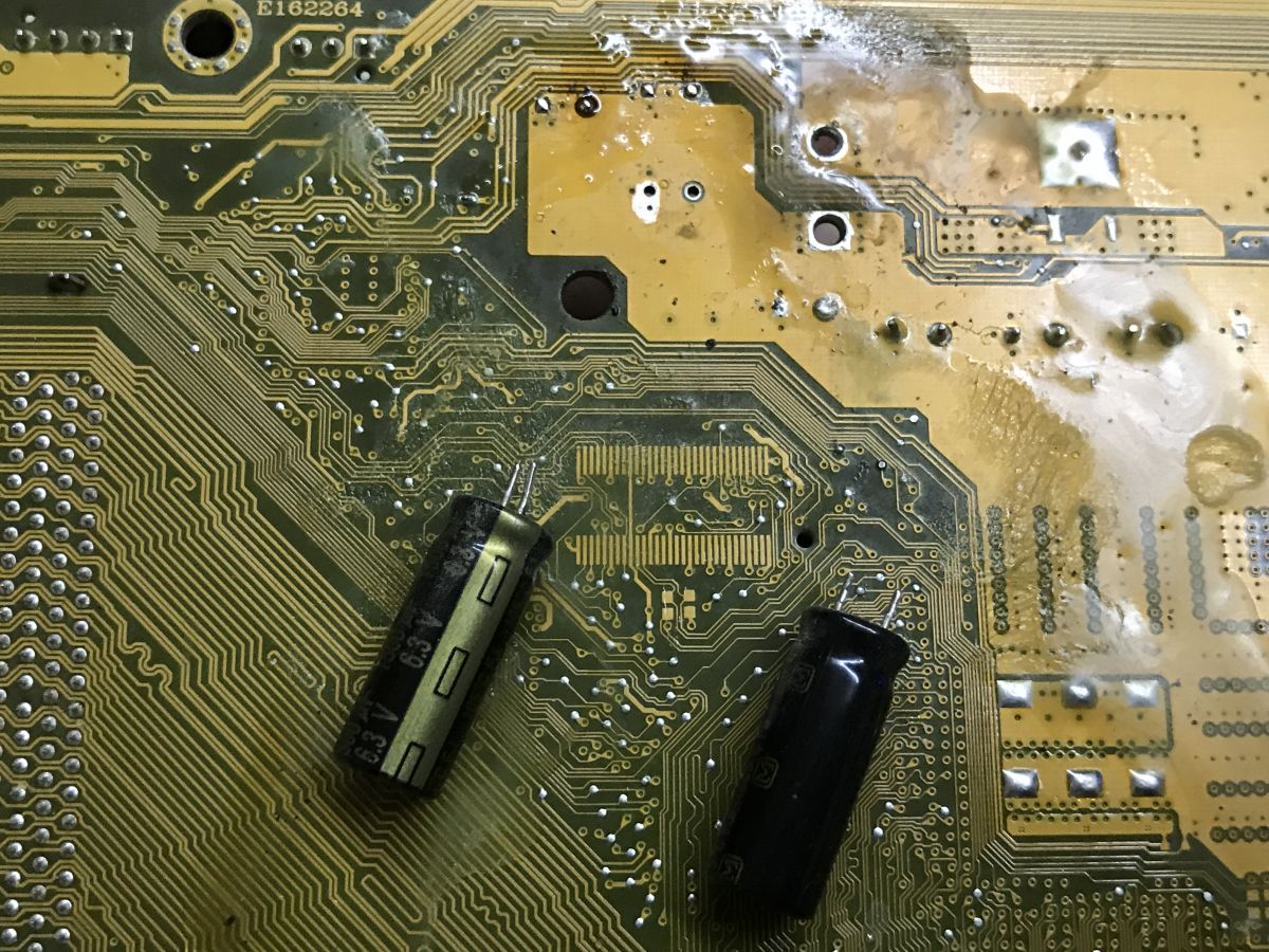

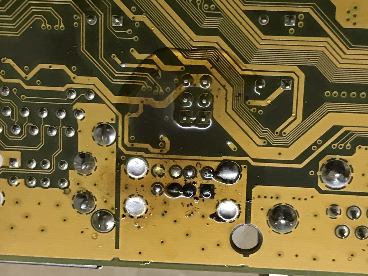

    Now for something more difficult, capacitors, and those on the large ground spout that act as a heat sink. I set the temperature to 450°C, out of curiosity to see how well it would work:
    Close-up of a computer motherboard with visible traces and holes. Motherboard with visible traces and desoldered capacitors
    There was no problem - I also cleaned the holes:
    Close-up of a motherboard with visible traces and soldering holes.

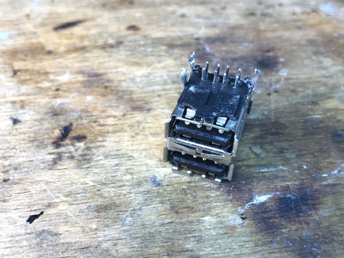

    Outlet from the motherboard 2 - USB connector
    Maybe it`s something even more difficult. Let`s desolder these characteristic double/triple USB connectors. Here are his legs:
    Image of a circuit board with soldered components.
    Added lead binder:
    Close-up of a circuit board with soldered pins and traces.
    A moment of heating...
    Close-up of a circuit board with visible traces and soldering points.
    With a little help the connector comes out of the board:
    Dual USB connector on a wooden background.

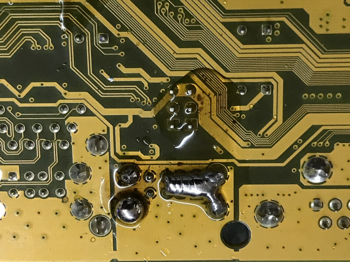

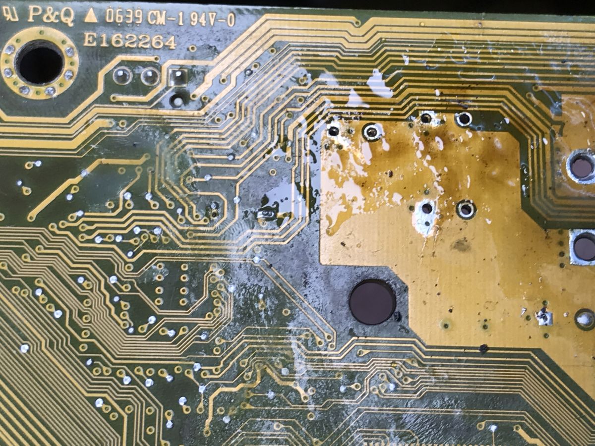

    Now it`s time to clean the holes with braid : :
    It heats beautifully, after a while of heating the binder flows out of the holes into the braid, very satisfying.

    It`s different when we want to desolder - outlet from the computer`s motherboard YIHUA 926 LED II 120W it`s pure pleasure. Cleaning the holes is the same. The binder goes right into the braid. I have the impression that maybe I set the temperature too high, but I wanted to see what this small soldering iron can do. Another thing is that I could have used a better flux... but the soldering was successful, capacitors in old computers can be replaced, and so can the connectors.
