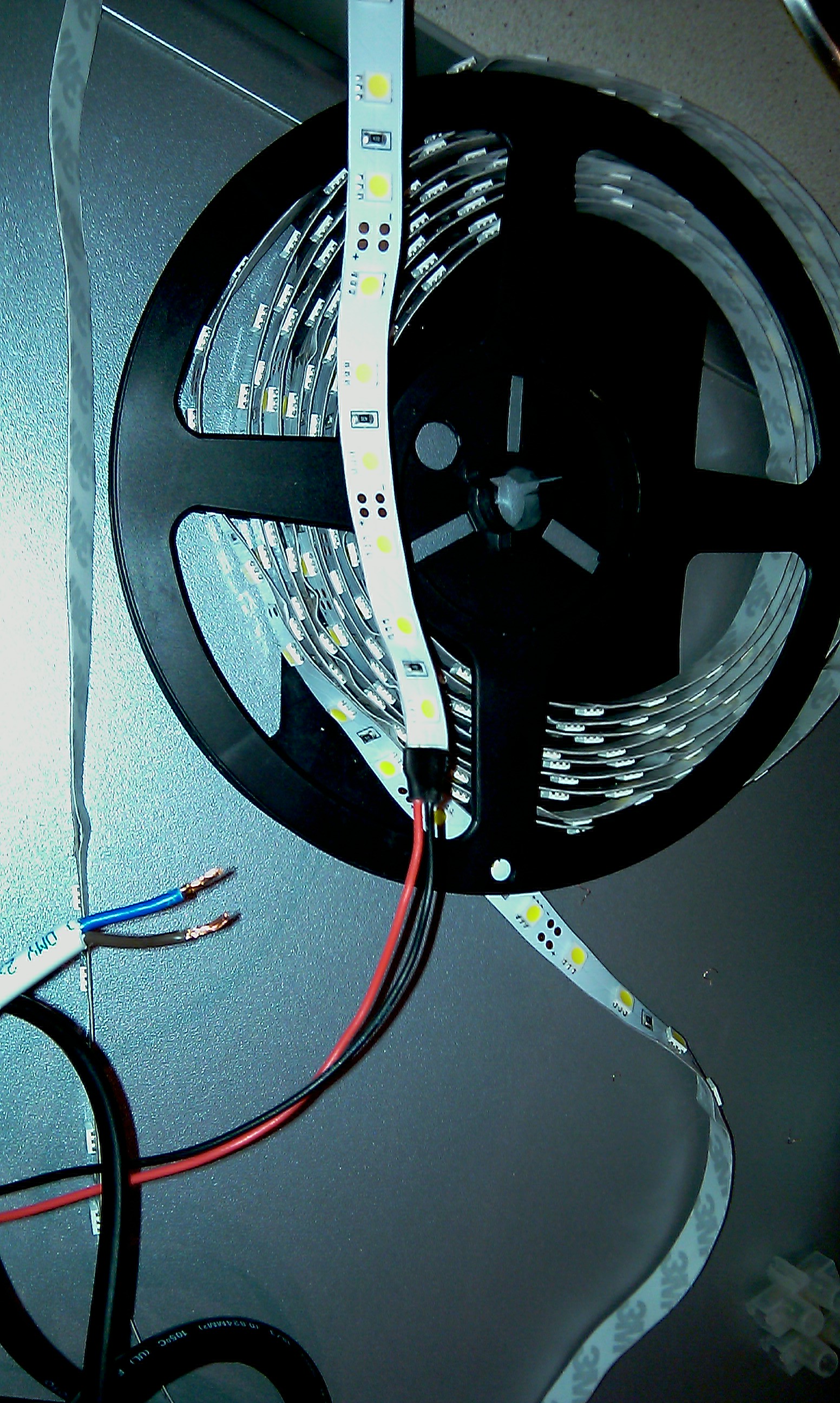

    This is my first post. I’m not an electrician or an electronics engineer, but I’m not a complete idiot either, so feel free to explain things to me in reasonably technical terms. I’m installing components of the Moeller X-Comfort home control system in my new flat. For now, I’m testing the components in my current flat, and everything was working fine until I got round to the LED issue.
    The idea is this: I want the sensor (X-Comfort) to pick up a signal, send it to the receiver (X-Comfort), which then sends a control signal to switch on the transformer powering the LED strip, thereby brightening or dimming it. The system works very well with standard incandescent or halogen bulbs
    Problem No. 1: I used an EMC YT 210 transformer (yes, I know LEDs should be powered by DC, but this one outputs AC); I connected the X-Comfort control unit in front of the transformer. Everything worked brilliantly, except that I broke a basic rule, which risked damaging the LEDs; on top of that, the EMC YT 210 was getting incredibly hot.
    Could you please advise on what to do to make this solution work properly – in other words, to avoid damaging the LEDs and prevent the transformer from burning out?

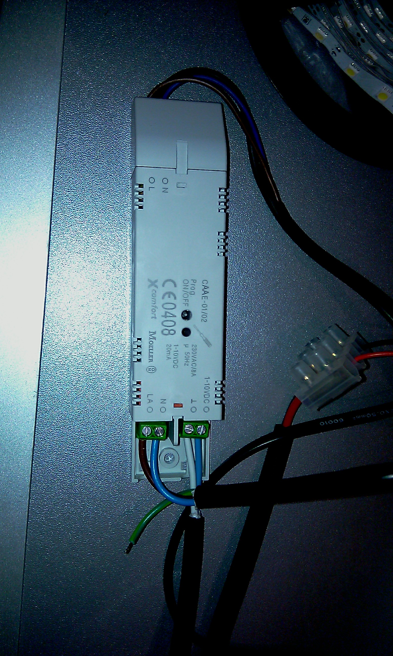

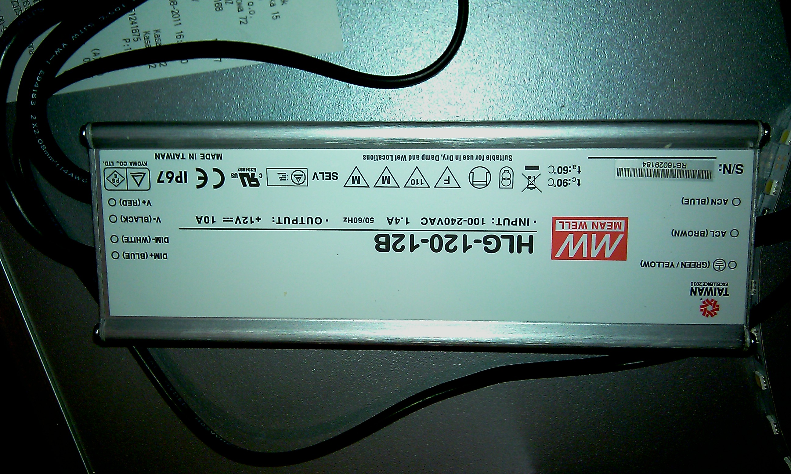

    Problem No. 2 (with illustrations). I contacted the LED supplier and x-comfort and established that the correct transformer for the LEDs must be used to avoid damaging them. The team at x-comfort informed me that I should purchase a transformer with an additional 1–10V control, and to replace the dimming receiver used above with a special receiver featuring a 220V input, the same output to the transformer, and additionally a DIM+ and DIM– 1–10V 20mA input. I went ahead and bought one, spending a fortune on the power supply (Mean Well HLG-120-12B) as shown in the photo. I hooked it all up nicely and was absolutely astonished… Admittedly, the power supply stays nice and cool, but:
    1. The LEDs seem to be brighter and are getting warm (sic!) – a 5m-long 5050 LED strip rated at 14.4 W per metre.
    2. The X-Comfort switches the system on and off, but refuses to dim it. In fact, it dims by about 20–30 per cent and then switches off, whereas it should be able to dim from 0–100 per cent and then switch off only after going from 100 per cent back to 0.
    What should I do????
    Please explain it in simple terms
    Paradoxically, solution no. 1 – which seemed unacceptable – would actually work brilliantly. And solution no. 2 has cost me money, and now I’ll have to sell Mean Well power supplies on Allegro :(
    HELP......

    Well, unfortunately, this HLG costs 240 gross :( It’s a bit of a gamble, but I bought it because I was expecting a double LED strip, i.e. 120 WATT. Maybe I’ll be able to return it to the seller, as the power supply is only two days old and one of them hasn’t even been taken out of the box. After all, I’m entitled to a refund. As for the controls, the idea is that the system can be controlled using remote controls and a central unit – and eventually via a computer as well. It’s also programmed wirelessly via a computer, so the system itself is pretty cool. For now, the only problem is with the LEDs. The system also includes roller blinds and heating control. You can even connect energy consumption meters to individual phases and monitor consumption by specific appliances or parts of the house via the central unit. You can then download this data to your computer or simply read it on the central unit’s display.
    Added after 3 [hours] 50 [minutes]:
    I’ve finally brought my multimeter back from the building site. My understanding of solution no. 2, described in the first post, has deepened considerably. I measured the current at the 1–10 V output of the X-Comfort actuator and found that, when the dimming function is activated, the current smoothly decreases from 10 V to 1 V and vice versa. I repeated the same procedure on the power supply’s output, and here the situation is completely different: for the first 3 seconds, whilst the actuator drops from 10 V to, say, 7 V, the power supply’s output remains at 12 V the whole time; then a slow drop begins, but when the actuator reaches 1V and there is a click indicating it has switched off completely, the power supply output is around 5V. Perhaps this will give you some ideas on what to do about this issue :)
