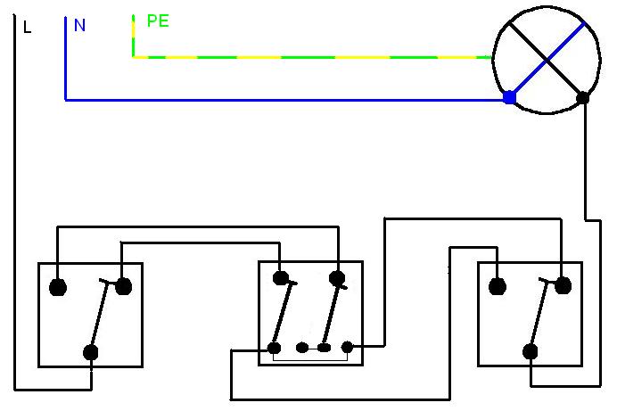

  • #7 14056528
    krajczak
    In this case, do we connect the cross as in this diagram or something else, due to the fact that it is at the input ??
