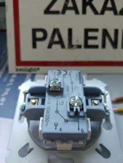

    Thank you for the answers, I did not add that this external lamp is already connected, the problem is to connect the second step switch under the flap No. 1, basically I connected them so that I switched on and off with this double switch, and put out the already burning light a single staircase, but when the double switch is turned off (light off) and I want to light a single one, the light dims and blinks
    I guess I was wrong on a double stair, because I have two single stair connectors and everything works
    When I'm at home, I'll throw in a photo of the connector, maybe something will clear up
    Connecting Double & Single Staircase Switches: Corridor & Outdoor Lighting Solution
    I connected it so it did not work
    green lines are the wires of the lamp outside (it works ok)
    and this is how a double connector looks like

    Hello. Try to connect as shown in the diagram in the picture. The second lamp works rather by accident. Greetings.

    In the double switch, try to replace the black wires with the red ones coming from the top, the red ones instead of black and the black instead of the red ones. Leave the green lines.

    You have incorrectly connected the power cord
    I have modeled myself on the drawing above so and not the other colors of the lines.

    edit: The diagram above helped connect, thanks

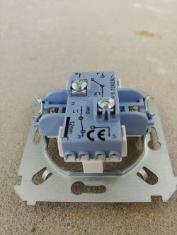

    Hello, a similar situation.
    Two rooms, one double staircase connector.
    Pom. 1 Stair - Crisscross - Stern double
    Pom. 2 Stair - Stern double
    I've been working for a while now. 1. and I can not get through this double. I will add that connecting a single everything works.
    I attach a picture of the connector. The cables have 3 - power supply and two of cross.
    Help!
  • #10 17363520
    Brivido
    Posts: 2859
    Help: 226
    Rate: 430
    Show the photo of this can.

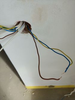

    Uuu, picture of cans tomorrow at the earliest. But it will show several yidd 3x1,5 from pom.2, with which I have not yet moved and one yidd 3x1,5 from pom.1, i.e. stairs.
    And in it: Brown - power supply (connected by a quick connection from the power cable under the cross and, blue and yellow - green - connected with a cross connector.
    (I'll add a picture tomorrow)
    Added after 12 [hours] 50 [minutes]:
    In the can on the left the cables from the second room, ultimately to the second key.
    On the right a stair cable, which I want to attach to a double stair. X configuration and still a bad final result ..

    OK, one of the forum users made me aware of where "L1" and "L2" are
    For future self-taught persons - these are the two clamps on the "back".
