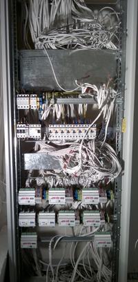

    Centralise the system into a single cabinet. Avoid long RS485 buses (max. 400 m, e.g. for the Nexo system). Components ‘connected’ to the bus must be wired using shielded cable. For protection, it is best to use residual current devices (RCDs) with an overcurrent protection element upstream of the actuator modules; the protection rating should be selected to match the loads and cable cross-sections – in other words, it is best to divide this into several B10 protection devices, and ideally they should be on the same phase.
    The photo shown is of a 0.75 / 2m high cabinet for one floor of a building (3 bedrooms, 2 bathrooms, a fitness room, 3 walk-in wardrobes) with space for LAN and satellite TV. It’s worth oversizing the cabinet, as it can become a problem later on.
    Regards
    Not yet finished:
    Where should the RS485-controlled cabinets be located – in a central cabinet or in individual room c
