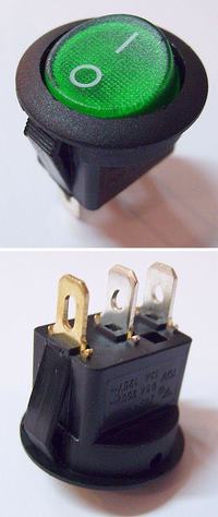

    I have the following problem - I install mirror heating in my car and I want to be able to turn them on independently.
    A trivial matter, isn't it? :) Well, the switch I have is something like this:
    Connecting an Illuminated Switch for Independent Car Mirror Heating: A Step-by-Step Guide
    Not exactly this one, but it looks the same (only connection descriptions are missing).
    And now like this: when I do not connect, when the switch is on, I have 0.5 V on the receiver, while when I click and the backlight goes out, I have 12V on the receiver (this is how it should be) ...
    How is it damn connected so that it shines when turned on?

    If your switch has three legs, in such a system, if you connect only two, it will work, unfortunately :D
    In order for it to shine, the light source must receive both the plus and minus that it gets through the load. If you close the switch with full current to the load, you are shorting the ends of the light source.
    But it can be arranged otherwise :D - if the light source is connected between the center and ground:

    Experiment with a resistor between ground and switch. First, let's say 1k?. Then you will choose the right one according to him. Of course, I assume that you have an LED in the switch, because if it is an invention with a light bulb, the resistor must be more powerful than the diode and a lot less resistance.

    Thank you for your answer. :D I think there is a diode inside, because the switch itself is small.
    Only the one in the picture is 250V and mine is 12V.
    I still have questions how to fix such a resistor in the installation so that it does not detach or crumble, in the car it is known that it shakes a bit, especially on our roads. I do not know if there are any special housings or sockets for such a resistor?

    Solder into the cut wire and protect it with a heat shrink tubing (2 layers can be used) overlapping 20mm on the wire insulation on each side.

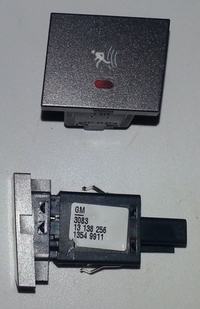

    Hello, please help.
    Here is my Vectra C alarm switch.
    I would like to be able to turn on / off the wired bluetooth kit with it.
    In fact, I have two, one is originally mounted in the board and works with an alarm, and the other I wanted to use as a bluetooth power switch in a separate installation.
    My question is whether this switch is good for this.
    The original alarm switch works with the alarm and blinks slow / fast depending on the arming of the alarm.
    I want to use the second such switch for aesthetics.
    I would not like to push some ordinary switch with backlight into the board - this is the final version.
    Is it possible to connect it so that it shines after turning on the powered bluetooth kit (I understand that it will not blink because the alarm itself gives it a signal and therefore it blinks).
    Thank you

    this is what the contacts look like
    one button is already at the top, there is free space at the bottom after removing the cover
    and this is what the ALARM button looks like after removing the front, there are two LEDs, I don't know why, only the one underneath works for me - red
    (maybe in the richer version, the second yellow LED is for something)

Will the added resistor overheat inside a dashboard?
At 12 V and 5 mA, a 1 kΩ resistor dissipates 0.06 W—well below a 0.25 W rating. It stays under 40 °C in 25 °C ambient [Carling, Datasheet]. Heat-shrink sleeving prevents vibration damage [Elektroda, jdubowski, post #10081392]
What’s the secure way to mount that resistor in a car?
Solder it inline on the switch’s ground wire, cover joints with two layers of overlapping heat-shrink, each extending 20 mm onto insulation. This meets IP-54 splash standards [TE Connectivity, 2020; Elektroda, jdubowski, #10081392].
How do I make the rocker lamp glow all the time, regardless of switch state?
Place the switch in the ground leg of the relay coil. Feed the lamp permanently from dashboard-light +12 V and chassis ground. Some shorting-type switches cannot do this; choose a model with independent lamp pins [Elektroda, jdubowski, post #10654377]
Can a 12 V car switch be used on 230 V mains?
No. Its 60 V insulation rating fails at 230 V. Breakdown can cause shock or fire—an edge-case that has destroyed power strips [Elektroda, jdubowski, post #15980468] Use a 250 V-rated switch with a neon indicator instead [Marquardt, Datasheet].
Why does a 230 V neon switch glow when OFF and go dark when ON?
The neon is wired in parallel with the contacts. When OFF, mains flows through the lamp’s 150 kΩ resistor (≈0.3 mA), so it glows. ON position shorts the lamp, extinguishing it [Elektroda, jdubowski, post #15981211]
How do I rewire a power strip so the neon lights only when ON?
Swap the incoming live wire with the outgoing socket live at the switch. Now the neon sits on the supply side and energises only when current flows to the sockets [Elektroda, jdubowski, post #10318880]
Is the factory Opel Vectra alarm switch suitable for Bluetooth power control?
Possible if contacts are bistable and rated ≥2 A at 12 V. Verify pin-out; many OEM alarm buttons share LED control lines with the body module, so independent reuse may need extra wiring or a driver transistor [Elektroda, jdubowski, post #12481469]
