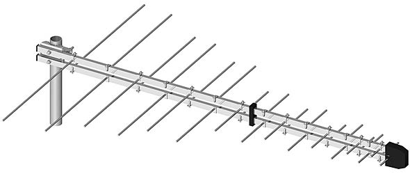

    I have a logarithmic-periodic antenna (about 7 years old, sample photo)
    Signal Strength 100%, Quality 0%: Logarithmic-Periodic Antenna Set-Up for DVB-T & Analog Channels
    And I'm trying to set it to be able to receive 1,2,3regionalna channels, Polsat (analog) and DVB-T channels from mux2 (Tarnow or Krakow, I live near Brzesko) on a new TV. And here there is a problem, in the optimal setting the signal strength shown by the TV (LG LV570S) is 100%, while the quality is 0% for digital channels and of course the receiver does not find them. After manually setting the analog channels, they are unstable (i.e. picture seems perfect but flickering all the time and no sound)
    I would like to ask for help, what is wrong ...

    The antenna has a can with an amplifier, there is no information about the type, etc. (it only writes turbo), of course I bought two other amplifiers (some Philips and SWA-9) but the effect is exactly the same:
    with the power supply connected to the amplifier, as I wrote, the channels flicker (but they are perfect) and after removing the power supply from the socket, it only catches TVP 1 and 2 very poorly).

    Remember that this antenna requires a dedicated amplifier with unbalanced input. The use of the SWA9 amplifier is a mistake, it is an amplifier for symmetrical antennas.
    Anyway, in Brzesko the amplifier is completely unnecessary.

    If there is an unsuitable preamplifier there (as noted by Irekr), it is obligatory to remove what is there only harmful.
    Either connect the antenna without a preamplifier or buy a suitable one (eg LG-1).

    As I know these antennas, it does not go too much to connect another amplifier because the screw spacing does not match, this antenna has a much wider spacing and you would have to combine quite a lot to attach another.

    What are you talking about? If it's the antenna in the photo, they are for it dedicated preamplifiers fit perfectly.
