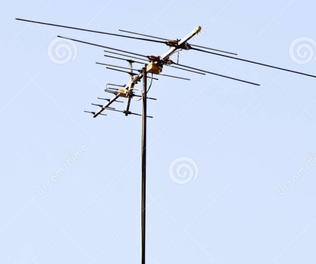

    I was on the roof a moment ago, I connected the cable to another old type antenna (as shown in the picture) great reception, but the problem did not disappear on the MUX-3, the same no signal, black image every 5 seconds. Strange TV Behavior: No TVP1, TVP2 Signal on DVB-T Receiver - Roof Antenna, 15m Cable Issues?
