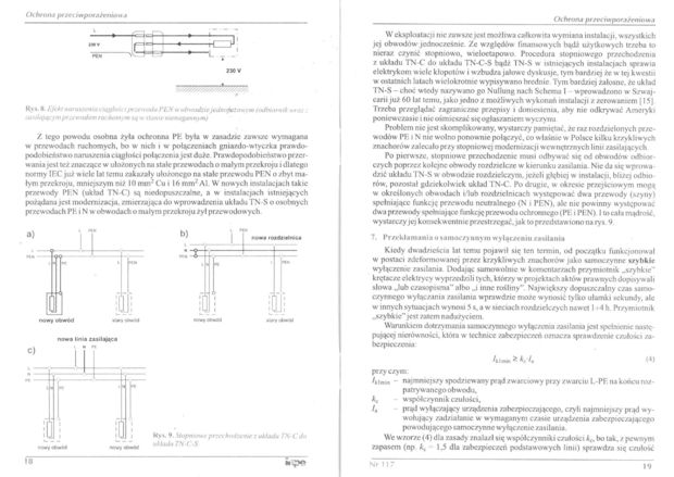

    Where to connect the protective conductor to the holder (luminaires in protection class II) has already been explained many times and ad nauseam.
    And new circuits should be made like this.
